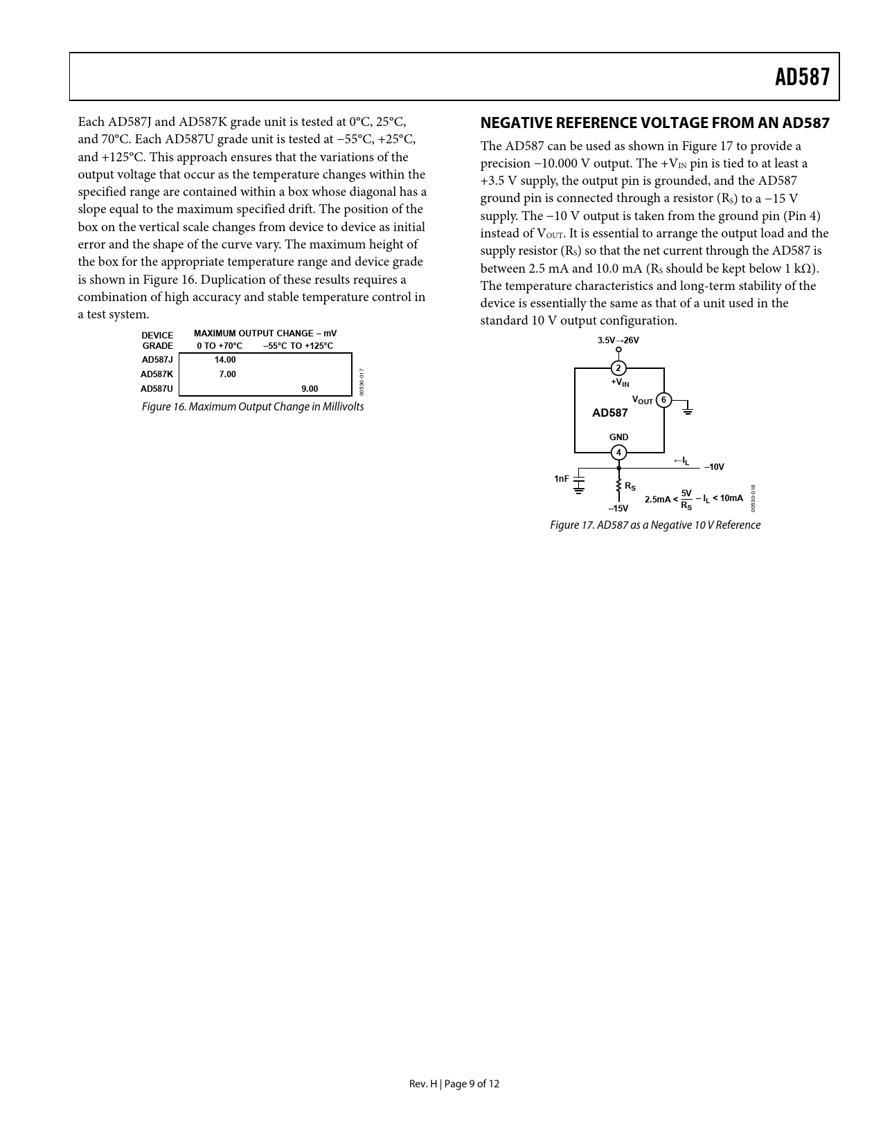

Each AD587J and AD587K grade unit is tested at 0°C, 25°C,
NEGATIVE REFERENCE VOLTAGE FROM AN AD587
and 70°C. Each AD587U grade unit is tested at −55°C, +25°C, The AD587 can be used as shown in Figure 17 to provide a and +125°C. This approach ensures that the variations of the precision −10.000 V output. The +VIN pin is tied to at least a output voltage that occur as the temperature changes within the +3.5 V supply, the output pin is grounded, and the AD587 specified range are contained within a box whose diagonal has a ground pin is connected through a resistor (RS) to a −15 V slope equal to the maximum specified drift. The position of the supply. The −10 V output is taken from the ground pin (Pin 4) box on the vertical scale changes from device to device as initial instead of VOUT. It is essential to arrange the output load and the error and the shape of the curve vary. The maximum height of supply resistor (RS) so that the net current through the AD587 is the box for the appropriate temperature range and device grade between 2.5 mA and 10.0 mA (RS should be kept below 1 kΩ). is shown in Figure 16. Duplication of these results requires a The temperature characteristics and long-term stability of the combination of high accuracy and stable temperature control in device is essentially the same as that of a unit used in the a test system. standard 10 V output configuration.

Figure 16. Maximum Output Change in Millivolts
AD587 GND 4 ←IL –10V 1nF RS

2.5mA < – IL < 10mA
0-
–15V RS
53 00 Figure 17. AD587 as a Negative 10 V Reference Rev. H | Page 9 of 12 Document Outline FEATURES FUNCTIONAL BLOCK DIAGRAM GENERAL DESCRIPTION PRODUCT HIGHLIGHTS TABLE OF CONTENTS REVISION HISTORY SPECIFICATIONS ABSOLUTE MAXIMUM RATINGS ESD CAUTION PIN CONFIGURATION AND FUNCTION DESCRIPTIONS THEORY OF OPERATION APPLYING THE AD587 NOISE PERFORMANCE AND REDUCTION TURN-ON TIME DYNAMIC PERFORMANCE LOAD REGULATION TEMPERATURE PERFORMANCE NEGATIVE REFERENCE VOLTAGE FROM AN AD587 APPLICATIONS INFORMATION USING THE AD587 WITH CONVERTERS 10 V Reference with Multiplying CMOS DACs or ADCs Precision Current Source Precision High Current Supply OUTLINE DIMENSIONS ORDERING GUIDE
