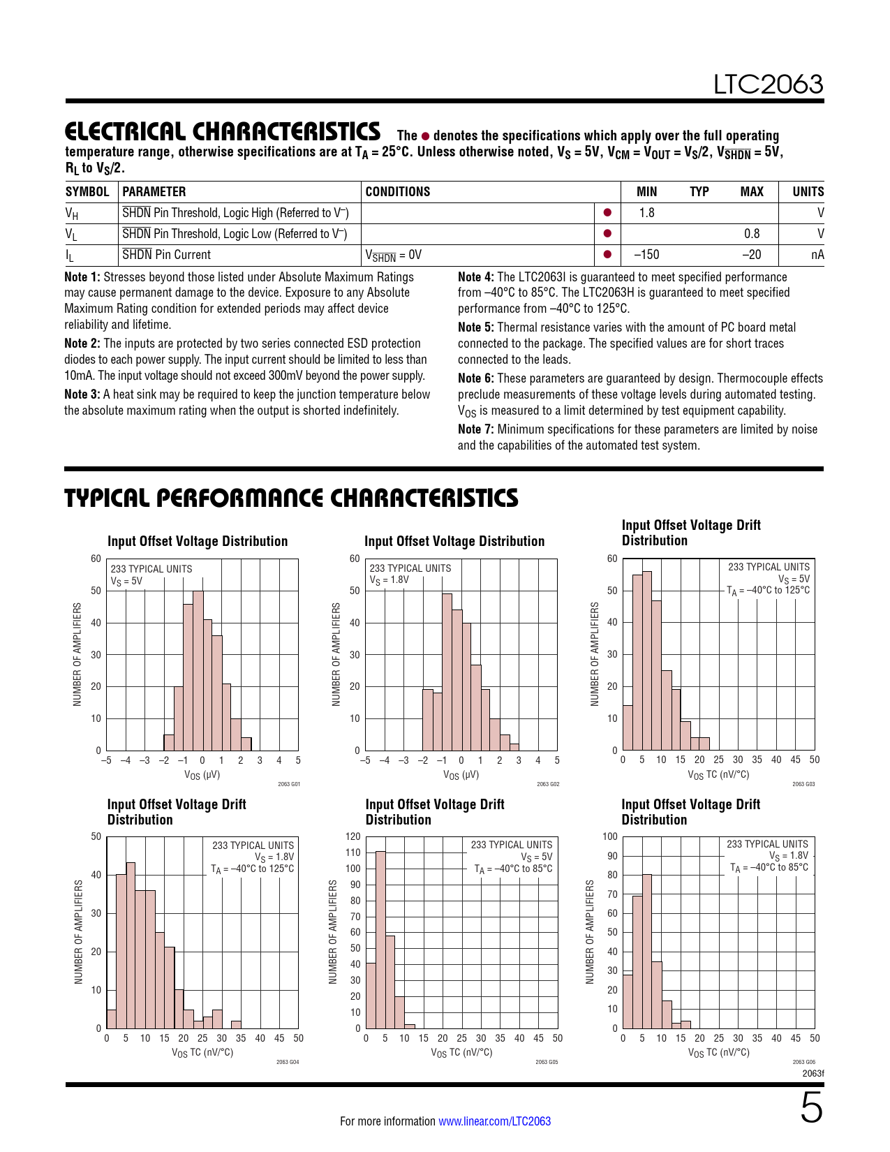

denotes the specifications which apply over the full operating temperature range, otherwise specifications are at TA = 25°C. Unless otherwise noted, VS = 5V, VCM = VOUT = VS/2, VSHDN = 5V, RL to VS/2. SYMBOL PARAMETER CONDITIONS MIN TYP MAX UNITS
VH SHDN Pin Threshold, Logic High (Referred to V–) l 1.8 V VL SHDN Pin Threshold, Logic Low (Referred to V–) l 0.8 V IL SHDN Pin Current VSHDN = 0V l –150 –20 nA
Note 1:
Note 4:
The LTC2063I is guaranteed to meet specified performance may cause permanent damage to the device. Exposure to any Absolute from –40°C to 85°C. The LTC2063H is guaranteed to meet specified Maximum Rating condition for extended periods may affect device performance from –40°C to 125°C. reliability and lifetime.

The inputs are protected by two series connected ESD protection connected to the package. The specified values are for short traces diodes to each power supply. The input current should be limited to less than connected to the leads. 10mA. The input voltage should not exceed 300mV beyond the power supply.

These parameters are guaranteed by design. Thermocouple effects

A heat sink may be required to keep the junction temperature below preclude measurements of these voltage levels during automated testing. the absolute maximum rating when the output is shorted indefinitely. VOS is measured to a limit determined by test equipment capability.

Minimum specifications for these parameters are limited by noise and the capabilities of the automated test system.
Typical perForMance characTerisTics Input Offset Voltage Drift Input Offset Voltage Distribution Input Offset Voltage Distribution Distribution
60 60 60 233 TYPICAL UNITS 233 TYPICAL UNITS 233 TYPICAL UNITS VS = 5V VS = 1.8V VS = 5V 50 50 50 TA = –40°C to 125°C 40 40 40 30 30 30 20 20 20 NUMBER OF AMPLIFIERS NUMBER OF AMPLIFIERS NUMBER OF AMPLIFIERS 10 10 10 0 0 0 –5 –4 –3 –2 –1 0 1 2 3 4 5 –5 –4 –3 –2 –1 0 1 2 3 4 5 0 5 10 15 20 25 30 35 40 45 50 VOS (µV) VOS (µV) VOS TC (nV/°C) 2063 G01 2063 G02 2063 G03

50 120 100 233 TYPICAL UNITS 233 TYPICAL UNITS 233 TYPICAL UNITS V 110 S = 1.8V VS = 5V 90 VS = 1.8V TA = –40°C to 125°C 100 T T 40 A = –40°C to 85°C A = –40°C to 85°C 80 90 70 80 30 70 60 60 50 20 50 40 40 30 NUMBER OF AMPLIFIERS NUMBER OF AMPLIFIERS 30 NUMBER OF AMPLIFIERS 10 20 20 10 10 0 0 0 0 5 10 15 20 25 30 35 40 45 50 0 5 10 15 20 25 30 35 40 45 50 0 5 10 15 20 25 30 35 40 45 50 VOS TC (nV/°C) VOS TC (nV/°C) VOS TC (nV/°C) 2063 G04 2063 G05 2063 G06 2063f For more information www.linear.com/LTC2063 5 Document Outline Features Applications Typical Application Description Absolute Maximum Ratings Pin Configuration Order Information Electrical Characteristics Typical Performance Characteristics Pin Functions Block Diagram Typical Applications Typical Application Related Parts
