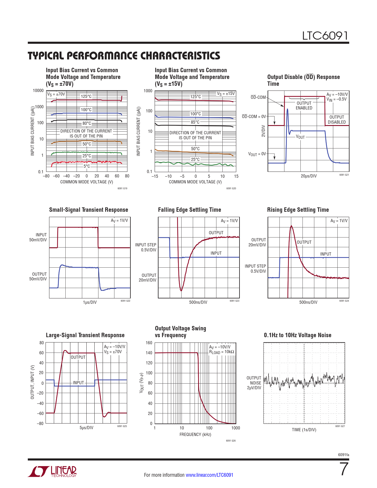

TYPICAL PERFORMANCE CHARACTERISTICS. Input Bias Current vs Common. Mode Voltage and Temperature. Output Disable (OD) Response
TYPICAL PERFORMANCE CHARACTERISTICS Input Bias Current vs Common Mode Voltage and Temperature Output Disable (OD) Response
LTC6091
TYPICAL PERFORMANCE CHARACTERISTICS Input Bias Current vs Common Input Bias Current vs Common Mode Voltage and Temperature Mode Voltage and Temperature Output Disable (OD) Response (VS = ±70V) (VS = ±15V) Time
10000 1000 VS = ±70V V 125°C 125°C S = ±15V A OD-COM V = –10V/V VIN = –0.5V OUTPUT 1000 100°C ENABLED 100 100°C OD-COM = 0V OUTPUT 100 80°C 85°C DISABLED DIRECTION OF THE CURRENT 10 DIRECTION OF THE CURRENT IS OUT OF THE PIN 2V/DIV V 10 IS OUT OF THE PIN OUT 50°C 1 50°C INPUT BIAS CURRENT (|pA|) 1 25°C INPUT BIAS CURRENT (|pA|) VOUT = 0V 25°C 5°C 0.1 0.1 –80 –60 –40 –20 0 20 40 60 80 –15 –10 –5 0 5 10 15 6091 G21 20µs/DIV COMMON MODE VOLTAGE (V) COMMON MODE VOLTAGE (V) 6091 G19 6091 G20
Small-Signal Transient Response Falling Edge Settling Time Rising Edge Settling Time
AV = 1V/V AV = 1V/V AV = 1V/V INPUT OUTPUT 50mV/DIV OUTPUT OUTPUT INPUT STEP 20mV/DIV 0.5V/DIV INPUT INPUT INPUT STEP 0.5V/DIV OUTPUT OUTPUT 50mV/DIV 20mV/DIV 6091 G22 1µs/DIV 500ns/DIV 6091 G23 500ns/DIV 6091 G24
Output Voltage Swing Large-Signal Transient Response vs Frequency 0.1Hz to 10Hz Voltage Noise
80 160 AV = –10V/V AV = –10V/V 60 VS = ±70V 140 RLOAD = 10kΩ OUTPUT 40 120 20 ) 100 P-P OUTPUT 0 INPUT (V 80 NOISE 2µV/DIV –20 V OUT 60 OUTPUT, INPUT (V) –40 40 –60 20 –80 0 6091 G25 5µs/DIV 1 10 100 1000 6091 G27 TIME (1s/DIV) FREQUENCY (kHz) 6091 G26 6091fa For more information www.linear.com/LTC6091 7 Document Outline Features Applications Description Typical Application Absolute Maximum Ratings Pin Configuration Order Information Electrical Characteristics Typical Performance Characteristics Pin Functions Block Diagram Applications Information Typical Applications Package Description Typical Application Related Parts
