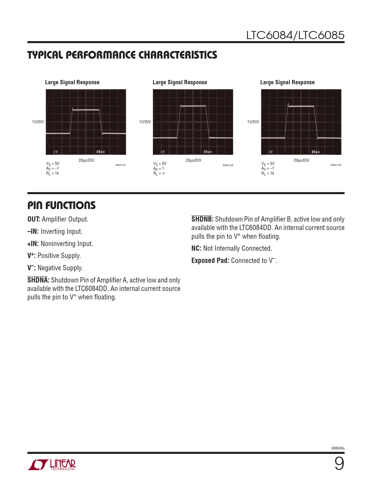

TYPICAL PERFORMANCE CHARACTERISTICS Large Signal Response Large Signal Response Large Signal Response
1V/DIV 1V/DIV 1V/DIV 20μs/DIV 20μs/DIV 20μs/DIV VS = 5V V V 60845 G27 S = 5V 60845 G28 S = 5V 60845 G29 AV = –1 AV = 1 AV = –1 RL = 1k RL = ∞ RL = 1k
PIN FUNCTIONS OUT:
Amplifi er Output.
SHDNB:
Shutdown Pin of Amplifi er B, active low and only available with the LTC6084DD. An internal current source
–IN:
Inverting Input. pulls the pin to V+ when fl oating.
+IN:
Noninverting Input.
NC:
Not Internally Connected.
V+:
Positive Supply.
Exposed Pad:
Connected to V–.
V–:
Negative Supply.
SHDNA:
Shutdown Pin of Amplifi er A, active low and only available with the LTC6084DD. An internal current source pulls the pin to V+ when fl oating. 60845fa 9
