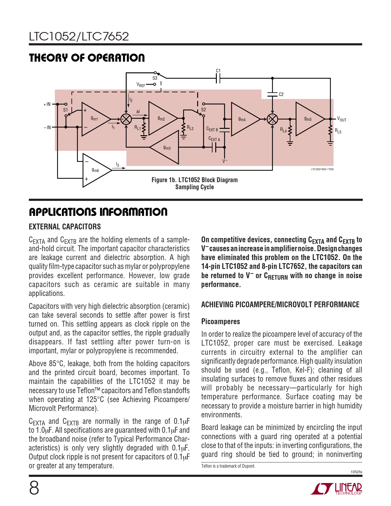

U THEORY OF OPERATIO
C1 S3 VREF C2 l2 + IN S1 + S2 δl – – gm1 + gm2 g + V m4 gm5 – + OUT – IN l – 1 RL1 RL2 CEXT B RL4 RL5 CEXT A gm3 – V– l3 LTC1052/7652 • TO02 gm6 +
Figure 1b. LTC1052 Block Diagram Sampling Cycle U U W U APPLICATIO S I FOR ATIO EXTERNAL CAPACITORS
CEXTA and CEXTB are the holding elements of a sample-
On competitive devices, connecting CEXTA and CEXTB to
and-hold circuit. The important capacitor characteristics
V– causes an increase in amplifier noise. Design changes
are leakage current and dielectric absorption. A high
have eliminated this problem on the LTC1052. On the
quality film-type capacitor such as mylar or polypropylene
14-pin LTC1052 and 8-pin LTC7652, the capacitors can
provides excellent performance. However, low grade
be returned to V– or CRETURN with no change in noise
capacitors such as ceramic are suitable in many
performance.
applications. Capacitors with very high dielectric absorption (ceramic)
