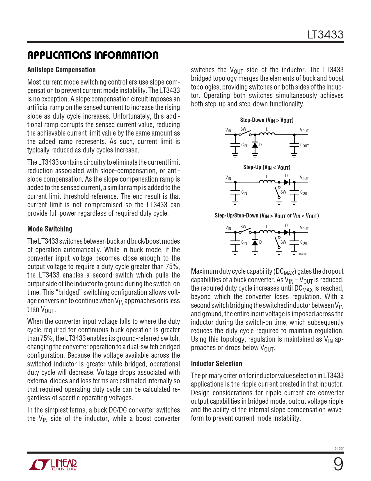

switches the VOUT side of the inductor. The LT3433 bridged topology merges the elements of buck and boost Most current mode switching controllers use slope com- topologies, providing switches on both sides of the induc- pensation to prevent current mode instability. The LT3433 tor. Operating both switches simultaneously achieves is no exception. A slope compensation circuit imposes an both step-up and step-down functionality. artificial ramp on the sensed current to increase the rising slope as duty cycle increases. Unfortunately, this addi-
Step-Down (VIN > VOUT)
tional ramp corrupts the sensed current value, reducing SW L the achievable current limit value by the same amount as VIN VOUT the added ramp represents. As such, current limit is CIN D COUT typically reduced as duty cycles increase. The LT3433 contains circuitry to eliminate the current limit
Step-Up (V
reduction associated with slope-compensation, or anti-
IN < VOUT)
D slope compensation. As the slope compensation ramp is V L IN VOUT added to the sensed current, a similar ramp is added to the C C current limit threshold reference. The end result is that IN SW OUT current limit is not compromised so the LT3433 can provide full power regardless of required duty cycle.
Step-Up/Step-Down (VIN > VOUT or VIN < VOUT) Mode Switching
V SW L D IN VOUT The LT3433 switches between buck and buck/boost modes CIN D SW COUT of operation automatically. While in buck mode, if the 3433 F01 converter input voltage becomes close enough to the output voltage to require a duty cycle greater than 75%, Maximum duty cycle capability (DC the LT3433 enables a second switch which pulls the MAX) gates the dropout capabilities of a buck converter. As V output side of the inductor to ground during the switch-on IN – VOUT is reduced, the required duty cycle increases until DC time. This “bridged” switching configuration allows volt- MAX is reached, beyond which the converter loses regulation. With a age conversion to continue when VIN approaches or is less second switch bridging the switched inductor between V than V IN OUT. and ground, the entire input voltage is imposed across the When the converter input voltage falls to where the duty inductor during the switch-on time, which subsequently cycle required for continuous buck operation is greater reduces the duty cycle required to maintain regulation. than 75%, the LT3433 enables its ground-referred switch, Using this topology, regulation is maintained as VIN ap- changing the converter operation to a dual-switch bridged proaches or drops below VOUT. configuration. Because the voltage available across the switched inductor is greater while bridged, operational
