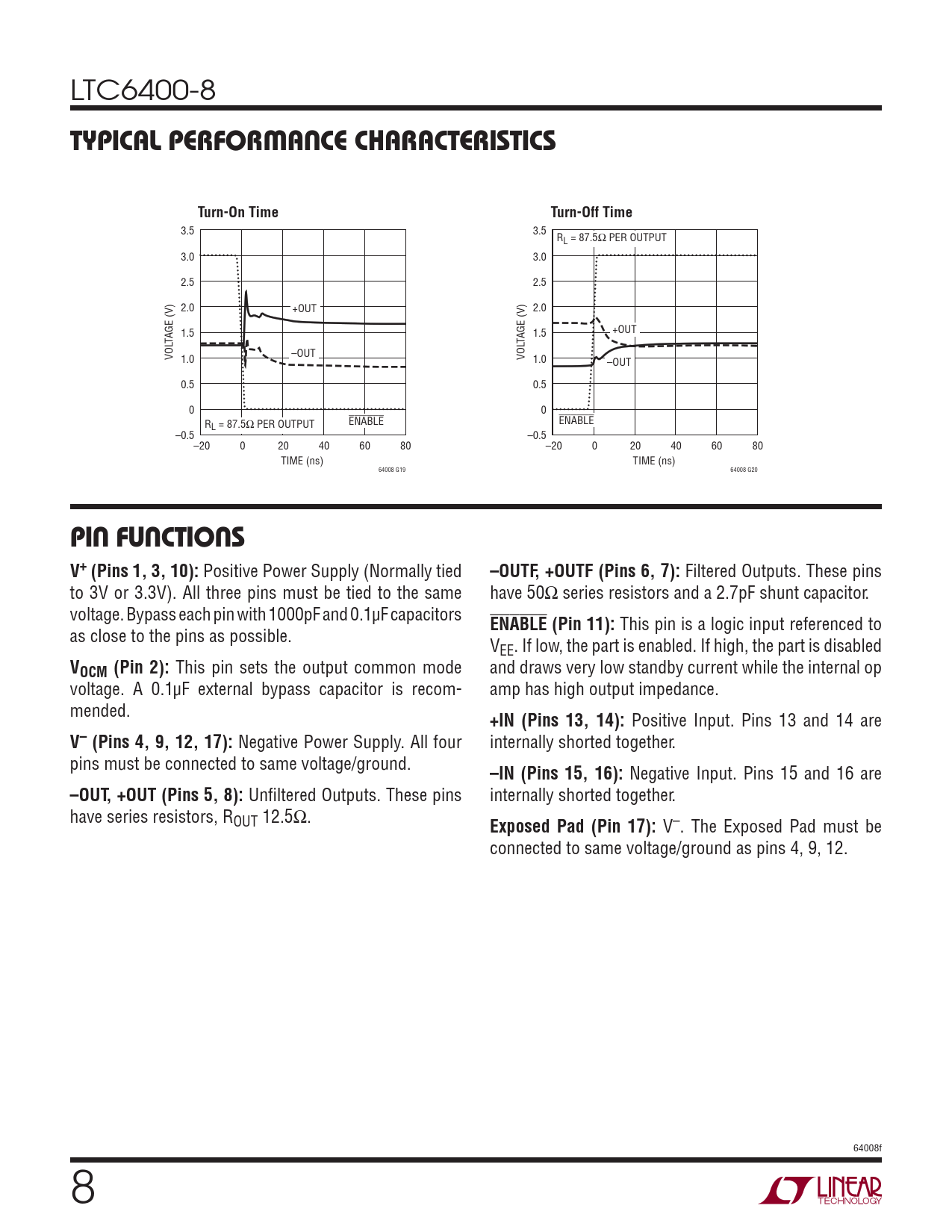

TYPICAL PERFORMANCE CHARACTERISTICS. Turn-On Time. Turn-Off Time. PIN FUNCTIONS V+ (Pins 1, 3, 10):. –OUTF, +OUTF (Pins 6, 7):
TYPICAL PERFORMANCE CHARACTERISTICS Turn-On Time Turn-Off Time PIN FUNCTIONS V+ (Pins 1, 3, 10): –OUTF, +OUTF (Pins 6, 7):
LTC6400-8
3.5 3.5 RL = 87.5Ω PER OUTPUT 3.0 3.0 2.5 2.5 2.0 +OUT 2.0 1.5 1.5 +OUT TAGE (V) TAGE (V) VOL –OUT 1.0 VOL 1.0 –OUT 0.5 0.5 0 0 ENABLE ENABLE RL = 87.5Ω PER OUTPUT –0.5 –0.5 –20 0 20 40 60 80 –20 0 20 40 60 80 TIME (ns) TIME (ns) 64008 G19 64008 G20
Positive Power Supply (Normally tied
Filtered Outputs. These pins to 3V or 3.3V). All three pins must be tied to the same have 50Ω series resistors and a 2.7pF shunt capacitor. voltage. Bypass each pin with 1000pF and 0.1μF capacitors
ENABLE (Pin 11):
This pin is a logic input referenced to as close to the pins as possible. VEE. If low, the part is enabled. If high, the part is disabled
VOCM (Pin 2):
This pin sets the output common mode and draws very low standby current while the internal op voltage. A 0.1μF external bypass capacitor is recom- amp has high output impedance. mended.
+IN (Pins 13, 14):
Positive Input. Pins 13 and 14 are
V– (Pins 4, 9, 12, 17):
Negative Power Supply. All four internally shorted together. pins must be connected to same voltage/ground.
–IN (Pins 15, 16):
Negative Input. Pins 15 and 16 are
–OUT, +OUT (Pins 5, 8):
Unfi ltered Outputs. These pins internally shorted together. have series resistors, ROUT 12.5Ω.
Exposed Pad (Pin 17):
V–. The Exposed Pad must be connected to same voltage/ground as pins 4, 9, 12. 64008f 8
