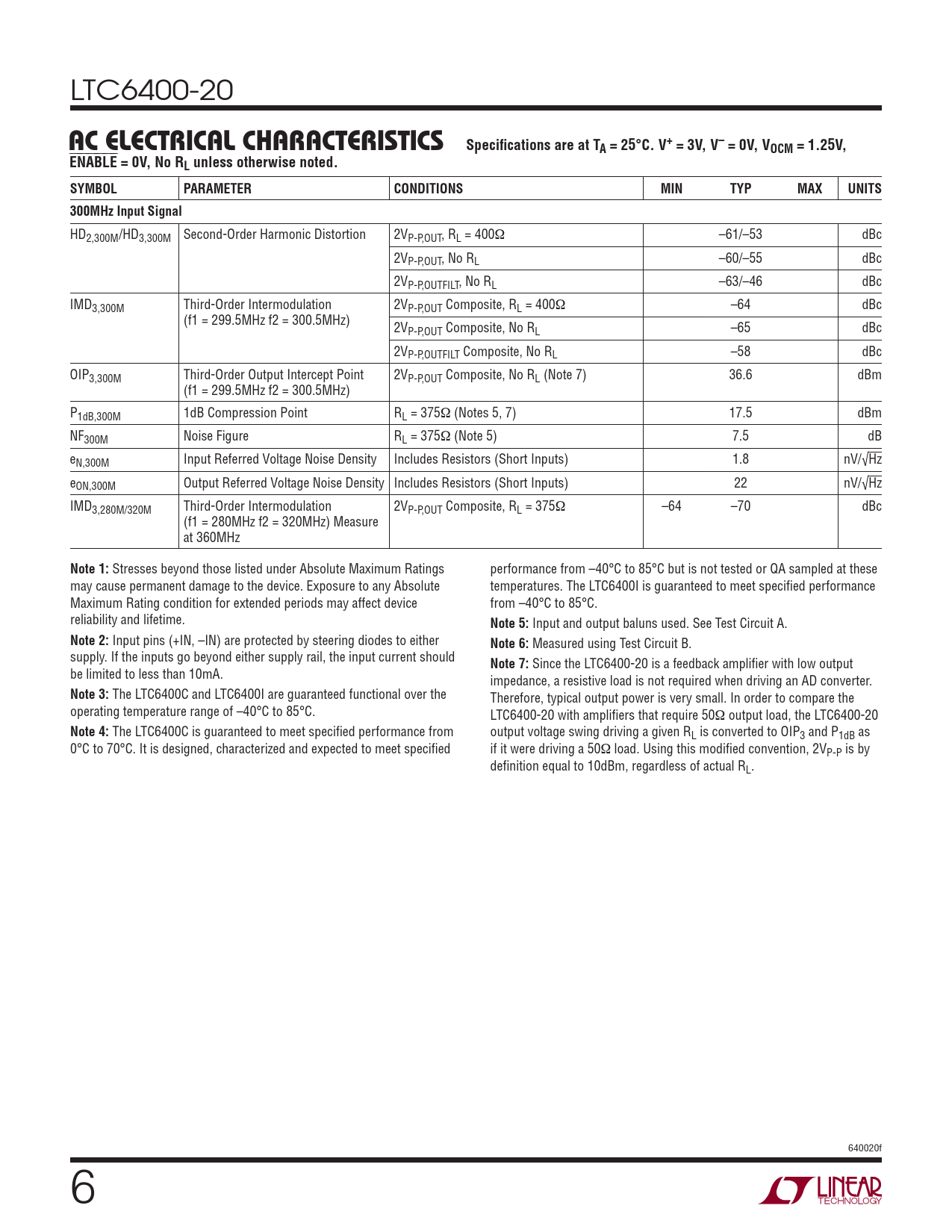

AC ELECTRICAL CHARACTERISTICS. Specifi cations are at TA = 25°C. V+ = 3V, V– = 0V, VOCM = 1.25V,
AC ELECTRICAL CHARACTERISTICS Specifi cations are at TA = 25°C V+ = 3V, V– = 0V, VOCM = 1.25V,
LTC6400-20
AC ELECTRICAL CHARACTERISTICS Specifi cations are at TA = 25°C. V+ = 3V, V– = 0V, VOCM = 1.25V,
E
N
A
B
L
E = 0V, No RL unless otherwise noted. SYMBOL PARAMETER CONDITIONS MIN TYP MAX UNITS 300MHz Input Signal
HD2,300M/HD3,300M Second-Order Harmonic Distortion 2VP-P,OUT, RL = 400Ω –61/–53 dBc 2VP-P,OUT, No RL –60/–55 dBc 2VP-P,OUTFILT, No RL –63/–46 dBc IMD3,300M Third-Order Intermodulation 2VP-P,OUT Composite, RL = 400Ω –64 dBc (f1 = 299.5MHz f2 = 300.5MHz) 2VP-P,OUT Composite, No RL –65 dBc 2VP-P,OUTFILT Composite, No RL –58 dBc OIP3,300M Third-Order Output Intercept Point 2VP-P,OUT Composite, No RL (Note 7) 36.6 dBm (f1 = 299.5MHz f2 = 300.5MHz) P1dB,300M 1dB Compression Point RL = 375Ω (Notes 5, 7) 17.5 dBm NF300M Noise Figure RL = 375Ω (Note 5) 7.5 dB eN,300M Input Referred Voltage Noise Density Includes Resistors (Short Inputs) 1.8 nV/√Hz eON,300M Output Referred Voltage Noise Density Includes Resistors (Short Inputs) 22 nV/√Hz IMD3,280M/320M Third-Order Intermodulation 2VP-P,OUT Composite, RL = 375Ω –64 –70 dBc (f1 = 280MHz f2 = 320MHz) Measure at 360MHz
Note 1:
Stresses beyond those listed under Absolute Maximum Ratings performance from –40°C to 85°C but is not tested or QA sampled at these may cause permanent damage to the device. Exposure to any Absolute temperatures. The LTC6400I is guaranteed to meet specifi ed performance Maximum Rating condition for extended periods may affect device from –40°C to 85°C. reliability and lifetime.
Note 5:
Input and output baluns used. See Test Circuit A.
Note 2:
Input pins (+IN, –IN) are protected by steering diodes to either
Note 6:
Measured using Test Circuit B. supply. If the inputs go beyond either supply rail, the input current should
Note 7:
Since the LTC6400-20 is a feedback amplifi er with low output be limited to less than 10mA. impedance, a resistive load is not required when driving an AD converter.
Note 3:
The LTC6400C and LTC6400I are guaranteed functional over the Therefore, typical output power is very small. In order to compare the operating temperature range of –40°C to 85°C. LTC6400-20 with amplifi ers that require 50Ω output load, the LTC6400-20
