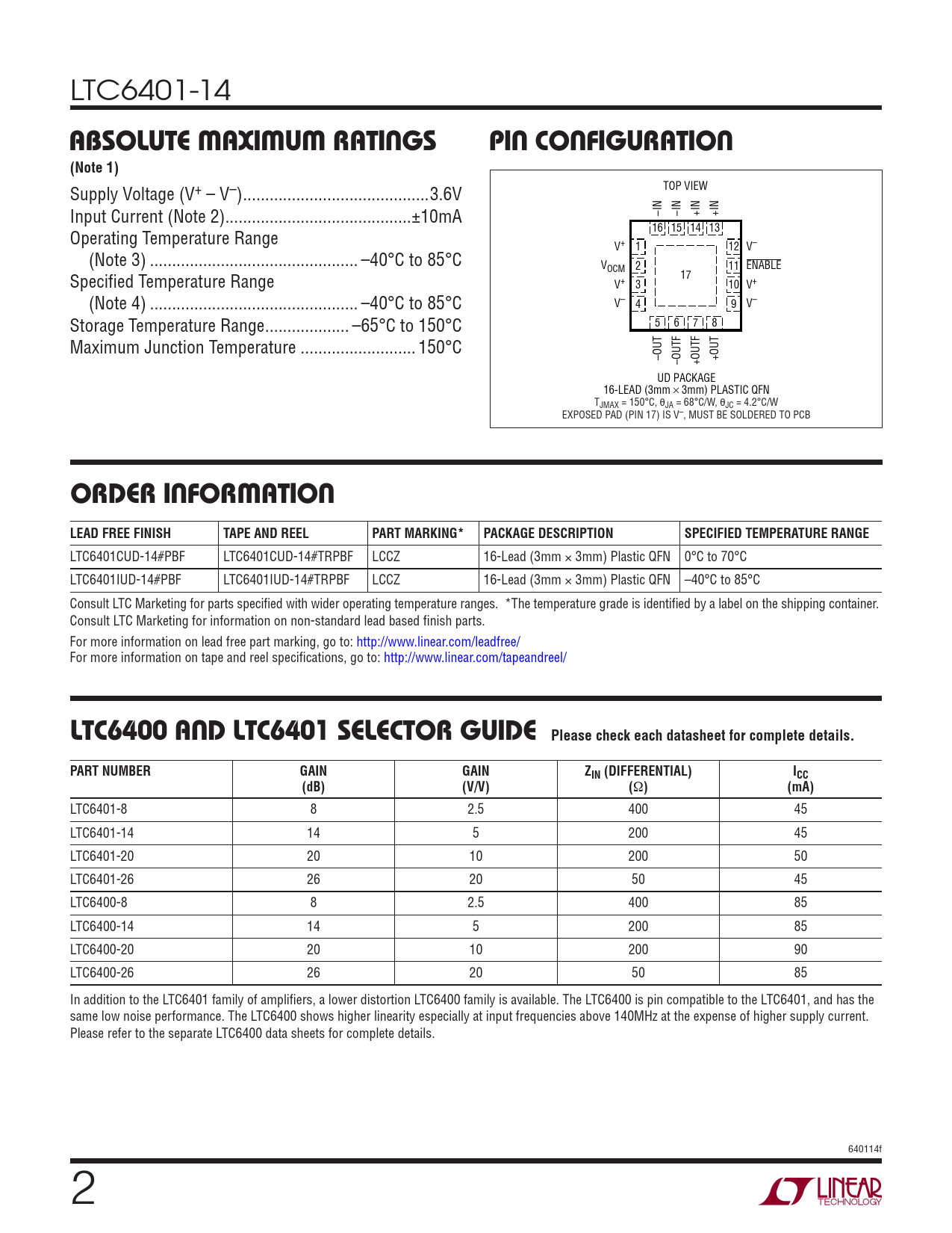

ABSOLUTE MAXIMUM RATINGS. PIN CONFIGURATION. (Note 1). ORDER INFORMATION. LEAD FREE FINISH. TAPE AND REEL. PART MARKING*
ABSOLUTE MAXIMUM RATINGS PIN CONFIGURATION (Note 1) ORDER INFORMATION LEAD FREE FINISH TAPE AND REEL PART MARKING*
LTC6401-14
TOP VIEW Supply Voltage (V+ – V–) ..3.6V Input Current (Note 2) ..±10mA –IN –IN +IN +IN 16 15 14 13 Operating Temperature Range V+ 1 12 V– (Note 3) ... –40°C to 85°C V 2 11 OCM ENABLE Specifi ed Temperature Range 17 V+ 3 10 V+ (Note 4) ... –40°C to 85°C V– 4 9 V– Storage Temperature Range ... –65°C to 150°C 5 6 7 8 Maximum Junction Temperature .. 150°C –OUT –OUTF +OUTF +OUT UD PACKAGE 16-LEAD (3mm × 3mm) PLASTIC QFN TJMAX = 150°C, θJA = 68°C/W, θJC = 4.2°C/W EXPOSED PAD (PIN 17) IS V–, MUST BE SOLDERED TO PCB
ORDER INFORMATION LEAD FREE FINISH TAPE AND REEL PART MARKING* PACKAGE DESCRIPTION SPECIFIED TEMPERATURE RANGE
LTC6401CUD-14#PBF LTC6401CUD-14#TRPBF LCCZ 16-Lead (3mm × 3mm) Plastic QFN 0°C to 70°C LTC6401IUD-14#PBF LTC6401IUD-14#TRPBF LCCZ 16-Lead (3mm × 3mm) Plastic QFN –40°C to 85°C Consult LTC Marketing for parts specifi ed with wider operating temperature ranges. *The temperature grade is identifi ed by a label on the shipping container. Consult LTC Marketing for information on non-standard lead based fi nish parts. For more information on lead free part marking, go to: http://www.linear.com/leadfree/ For more information on tape and reel specifi cations, go to: http://www.linear.com/tapeandreel/
LTC6400 AND LTC6401 SELECTOR GUIDE Please check each datasheet for complete details. PART NUMBER GAIN GAIN ZIN (DIFFERENTIAL) ICC (dB) (V/V) (
Ω
) (mA)
LTC6401-8 8 2.5 400 45 LTC6401-14 14 5 200 45 LTC6401-20 20 10 200 50 LTC6401-26 26 20 50 45 LTC6400-8 8 2.5 400 85 LTC6400-14 14 5 200 85 LTC6400-20 20 10 200 90 LTC6400-26 26 20 50 85 In addition to the LTC6401 family of amplifi ers, a lower distortion LTC6400 family is available. The LTC6400 is pin compatible to the LTC6401, and has the same low noise performance. The LTC6400 shows higher linearity especially at input frequencies above 140MHz at the expense of higher supply current. Please refer to the separate LTC6400 data sheets for complete details. 640114f 2
