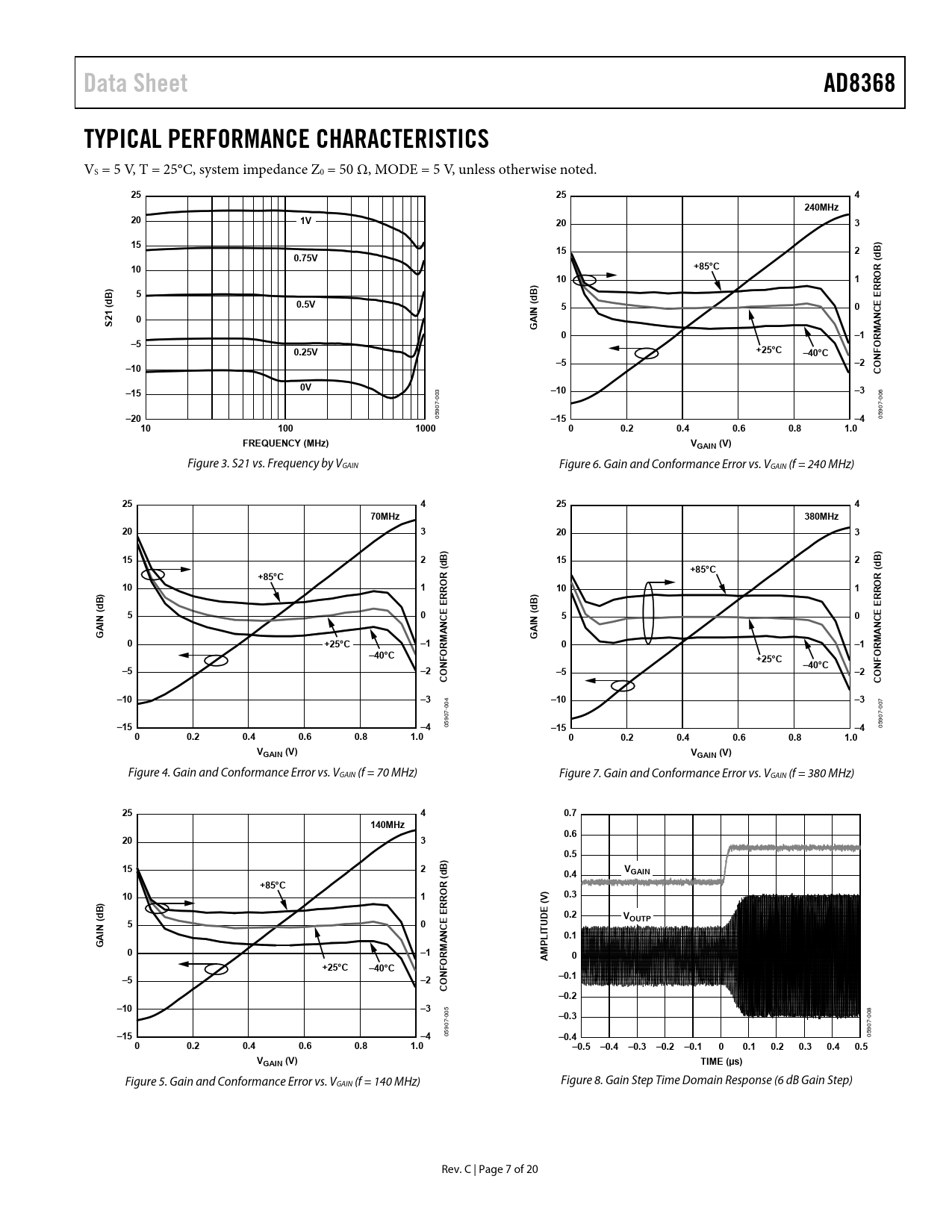

Data Sheet. AD8368. TYPICAL PERFORMANCE CHARACTERISTICS. 240MHz. 0.75V. +85°C. R (. RRO. B d. 0.5V. S21. ANC. 0.25V. +25°C. –40°C. –10. O C. –15. –20. 100

Data Sheet AD8368 TYPICAL PERFORMANCE CHARACTERISTICS
VS = 5 V, T = 25°C, system impedance Z0 = 50 Ω, MODE = 5 V, unless otherwise noted.

Figure 3. S21 vs. Frequency by VGAIN Figure 6. Gain and Conformance Error vs. VGAIN (f = 240 MHz)

Figure 4. Gain and Conformance Error vs. VGAIN (f = 70 MHz) Figure 7. Gain and Conformance Error vs. VGAIN (f = 380 MHz)

Figure 5. Gain and Conformance Error vs. V Figure 8. Gain Step Time Domain Response (6 dB Gain Step) GAIN (f = 140 MHz) Rev. C | Page 7 of 20 Document Outline FEATURES APPLICATIONS FUNCTIONAL BLOCK DIAGRAM GENERAL DESCRIPTION REVISION HISTORY SPECIFICATIONS ABSOLUTE MAXIMUM RATINGS ESD CAUTION PIN CONFIGURATION AND FUNCTION DESCRIPTIONS TYPICAL PERFORMANCE CHARACTERISTICS CIRCUIT DESCRIPTION INPUT ATTENUATOR AND INTERPOLATOR FIXED-GAIN STAGE AND OUTPUT BUFFER OUTPUT OFFSET CORRECTION INPUT AND OUTPUT IMPEDANCES GAIN CONTROL INTERFACE APPLICATIONS INFORMATION VGA OPERATION AGC OPERATION STABILITY AND LAYOUT CONSIDERATIONS EVALUATION BOARD OUTLINE DIMENSIONS ORDERING GUIDE
