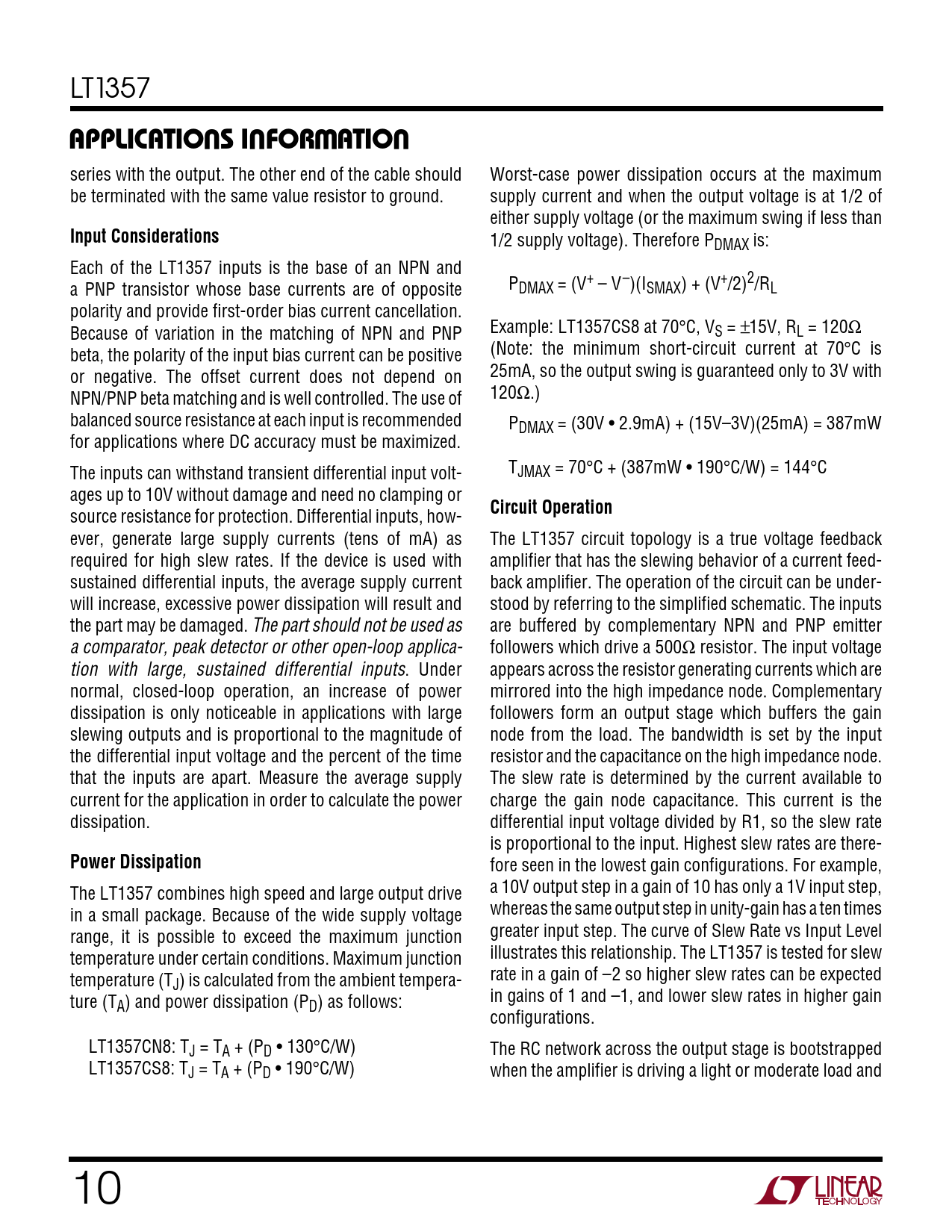

U U W U APPLICATIONS INFORMATION
series with the output. The other end of the cable should Worst-case power dissipation occurs at the maximum be terminated with the same value resistor to ground. supply current and when the output voltage is at 1/2 of either supply voltage (or the maximum swing if less than
Input Considerations
1/2 supply voltage). Therefore PDMAX is: Each of the LT1357 inputs is the base of an NPN and a PNP transistor whose base currents are of opposite PDMAX = (V+ – V–)(ISMAX) + (V+/2)2/RL polarity and provide first-order bias current cancellation. Because of variation in the matching of NPN and PNP Example: LT1357CS8 at 70°C, VS = ±15V, RL = 120Ω beta, the polarity of the input bias current can be positive (Note: the minimum short-circuit current at 70°C is or negative. The offset current does not depend on 25mA, so the output swing is guaranteed only to 3V with NPN/PNP beta matching and is well controlled. The use of 120Ω.) balanced source resistance at each input is recommended PDMAX = (30V • 2.9mA) + (15V–3V)(25mA) = 387mW for applications where DC accuracy must be maximized. The inputs can withstand transient differential input volt- TJMAX = 70°C + (387mW • 190°C/W) = 144°C ages up to 10V without damage and need no clamping or
Circuit Operation
source resistance for protection. Differential inputs, how- ever, generate large supply currents (tens of mA) as The LT1357 circuit topology is a true voltage feedback required for high slew rates. If the device is used with amplifier that has the slewing behavior of a current feed- sustained differential inputs, the average supply current back amplifier. The operation of the circuit can be under- will increase, excessive power dissipation will result and stood by referring to the simplified schematic. The inputs the part may be damaged. The part should not be used as are buffered by complementary NPN and PNP emitter a comparator, peak detector or other open-loop applica- followers which drive a 500Ω resistor. The input voltage tion with large, sustained differential inputs. Under appears across the resistor generating currents which are normal, closed-loop operation, an increase of power mirrored into the high impedance node. Complementary dissipation is only noticeable in applications with large followers form an output stage which buffers the gain slewing outputs and is proportional to the magnitude of node from the load. The bandwidth is set by the input the differential input voltage and the percent of the time resistor and the capacitance on the high impedance node. that the inputs are apart. Measure the average supply The slew rate is determined by the current available to current for the application in order to calculate the power charge the gain node capacitance. This current is the dissipation. differential input voltage divided by R1, so the slew rate is proportional to the input. Highest slew rates are there-
Power Dissipation
fore seen in the lowest gain configurations. For example, The LT1357 combines high speed and large output drive a 10V output step in a gain of 10 has only a 1V input step, in a small package. Because of the wide supply voltage whereas the same output step in unity-gain has a ten times range, it is possible to exceed the maximum junction greater input step. The curve of Slew Rate vs Input Level temperature under certain conditions. Maximum junction illustrates this relationship. The LT1357 is tested for slew temperature (T rate in a gain of –2 so higher slew rates can be expected J) is calculated from the ambient tempera- ture (T in gains of 1 and –1, and lower slew rates in higher gain A) and power dissipation (PD) as follows: configurations. LT1357CN8: TJ = TA + (PD • 130°C/W) The RC network across the output stage is bootstrapped LT1357CS8: TJ = TA + (PD • 190°C/W) when the amplifier is driving a light or moderate load and 10
