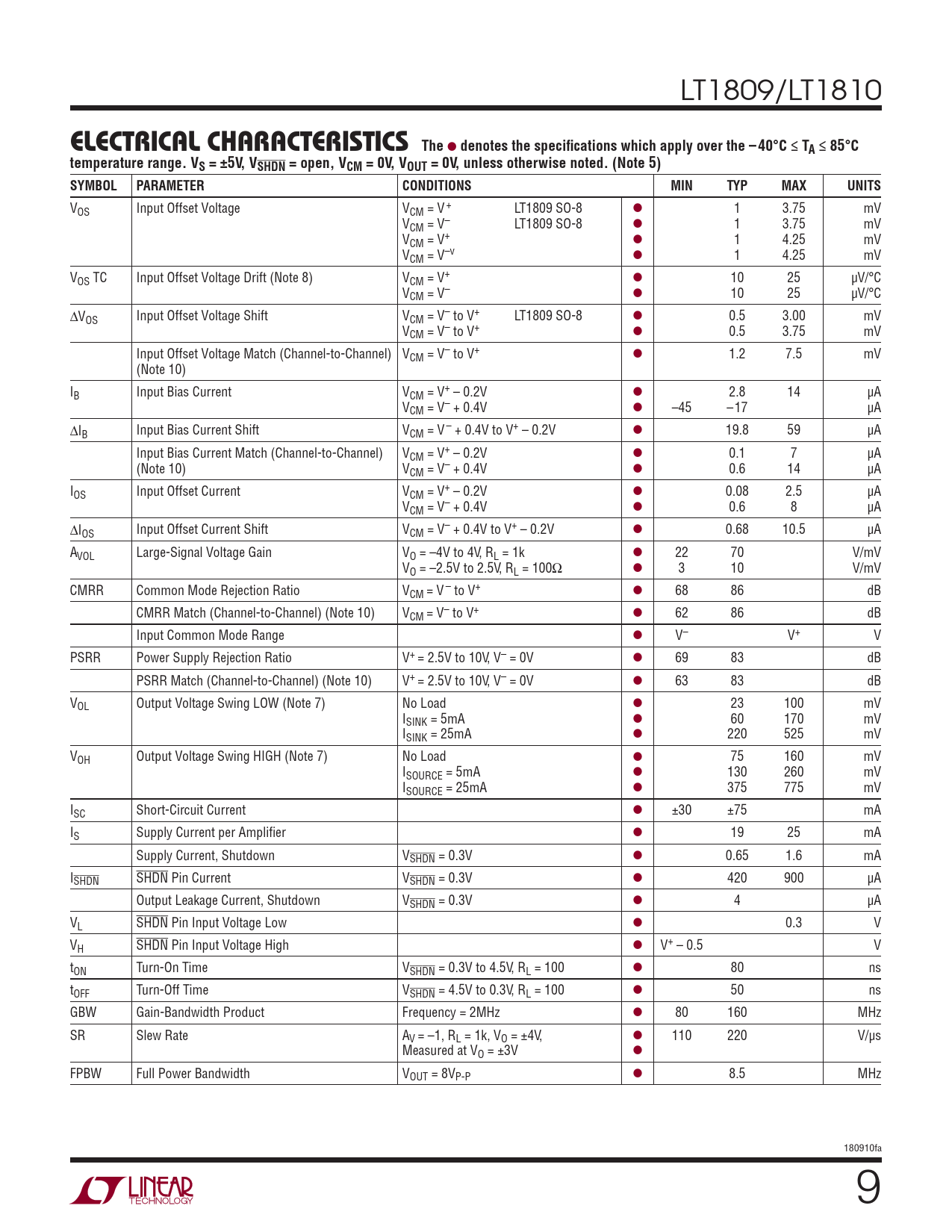

The. ELECTRICAL CHARACTERISTICS. denotes the specifi cations which apply over the – 40°C ≤ TA ≤ 85°C
The ELECTRICAL CHARACTERISTICS denotes the specifi cations which apply over the – 40°C ≤ TA ≤ 85°C
LT1809/LT1810
denotes the specifi cations which apply over the – 40°C ≤ TA ≤ 85°C temperature range. VS = ±5V, VSHDN = open, VCM = 0V, VOUT = 0V, unless otherwise noted. (Note 5) SYMBOL PARAMETER CONDITIONS MIN TYP MAX UNITS
VOS Input Offset Voltage VCM = V + LT1809 SO-8 l 1 3.75 mV VCM = V– LT1809 SO-8 l 1 3.75 mV VCM = V+ l 1 4.25 mV VCM = V–v l 1 4.25 mV VOS TC Input Offset Voltage Drift (Note 8) VCM = V+ l 10 25 μV/°C VCM = V– l 10 25 μV/°C ΔV l OS Input Offset Voltage Shift VCM = V– to V+ LT1809 SO-8 0.5 3.00 mV VCM = V– to V+ l 0.5 3.75 mV Input Offset Voltage Match (Channel-to-Channel) VCM = V– to V+ l 1.2 7.5 mV (Note 10) IB Input Bias Current VCM = V+ – 0.2V l 2.8 14 μA VCM = V– + 0.4V l –45 –17 μA ΔIB Input Bias Current Shift VCM = V – + 0.4V to V+ – 0.2V l 19.8 59 μA Input Bias Current Match (Channel-to-Channel) VCM = V+ – 0.2V l 0.1 7 μA (Note 10) VCM = V– + 0.4V l 0.6 14 μA IOS Input Offset Current VCM = V+ – 0.2V l 0.08 2.5 μA VCM = V– + 0.4V l 0.6 8 μA ΔIOS Input Offset Current Shift VCM = V– + 0.4V to V+ – 0.2V l 0.68 10.5 μA AVOL Large-Signal Voltage Gain VO = –4V to 4V, RL = 1k l 22 70 V/mV VO = –2.5V to 2.5V, RL = 100Ω l 3 10 V/mV CMRR Common Mode Rejection Ratio VCM = V – to V+ l 68 86 dB CMRR Match (Channel-to-Channel) (Note 10) VCM = V– to V+ l 62 86 dB Input Common Mode Range l V– V+ V PSRR Power Supply Rejection Ratio V+ = 2.5V to 10V, V– = 0V l 69 83 dB PSRR Match (Channel-to-Channel) (Note 10) V+ = 2.5V to 10V, V– = 0V l 63 83 dB VOL Output Voltage Swing LOW (Note 7) No Load l 23 100 mV ISINK = 5mA l 60 170 mV ISINK = 25mA l 220 525 mV VOH Output Voltage Swing HIGH (Note 7) No Load l 75 160 mV ISOURCE = 5mA l 130 260 mV ISOURCE = 25mA l 375 775 mV ISC Short-Circuit Current l ±30 ±75 mA IS Supply Current per Amplifi er l 19 25 mA Supply Current, Shutdown VSHDN = 0.3V l 0.65 1.6 mA ISHDN SHDN Pin Current VSHDN = 0.3V l 420 900 μA Output Leakage Current, Shutdown VSHDN = 0.3V l 4 μA VL SHDN Pin Input Voltage Low l 0.3 V VH SHDN Pin Input Voltage High l V+ – 0.5 V tON Turn-On Time VSHDN = 0.3V to 4.5V, RL = 100 l 80 ns tOFF Turn-Off Time VSHDN = 4.5V to 0.3V, RL = 100 l 50 ns GBW Gain-Bandwidth Product Frequency = 2MHz l 80 160 MHz SR Slew Rate AV = –1, RL = 1k, VO = ±4V, l 110 220 V/μs Measured at VO = ±3V l FPBW Full Power Bandwidth VOUT = 8VP-P l 8.5 MHz 180910fa 9
