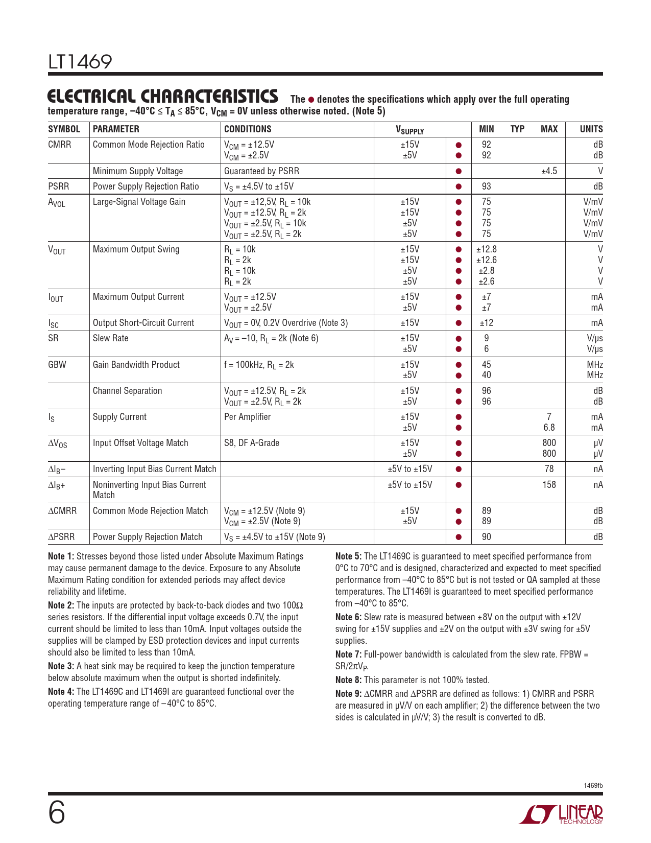

LT1469
l
denotes the specifications which apply over the full operating temperature range, –40°C ≤ TA ≤ 85°C, VCM = 0V unless otherwise noted. (Note 5) SYMBOL PARAMETER CONDITIONS VSUPPLY MIN TYP MAX UNITS
CMRR Common Mode Rejection Ratio VCM = ±12.5V ±15V ● 92 dB VCM = ±2.5V ±5V ● 92 dB Minimum Supply Voltage Guaranteed by PSRR ● ±4.5 V PSRR Power Supply Rejection Ratio VS = ±4.5V to ±15V ● 93 dB AVOL Large-Signal Voltage Gain VOUT = ±12,5V, RL = 10k ±15V ● 75 V/mV VOUT = ±12.5V, RL = 2k ±15V ● 75 V/mV VOUT = ±2.5V, RL = 10k ±5V ● 75 V/mV VOUT = ±2.5V, RL = 2k ±5V ● 75 V/mV VOUT Maximum Output Swing RL = 10k ±15V ● ±12.8 V RL = 2k ±15V ● ±12.6 V RL = 10k ±5V ● ±2.8 V RL = 2k ±5V ● ±2.6 V IOUT Maximum Output Current VOUT = ±12.5V ±15V ● ±7 mA VOUT = ±2.5V ±5V ● ±7 mA ISC Output Short-Circuit Current VOUT = 0V, 0.2V Overdrive (Note 3) ±15V ● ±12 mA SR Slew Rate AV = –10, RL = 2k (Note 6) ±15V ● 9 V/µs ±5V ● 6 V/µs GBW Gain Bandwidth Product f = 100kHz, RL = 2k ±15V ● 45 MHz ±5V ● 40 MHz Channel Separation VOUT = ±12.5V, RL = 2k ±15V ● 96 dB VOUT = ±2.5V, RL = 2k ±5V ● 96 dB IS Supply Current Per Amplifier ±15V ● 7 mA ±5V ● 6.8 mA ∆VOS Input Offset Voltage Match S8, DF A-Grade ±15V ● 800 µV ±5V ● 800 µV ∆IB– Inverting Input Bias Current Match ±5V to ±15V ● 78 nA ∆IB+ Noninverting Input Bias Current ±5V to ±15V ● 158 nA Match ∆CMRR Common Mode Rejection Match VCM = ±12.5V (Note 9) ±15V ● 89 dB VCM = ±2.5V (Note 9) ±5V ● 89 dB ∆PSRR Power Supply Rejection Match VS = ±4.5V to ±15V (Note 9) ● 90 dB
Note 1:
Note 5:
The LT1469C is guaranteed to meet specified performance from may cause permanent damage to the device. Exposure to any Absolute 0°C to 70°C and is designed, characterized and expected to meet specified Maximum Rating condition for extended periods may affect device performance from –40°C to 85°C but is not tested or QA sampled at these reliability and lifetime. temperatures. The LT1469I is guaranteed to meet specified performance
Note 2:
The inputs are protected by back-to-back diodes and two 100Ω from –40°C to 85°C. series resistors. If the differential input voltage exceeds 0.7V, the input
Note 6:
Slew rate is measured between ±8V on the output with ±12V current should be limited to less than 10mA. Input voltages outside the swing for ±15V supplies and ±2V on the output with ±3V swing for ±5V supplies will be clamped by ESD protection devices and input currents supplies. should also be limited to less than 10mA.
Note 7:
Full-power bandwidth is calculated from the slew rate. FPBW =
Note 3:
A heat sink may be required to keep the junction temperature SR/2πVP. below absolute maximum when the output is shorted indefinitely.
Note 8:
This parameter is not 100% tested.
Note 4:
The LT1469C and LT1469I are guaranteed functional over the
Note 9:
∆CMRR and ∆PSRR are defined as follows: 1) CMRR and PSRR operating temperature range of –40°C to 85°C. are measured in µV/V on each amplifier; 2) the difference between the two sides is calculated in µV/V; 3) the result is converted to dB. 1469fb 6 Document Outline Features Description Applications Typical Application Absolute Maximum Ratings Pin Configuration Order Information Electrical Characteristics Typical Performance Characteristics Applications Information Typical Applications Simplified Schematic Package Description Revision History Typical Application Related Parts
