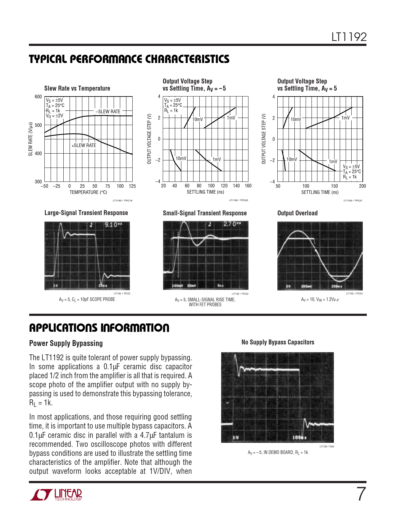

TYPICAL PERFOR A CE CHARACTERISTICS. Output Voltage Step. Slew Rate vs Temperature. vs Settling Time, AV = – 5
TYPICAL PERFOR A CE CHARACTERISTICS Output Voltage Step Slew Rate vs Temperature vs Settling Time, AV = – 5
LT1192
W U TYPICAL PERFOR A CE CHARACTERISTICS Output Voltage Step Output Voltage Step Slew Rate vs Temperature vs Settling Time, AV = – 5 vs Settling Time, AV = 5
600 4 4 VS = ±5V VS = ±5V TA = 25°C TA = 25°C RL = 1k –SLEW RATE RL = 1k VO = ±2V 2 1mV 10mV 2 1mV 10mV µs) 500 TE (V/ TAGE STEP (V) 0 TAGE STEP (V) 0 +SLEW RATE SLEW RA 400 –2 10mV 1mV –2 10mV OUTPUT VOL OUTPUT VOL 1mV VS = ±5V TA = 25°C RL = 1k 300 –4 –4 –50 –25 0 25 50 75 100 125 20 40 60 80 100 120 140 160 50 100 150 200 TEMPERATURE (°C) SETTLING TIME (ns) SETTLING TIME (ns) LT1192 • TPC19 LT1192 • TPC20 LT1192 • TPC21
Large-Signal Transient Response Small-Signal Transient Response Output Overload
LT1192 • TPC22 LT1192 • TPC23 LT1192 • TPC24 AV = 5, CL = 10pF SCOPE PROBE A A V = 5, SMALL-SIGNAL RISE TIME, V = 10, VIN = 1.2VP-P WITH FET PROBES
U U W U APPLICATIO S I FOR ATIO Power Supply Bypassing No Supply Bypass Capacitors
The LT1192 is quite tolerant of power supply bypassing. In some applications a 0.1µF ceramic disc capacitor placed 1/2 inch from the amplifier is all that is required. A scope photo of the amplifier output with no supply by- passing is used to demonstrate this bypassing tolerance, RL = 1k. In most applications, and those requiring good settling time, it is important to use multiple bypass capacitors. A 0.1µF ceramic disc in parallel with a 4.7µF tantalum is recommended. Two oscilloscope photos with different LT1192 • TA04 bypass conditions are used to illustrate the settling time AV = – 5, IN DEMO BOARD, RL = 1k characteristics of the amplifier. Note that although the output waveform looks acceptable at 1V/DIV, when 7
