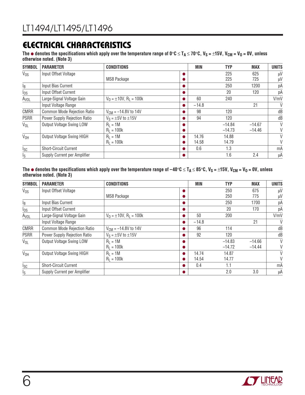

15V, VCM = VO = 0V, unless otherwise noted. (Note 3) SYMBOL PARAMETER CONDITIONS MIN TYP MAX UNITS
VOS Input Offset Voltage ● 225 625 µV MS8 Package ● 225 725 µV IB Input Bias Current ● 250 1200 pA IOS Input Offset Current ● 20 120 pA AVOL Large-Signal Voltage Gain VO = ±10V, RL = 100k ● 60 240 V/mV Input Voltage Range ● – 14.8 21 V CMRR Common Mode Rejection Ratio VCM = –14.8V to 14V ● 98 120 dB PSRR Power Supply Rejection Ratio VS = ±5V to ±15V ● 94 120 dB VOL Output Voltage Swing LOW RL = 1M ● –14.84 –14.67 V RL = 100k ● –14.73 –14.46 V VOH Output Voltage Swing HIGH RL = 1M ● 14.76 14.88 V RL = 100k ● 14.58 14.79 V ISC Short-Circuit Current ● 0.6 1.3 mA IS Supply Current per Amplifier ● 1.6 2.4 µA
The
denotes the specifications which apply over the temperature range of –40
C
TA
85
C, VS =
VOS Input Offset Voltage ● 250 675 µV MS8 Package ● 250 775 µV IB Input Bias Current ● 250 1700 pA IOS Input Offset Current ● 20 170 pA AVOL Large-Signal Voltage Gain VO = ±10V, RL = 100k ● 50 200 V/mV Input Voltage Range ● – 14.8 21 V CMRR Common Mode Rejection Ratio VCM = –14.8V to 14V ● 96 114 dB PSRR Power Supply Rejection Ratio VS = ±5V to ±15V ● 92 120 dB VOL Output Voltage Swing LOW RL = 1M ● –14.83 –14.66 V RL = 100k ● –14.72 –14.44 V VOH Output Voltage Swing HIGH RL = 1M ● 14.74 14.87 V RL = 100k ● 14.54 14.77 V ISC Short-Circuit Current ● 0.4 1.1 mA IS Supply Current per Amplifier ● 2.0 3.0 µA 6
