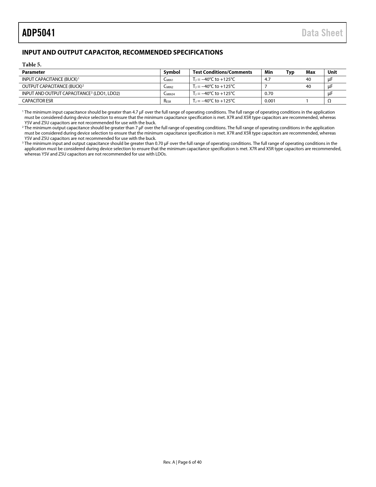

ADP5041. Data Sheet. INPUT AND OUTPUT CAPACITOR, RECOMMENDED SPECIFICATIONS. Table 5. Parameter. Symbol. Test Conditions/Comments
ADP5041 Data Sheet INPUT AND OUTPUT CAPACITOR, RECOMMENDED SPECIFICATIONS Table 5 Parameter Symbol Test Conditions/Comments
ADP5041 Data Sheet INPUT AND OUTPUT CAPACITOR, RECOMMENDED SPECIFICATIONS Table 5. Parameter Symbol Test Conditions/Comments Min Typ Max Unit
INPUT CAPACITANCE (BUCK)1 CMIN1 TJ = −40°C to +125°C 4.7 40 µF OUTPUT CAPACITANCE (BUCK)2 CMIN2 TJ = −40°C to +125°C 7 40 µF INPUT AND OUTPUT CAPACITANCE3 (LDO1, LDO2) CMIN34 TJ = −40°C to +125°C 0.70 µF CAPACITOR ESR RESR TJ = −40°C to +125°C 0.001 1 Ω 1 The minimum input capacitance should be greater than 4.7 µF over the full range of operating conditions. The full range of operating conditions in the application must be considered during device selection to ensure that the minimum capacitance specification is met. X7R and X5R type capacitors are recommended, whereas Y5V and Z5U capacitors are not recommended for use with the buck. 2 The minimum output capacitance should be greater than 7 µF over the full range of operating conditions. The full range of operating conditions in the application must be considered during device selection to ensure that the minimum capacitance specification is met. X7R and X5R type capacitors are recommended, whereas Y5V and Z5U capacitors are not recommended for use with the buck. 3 The minimum input and output capacitance should be greater than 0.70 µF over the full range of operating conditions. The full range of operating conditions in the application must be considered during device selection to ensure that the minimum capacitance specification is met. X7R and X5R type capacitors are recommended, whereas Y5V and Z5U capacitors are not recommended for use with LDOs. Rev. A | Page 6 of 40 Document Outline FEATURES FUNCTIONAL BLOCK DIAGRAM GENERAL DESCRIPTION TABLE OF CONTENTS REVISION HISTORY SPECIFICATIONS GENERAL SPECIFICATIONS SUPERVISORY SPECIFICATIONS BUCK SPECIFICATIONS LDO1, LDO2 SPECIFICATIONS INPUT AND OUTPUT CAPACITOR, RECOMMENDED SPECIFICATIONS ABSOLUTE MAXIMUM RATINGS THERMAL RESISTANCE ESD CAUTION PIN CONFIGURATION AND FUNCTION DESCRIPTIONS TYPICAL PERFORMANCE CHARACTERISTICS THEORY OF OPERATION POWER MANAGEMENT UNIT Thermal Protection Undervoltage Lockout Enable/Shutdown Active Pull-Down BUCK SECTION Control Scheme PWM Mode Power Save Mode (PSM) PSM Current Threshold Short-Circuit Protection Soft Start Current Limit 100% Duty Operation LDO SECTION SUPERVISORY SECTION Reset Output Manual Reset Input Watchdog Input APPLICATIONS INFORMATION BUCK EXTERNAL COMPONENT SELECTION Feedback Resistors Inductor Output Capacitor Input Capacitor LDO EXTERNAL COMPONENT SELECTION Feedback Resistors OUTPUT CAPACITOR Input Bypass Capacitor Input and Output Capacitor Properties SUPERVISORY SECTION Threshold Setting Resistors Watchdog Input Current Negative-Going Transients at the Monitored Rail Watchdog Software Considerations POWER DISSIPATION/THERMAL CONSIDERATIONS Buck Regulator Power Dissipation LDO Regulator Power Dissipation Junction Temperature APPLICATION DIAGRAM PCB LAYOUT GUIDELINES SUGGESTED LAYOUT BILL OF MATERIALS FACTORY PROGRAMMABLE OPTIONS OUTLINE DIMENSIONS ORDERING GUIDE
