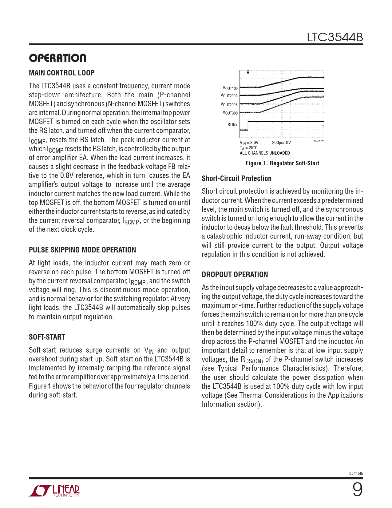

The LTC3544B uses a constant frequency, current mode VOUT100 step-down architecture. Both the main (P-channel VOUT200A MOSFET) and synchronous (N-channel MOSFET) switches VOUT200B are internal. During normal operation, the internal top power VOUT300 MOSFET is turned on each cycle when the oscillator sets RUNx the RS latch, and turned off when the current comparator, ICOMP , resets the RS latch. The peak inductor current at V 3544B F01 IN = 3.6V 200µs/DIV which ICOMP resets the RS latch, is controlled by the output TA = 25°C of error amplifier EA. When the load current increases, it ALL CHANNELS UNLOADED causes a slight decrease in the feedback voltage FB rela-
Figure 1. Regulator Soft-Start

SOFT-START
then be determined by the input voltage minus the voltage drop across the P-channel MOSFET and the inductor. An Soft-start reduces surge currents on VIN and output important detail to remember is that at low input supply overshoot during start-up. Soft-start on the LTC3544B is voltages, the RDS(ON) of the P-channel switch increases implemented by internally ramping the reference signal (see Typical Performance Characteristics). Therefore, fed to the error amplifier over approximately a 1ms period. the user should calculate the power dissipation when Figure 1 shows the behavior of the four regulator channels the LTC3544B is used at 100% duty cycle with low input during soft-start. voltage (See Thermal Considerations in the Applications Information section). 3544bfb Document Outline Features Applications Description Typical Application Absolute Maximum Ratings Pin Configuration Order Information Electrical Characteristics Typical Performance Characteristics Pin Functions Functional Diagrams Operation Applications Information Package Description Revision History Related Parts
