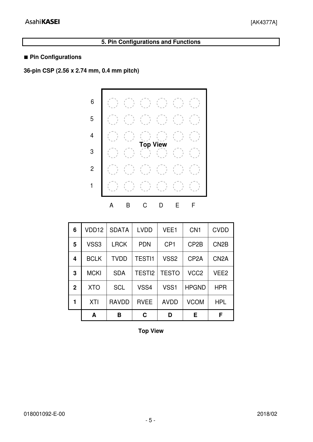

[AK4377A] 5. Pin Configurations and Functions ■ Pin Configurations. 36-pin CSP (2.56 x 2.74 mm, 0.4 mm pitch) 6. 4 Top View
[AK4377A] 5 Pin Configurations and Functions ■ Pin Configurations 36-pin CSP (2.56 x 2.74 mm, 0.4 mm pitch) 6 4 Top View
5
4 Top View
3
2
1
A B C D E F 6 VDD12 SDATA LVDD VEE1 CN1 CVDD 5 VSS3 LRCK PDN CP1 CP2B CN2B 4 BCLK TVDD TESTI1 VSS2 CP2A CN2A 3 MCKI SDA TESTI2 TESTO VCC2 VEE2 2 XTO SCL VSS4 VSS1 HPGND HPR 1 XTI RAVDD RVEE AVDD VCOM HPL A B C D E F Top View 018001092-E-00 2018/02
