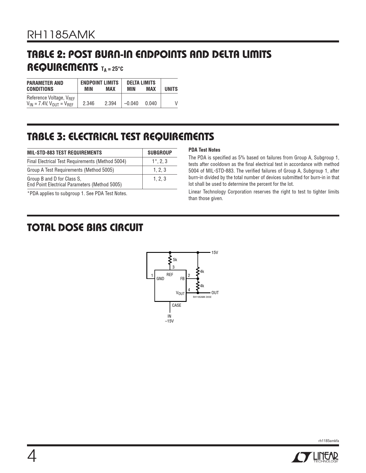

TABLE 2: POST BURN-IN ENDPOINTS AND DELTA LIMITS REQUIREMENTS TA = 25°C. PARAMETER AND. ENDPOINT LIMITS. DELTA LIMITS
TABLE 2: POST BURN-IN ENDPOINTS AND DELTA LIMITS REQUIREMENTS TA = 25°C PARAMETER AND ENDPOINT LIMITS DELTA LIMITS
RH1185AMK
TABLE 2: POST BURN-IN ENDPOINTS AND DELTA LIMITS REQUIREMENTS TA = 25°C PARAMETER AND ENDPOINT LIMITS DELTA LIMITS CONDITIONS MIN MAX MIN MAX UNITS
Reference Voltage, VREF VIN = 7.4V, VOUT = VREF 2.346 2.394 –0.040 0.040 V
TABLE 3: ELECTRICAL TEST REQUIREMENTS MIL-STD-883 TEST REQUIREMENTS SUBGROUP PDA Test Notes
The PDA is specified as 5% based on failures from Group A, Subgroup 1, Final Electrical Test Requirements (Method 5004) 1*, 2, 3 tests after cooldown as the final electrical test in accordance with method Group A Test Requirements (Method 5005) 1, 2, 3 5004 of MIL-STD-883. The verified failures of Group A, Subgroup 1, after Group B and D for Class S, 1, 2, 3 burn-in divided by the total number of devices submitted for burn-in in that End Point Electrical Parameters (Method 5005) lot shall be used to determine the percent for the lot. *PDA applies to subgroup 1. See PDA Test Notes. Linear Technology Corporation reserves the right to test to tighter limits than those given.
TOTAL DOSE BIAS CIRCUIT
15V 5k 3 4k 1 REF 2 GND FB 4k 4 VOUT OUT RH1185AMK DOSE CASE IN –15V rh1185amkfa 4 Document Outline Description Electrical Characteristics
