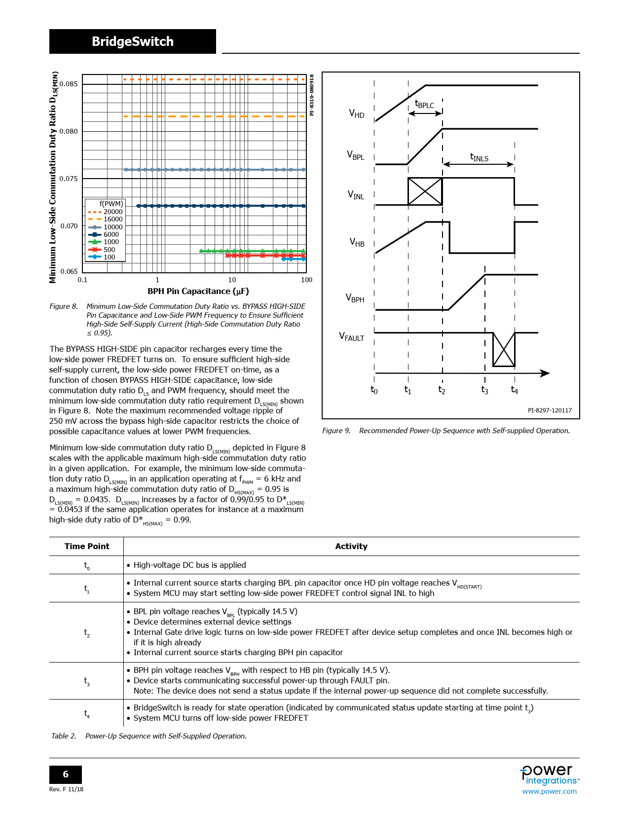

BridgeSwitch. LS(MIN). PI-8310-080918. ty Ratio D. Minimum Low-Side Commutation Du. BPH Pin Capacitance (. Time Point. Activity
BridgeSwitch LS(MIN) PI-8310-080918 ty Ratio D Minimum Low-Side Commutation Du BPH Pin Capacitance ( Time Point Activity
BridgeSwitch
0.085
LS(MIN)
tBPLC
PI-8310-080918
VHD
ty Ratio D
0.080 VBPL tINLS 0.075 VINL f(PWM) 20000 16000 0.070 10000 6000 1000 VHB 500 100 0.065
0.1 1 10 100
µ
F)
VBPH Figure 8. Minimum Low-Side Commutation Duty Ratio vs. BYPASS HIGH-SIDE Pin Capacitance and Low-Side PWM Frequency to Ensure Sufficient High-Side Self-Supply Current (High-Side Commutation Duty Ratio ≤ 0.95). VFAULT The BYPASS HIGH-SIDE pin capacitor recharges every time the low-side power FREDFET turns on. To ensure sufficient high-side self-supply current, the low-side power FREDFET on-time, as a function of chosen BYPASS HIGH-SIDE capacitance, low-side commutation duty ratio D and PWM frequency, should meet the t t LS 0 t1 t2 3 t4 minimum low-side commutation duty ratio requirement D shown LS(MIN) in Figure 8. Note the maximum recommended voltage ripple of PI-8297-120117 250 mV across the bypass high-side capacitor restricts the choice of possible capacitance values at lower PWM frequencies. Figure 9. Recommended Power-Up Sequence with Self-supplied Operation. Minimum low-side commutation duty ratio D depicted in Figure 8 LS(MIN) scales with the applicable maximum high-side commutation duty ratio in a given application. For example, the minimum low-side commuta- tion duty ratio D in an application operating at f = 6 kHz and LS(MIN) PWM a maximum high-side commutation duty ratio of D = 0.95 is HS(MAX) D = 0.0435. D increases by a factor of 0.99/0.95 to D* LS(MIN) LS(MIN) LS(MIN) = 0.0453 if the same application operates for instance at a maximum high-side duty ratio of D* = 0.99. HS(MAX)
Time Point Activity
t • High-voltage DC bus is applied 0 • Internal current source starts charging BPL pin capacitor once HD pin voltage reaches V t HD(START) 1 • System MCU may start setting low-side power FREDFET control signal INL to high • BPL pin voltage reaches V (typical y 14.5 V) BPL • Device determines external device settings t • Internal Gate drive logic turns on low-side power FREDFET after device setup completes and once INL becomes high or 2 if it is high already • Internal current source starts charging BPH pin capacitor • BPH pin voltage reaches V with respect to HB pin (typical y 14.5 V). BPH t • Device starts communicating successful power-up through FAULT pin. 3 Note: The device does not send a status update if the internal power-up sequence did not complete successfully. t • BridgeSwitch is ready for state operation (indicated by communicated status update starting at time point t ) 3 4 • System MCU turns off low-side power FREDFET Table 2. Power-Up Sequence with Self-Supplied Operation.
