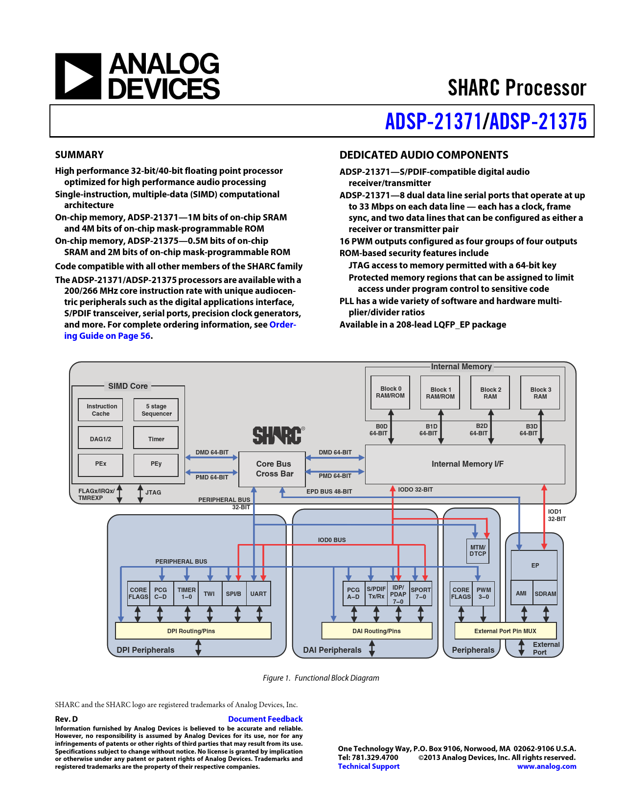

SHARC Processor ADSP-21371 /ADSP-21375 SUMMARY DEDICATED AUDIO COMPONENTS High performance 32-bit/40-bit floating point processor ADSP-21371—S/PDIF-compatible digital audio optimized for high performance audio processing receiver/transmitter Single-instruction, multiple-data (SIMD) computational ADSP-21371—8 dual data line serial ports that operate at up architecture to 33 Mbps on each data line — each has a clock, frame On-chip memory, ADSP-21371—1M bits of on-chip SRAM sync, and two data lines that can be configured as either a and 4M bits of on-chip mask-programmable ROM receiver or transmitter pair On-chip memory, ADSP-21375—0.5M bits of on-chip 16 PWM outputs configured as four groups of four outputs SRAM and 2M bits of on-chip mask-programmable ROM ROM-based security features include Code compatible with all other members of the SHARC family JTAG access to memory permitted with a 64-bit key The ADSP-21371/ADSP-21375 processors are available with a Protected memory regions that can be assigned to limit 200/266 MHz core instruction rate with unique audiocen- access under program control to sensitive code tric peripherals such as the digital applications interface, PLL has a wide variety of software and hardware multi- S/PDIF transceiver, serial ports, precision clock generators, plier/divider ratios and more. For complete ordering information, see Order- Available in a 208-lead LQFP_EP package ing Guide on Page 56 . Internal Memory SIMD Core Block 0 Block 1 Block 2 Block 3 RAM/ROM RAM/ROM RAM RAM Instruction 5 stage Cache Sequencer B0D B1D B2D B3D 64-BIT 64-BIT 64-BIT 64-BIT
S
DAG1/2 Timer DMD 64-BIT DMD 64-BIT PEx PEy Core Bus Internal Memory I/F Cross Bar PMD 64-BIT PMD 64-BIT IODO 32-BIT FLAGx/IRQx/ EPD BUS 48-BIT JTAG TMREXP PERIPHERAL BUS 32-BIT IOD1 32-BIT IOD0 BUS MTM/ D TCP PERIPHERAL BUS EP CORE PCG TIMER PCG IDP/ S/PDIF SPORT CORE PWM TWI SPI/B UART PDAP AMI SDRAM FLAGS C-D 1-0 A-D Tx/Rx 7-0 FLAGS 3-0 7-0 DPI Routing/Pins DAI Routing/Pins External Port Pin MUX External DPI Peripherals DAI Peripherals Peripherals Port
Figure 1. Functional Block Diagram SHARC and the SHARC logo are registered trademarks of Analog Devices, Inc.
