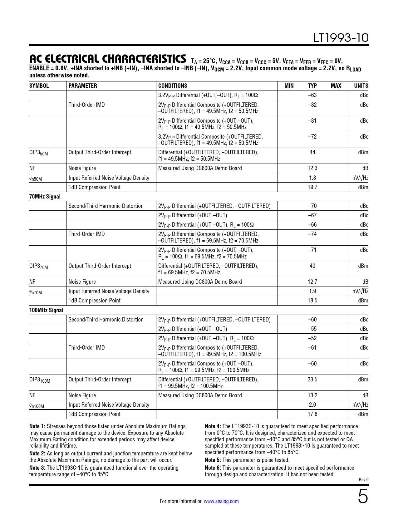

AC ELECTRICAL CHARACTERISTICS. TA = 25°C, VCCA = VCCB = VCCC = 5V, VEEA = VEEB = VEEC = 0V,
AC ELECTRICAL CHARACTERISTICS TA = 25°C, VCCA = VCCB = VCCC = 5V, VEEA = VEEB = VEEC = 0V,
LT1993-10
AC ELECTRICAL CHARACTERISTICS TA = 25°C, VCCA = VCCB = VCCC = 5V, VEEA = VEEB = VEEC = 0V, ENABLE = 0.8V, +INA shorted to +INB (+IN), –INA shorted to –INB (–IN), VOCM = 2.2V, Input common mode voltage = 2.2V, no RLOAD unless otherwise noted. SYMBOL PARAMETER CONDITIONS MIN TYP MAX UNITS
3.2VP-P Differential (+OUT, –OUT), RL = 100Ω –63 dBc Third-Order IMD 2VP-P Differential Composite (+OUTFILTERED, –82 dBc –OUTFILTERED), f1 = 49.5MHz, f2 = 50.5MHz 2VP-P Differential Composite (+OUT, –OUT), –81 dBc RL = 100Ω, f1 = 49.5MHz, f2 = 50.5MHz 3.2VP-P Differential Composite (+OUTFILTERED, –72 dBc –OUTFILTERED), f1 = 49.5MHz, f2 = 50.5MHz OIP350M Output Third-Order Intercept Differential (+OUTFILTERED, –OUTFILTERED), 44 dBm f1 = 49.5MHz, f2 = 50.5MHz NF Noise Figure Measured Using DC800A Demo Board 12.3 dB en50M Input Referred Noise Voltage Density 1.8 nV/√Hz 1dB Compression Point 19.7 dBm
70MHz Signal
Second/Third Harmonic Distortion 2VP-P Differential (+OUTFILTERED, –OUTFILTERED) –70 dBc 2VP-P Differential (+OUT, –OUT) –67 dBc 2VP-P Differential (+OUT, –OUT), RL = 100Ω –66 dBc Third-Order IMD 2VP-P Differential Composite (+OUTFILTERED, –74 dBc –OUTFILTERED), f1 = 69.5MHz, f2 = 70.5MHz 2VP-P Differential Composite (+OUT, –OUT), –71 dBc RL = 100Ω, f1 = 69.5MHz, f2 = 70.5MHz OIP370M Output Third-Order Intercept Differential (+OUTFILTERED, –OUTFILTERED), 40 dBm f1 = 69.5MHz, f2 = 70.5MHz NF Noise Figure Measured Using DC800A Demo Board 12.7 dB en70M Input Referred Noise Voltage Density 1.9 nV/√Hz 1dB Compression Point 18.5 dBm
100MHz Signal
Second/Third Harmonic Distortion 2VP-P Differential (+OUTFILTERED, –OUTFILTERED) –60 dBc 2VP-P Differential (+OUT, –OUT) –55 dBc 2VP-P Differential (+OUT, –OUT), RL = 100Ω –52 dBc Third-Order IMD 2VP-P Differential Composite (+OUTFILTERED, –61 dBc –OUTFILTERED), f1 = 99.5MHz, f2 = 100.5MHz 2VP-P Differential Composite (+OUT, –OUT), –60 dBc RL = 100Ω, f1 = 99.5MHz, f2 = 100.5MHz OIP3100M Output Third-Order Intercept Differential (+OUTFILTERED, –OUTFILTERED), 33.5 dBm f1 = 99.5MHz, f2 = 100.5MHz NF Noise Figure Measured Using DC800A Demo Board 13.2 dB en100M Input Referred Noise Voltage Density 2.0 nV/√Hz 1dB Compression Point 17.8 dBm
Note 1:
Note 4:
The LT1993C-10 is guaranteed to meet specified performance may cause permanent damage to the device. Exposure to any Absolute from 0°C to 70°C. It is designed, characterized and expected to meet Maximum Rating condition for extended periods may affect device specified performance from –40°C and 85°C but is not tested or QA reliability and lifetime. sampled at these temperatures. The LT1993I-10 is guaranteed to meet
Note 2:
As long as output current and junction temperature are kept below specified performance from –40°C to 85°C. the Absolute Maximum Ratings, no damage to the part will occur.
Note 5:
This parameter is pulse tested.
Note 3:
The LT1993C-10 is guaranteed functional over the operating
Note 6:
This parameter is guaranteed to meet specified performance temperature range of –40°C to 85°C. through design and characterization. It has not been tested. Rev C For more information www.analog.com 5 Document Outline Features Applications Description Typical Application Absolute Maximum Ratings Pin Configuration Order Information DC Electrical Characteristics AC Electrical Characteristics Typical Performance Characteristics Pin Functions Block Diagram Applications Information Typical Application Package Description Revision History Typical Application Related Parts
