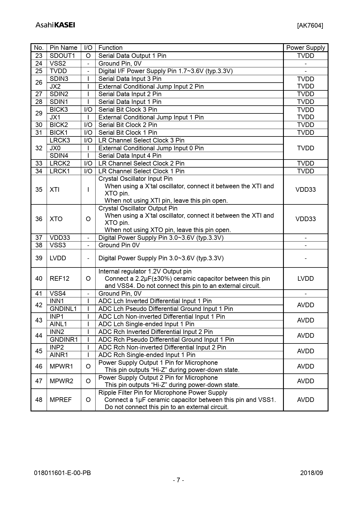

[AK7604]
No.
23
24
25 33
34 Pin Name
SDOUT1
VSS2
TVDD
SDIN3
JX2
SDIN2
SDIN1
BICK3
JX1
BICK2
BICK1
LRCK3
JX0
SDIN4
LRCK2
LRCK1 35 XTI I 36 XTO O 37
38 VDD33
VSS3 -Function
Serial Data Output 1 Pin
Ground Pin, 0V
Digital I/F Power Supply Pin 1.7~3.6V (typ.3.3V)
Serial Data Input 3 Pin
External Conditional Jump Input 2 Pin
Serial Data Input 2 Pin
Serial Data Input 1 Pin
Serial Bit Clock 3 Pin
External Conditional Jump Input 1 Pin
Serial Bit Clock 2 Pin
Serial Bit Clock 1 Pin
LR Channel Select Clock 3 Pin
External Conditional Jump Input 0 Pin
Serial Data Input 4 Pin
LR Channel Select Clock 2 Pin
LR Channel Select Clock 1 Pin
Crystal Oscillator Input Pin
When using a X’tal oscillator, connect it between the XTI and
XTO pin.
When not using XTI pin, leave this pin open.
Crystal Oscillator Output Pin
XTO pin.
When not using XTO pin, leave this pin open.
Digital Power Supply Pin 3.0~3.6V (typ.3.3V)
Ground Pin 0V 39 LVDD -Digital Power Supply Pin 3.0~3.6V (typ.3.3V) 40 REF12 O 41 VSS4
INN1
GNDINL1
INP1
AINL1
INN2
GNDINR1
INP2
AINR1 I
I
I
I
I
I
I
I 46 MPWR1 O 47 MPWR2 O 48 MPREF O 26
27
28
29
30
31
32 42
43
44
45 I/O
O
I
I
I
I
I/O
I
I/O
I/O
I/O
I
I
I/O
I/O Internal regulator 1.2V Output pin
Connect a 2.2µF(±30%) ceramic capacitor between this pin
and VSS4. Do not connect this pin to an external circuit.
Ground Pin, 0V
ADC Lch Inverted Differential Input 1 Pin
ADC Lch Pseudo Differential Ground Input 1 Pin
ADC Lch Non-inverted Differential Input 1 Pin
ADC Lch Single-ended Input 1 Pin
ADC Rch Inverted Differential Input 2 Pin
ADC Rch Pseudo Differential Ground Input 1 Pin
ADC Rch Non-inverted Differential Input 2 Pin
ADC Rch Single-ended Input 1 Pin
Power Supply Output 1 Pin for Microphone
This pin outputs “Hi-Z” during power-down state.
Power Supply Output 2 Pin for Microphone
Ripple Filter Pin for Microphone Power Supply
Connect a 1µF ceramic capacitor between this pin and VSS1.
Do not connect this pin to an external circuit. 018011601-E-00-PB Power Supply
TVDD
TVDD
TVDD
TVDD
TVDD
TVDD
TVDD
TVDD
TVDD
TVDD
TVDD
TVDD
VDD33 VDD33
LVDD
AVDD
AVDD
AVDD
AVDD
AVDD
AVDD
AVDD 2018/09
