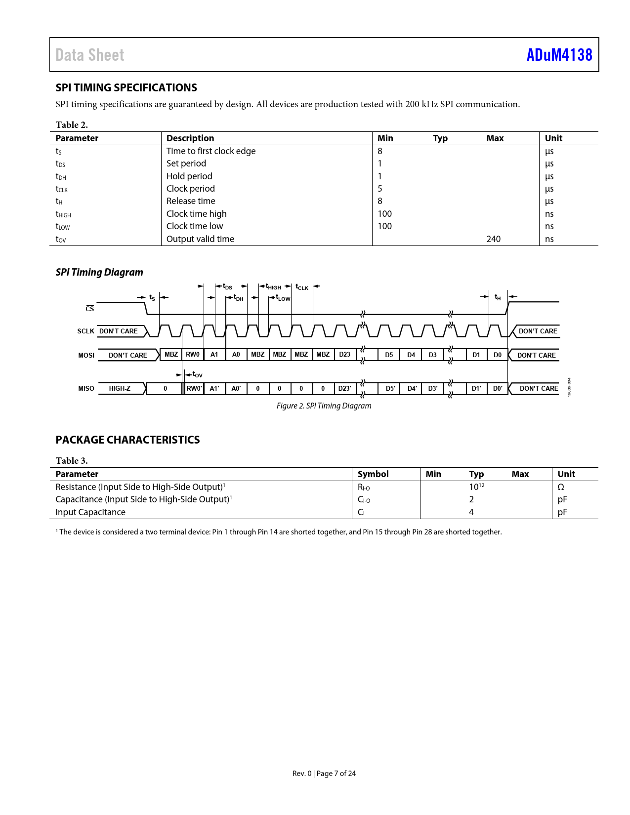

Data Sheet ADuM4138 SPI TIMING SPECIFICATIONS
SPI timing specifications are guaranteed by design. All devices are production tested with 200 kHz SPI communication.
Table 2. Parameter Description Min Typ Max Unit
tS Time to first clock edge 8 μs tDS Set period 1 μs tDH Hold period 1 μs tCLK Clock period 5 μs tH Release time 8 μs tHIGH Clock time high 100 ns tLOW Clock time low 100 ns tOV Output valid time 240 ns
SPI Timing Diagram tDS tHIGH tCLK t t t S DH tLOW H CS SCLK DON’T CARE DON’T CARE MOSI DON’T CARE MBZ RW0 A1 A0 MBZ MBZ MBZ MBZ D23 D5 D4 D3 D1 D0 DON’T CARE tOV
4 -00
MISO HIGH-Z 0 RW0′ A1′ A0′ 0 0 0 0 D23′ D5′ D4′ D3′ D1′ D0′ DON’T CARE
6 03 16 Figure 2. SPI Timing Diagram
