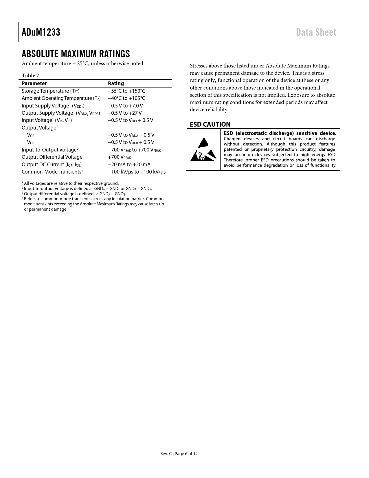

ADuM1233. Data Sheet. ABSOLUTE MAXIMUM RATINGS. Table 7. Parameter. Rating. ESD CAUTION
ADuM1233 Data Sheet ABSOLUTE MAXIMUM RATINGS Table 7 Parameter Rating ESD CAUTION
link to page 6 link to page 6 link to page 6
Ambient temperature = 25°C, unless otherwise noted. Stresses above those listed under Absolute Maximum Ratings
Table 7.
may cause permanent damage to the device. This is a stress
Parameter Rating
rating only; functional operation of the device at these or any other conditions above those indicated in the operational Storage Temperature (TST) −55°C to +150°C section of this specification is not implied. Exposure to absolute Ambient Operating Temperature (TA) −40°C to +105°C maximum rating conditions for extended periods may affect Input Supply Voltage1 (VDD1) −0.5 V to +7.0 V device reliability. Output Supply Voltage1 (VDDA, VDDB) −0.5 V to +27 V Input Voltage1 (VIA, VIB) −0.5 V to VDDI + 0.5 V
