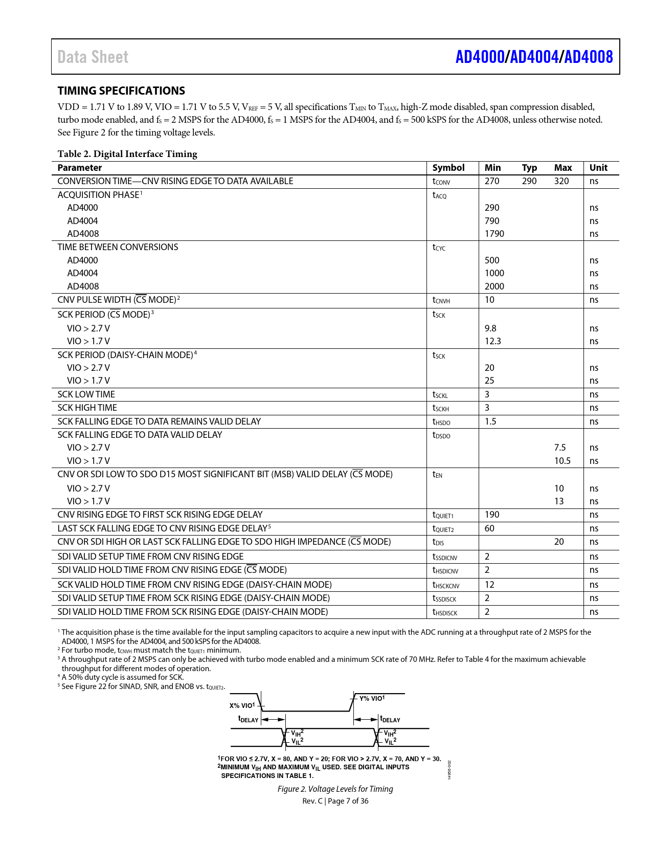

Data Sheet. AD4000/. AD4004/. AD4008. TIMING SPECIFICATIONS. Table 2. Digital Interface Timing Parameter. Symbol. Min. Typ. Max. Unit
Data Sheet AD4000/ AD4004/ AD4008 TIMING SPECIFICATIONS Table 2 Digital Interface Timing Parameter Symbol Min Typ Max Unit
link to page 7 link to page 8 link to page 13
VDD = 1.71 V to 1.89 V, VIO = 1.71 V to 5.5 V, VREF = 5 V, all specifications TMIN to TMAX, high-Z mode disabled, span compression disabled, turbo mode enabled, and fS = 2 MSPS for the AD4000, fS = 1 MSPS for the AD4004, and fS = 500 kSPS for the AD4008, unless otherwise noted. See Figure 2 for the timing voltage levels.
Table 2. Digital Interface Timing Parameter Symbol Min Typ Max Unit
CONVERSION TIME—CNV RISING EDGE TO DATA AVAILABLE tCONV 270 290 320 ns ACQUISITION PHASE1 tACQ AD4000 290 ns AD4004 790 ns AD4008 1790 ns TIME BETWEEN CONVERSIONS tCYC AD4000 500 ns AD4004 1000 ns AD4008 2000 ns CNV PULSE WIDTH (CS MODE)2 tCNVH 10 ns SCK PERIOD (CS MODE)3 tSCK VIO > 2.7 V 9.8 ns VIO > 1.7 V 12.3 ns SCK PERIOD (DAISY-CHAIN MODE)4 tSCK VIO > 2.7 V 20 ns VIO > 1.7 V 25 ns SCK LOW TIME tSCKL 3 ns SCK HIGH TIME tSCKH 3 ns SCK FALLING EDGE TO DATA REMAINS VALID DELAY tHSDO 1.5 ns SCK FALLING EDGE TO DATA VALID DELAY tDSDO VIO > 2.7 V 7.5 ns VIO > 1.7 V 10.5 ns CNV OR SDI LOW TO SDO D15 MOST SIGNIFICANT BIT (MSB) VALID DELAY (CS MODE) tEN VIO > 2.7 V 10 ns VIO > 1.7 V 13 ns CNV RISING EDGE TO FIRST SCK RISING EDGE DELAY tQUIET1 190 ns LAST SCK FALLING EDGE TO CNV RISING EDGE DELAY5 tQUIET2 60 ns CNV OR SDI HIGH OR LAST SCK FALLING EDGE TO SDO HIGH IMPEDANCE (CS MODE) tDIS 20 ns SDI VALID SETUP TIME FROM CNV RISING EDGE tSSDICNV 2 ns SDI VALID HOLD TIME FROM CNV RISING EDGE (CS MODE) tHSDICNV 2 ns SCK VALID HOLD TIME FROM CNV RISING EDGE (DAISY-CHAIN MODE) tHSCKCNV 12 ns SDI VALID SETUP TIME FROM SCK RISING EDGE (DAISY-CHAIN MODE) tSSDISCK 2 ns SDI VALID HOLD TIME FROM SCK RISING EDGE (DAISY-CHAIN MODE) tHSDISCK 2 ns 1 The acquisition phase is the time available for the input sampling capacitors to acquire a new input with the ADC running at a throughput rate of 2 MSPS for the AD4000, 1 MSPS for the AD4004, and 500 kSPS for the AD4008. 2 For turbo mode, tCNVH must match the tQUIET1 minimum. 3 A throughput rate of 2 MSPS can only be achieved with turbo mode enabled and a minimum SCK rate of 70 MHz. Refer to Table 4 for the maximum achievable throughput for different modes of operation. 4 A 50% duty cycle is assumed for SCK. 5 See Figure 22 for SINAD, SNR, and ENOB vs. tQUIET2.
Y% VIO1 X% VIO1 tDELAY tDELAY V 2 IH V 2 IH 2 V 2 VIL IL 1FOR VIO ≤ 2.7V, X = 80, AND Y = 20; FOR VIO > 2.7V, X = 70, AND Y = 30. 2MINIMUM V
002
IH AND MAXIMUM VIL USED. SEE DIGITAL INPUTS SPECIFICATIONS IN TABLE 1.
