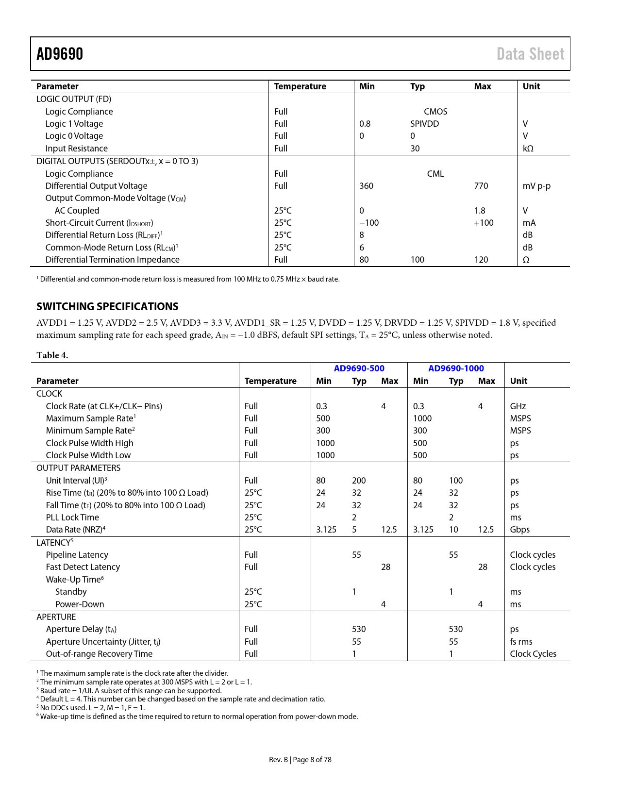

AD9690. Data Sheet. Parameter. Temperature. Min. Typ. Max. Unit. SWITCHING SPECIFICATIONS. Table 4. AD9690-500. AD9690-1000
AD9690 Data Sheet Parameter Temperature Min Typ Max Unit SWITCHING SPECIFICATIONS Table 4 AD9690-500 AD9690-1000
LOGIC OUTPUT (FD) Logic Compliance Full CMOS Logic 1 Voltage Full 0.8 SPIVDD V Logic 0 Voltage Full 0 0 V Input Resistance Full 30 kΩ DIGITAL OUTPUTS (SERDOUTx±, x = 0 TO 3) Logic Compliance Full CML Differential Output Voltage Full 360 770 mV p-p Output Common-Mode Voltage (VCM) AC Coupled 25°C 0 1.8 V Short-Circuit Current (IDSHORT) 25°C −100 +100 mA Differential Return Loss (RLDIFF)1 25°C 8 dB Common-Mode Return Loss (RLCM)1 25°C 6 dB Differential Termination Impedance Full 80 100 120 Ω 1 Differential and common-mode return loss is measured from 100 MHz to 0.75 MHz × baud rate.
AVDD1 = 1.25 V, AVDD2 = 2.5 V, AVDD3 = 3.3 V, AVDD1_SR = 1.25 V, DVDD = 1.25 V, DRVDD = 1.25 V, SPIVDD = 1.8 V, specified maximum sampling rate for each speed grade, AIN = −1.0 dBFS, default SPI settings, TA = 25°C, unless otherwise noted.
Table 4. AD9690-500 AD9690-1000 Parameter Temperature Min Typ Max Min Typ Max Unit
