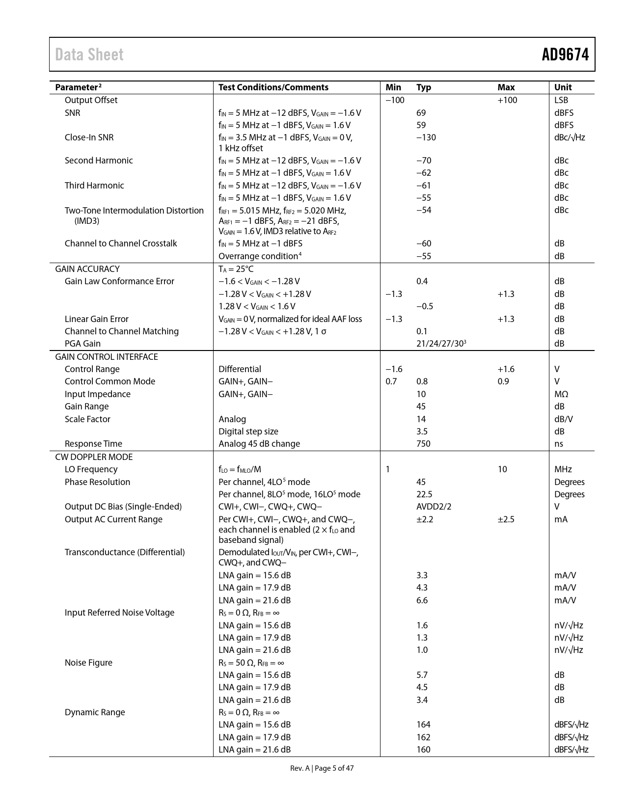

Data Sheet. AD9674. Parameter2. Test Conditions/Comments. Min. Typ. Max. Unit
Data Sheet AD9674 Parameter2 Test Conditions/Comments Min Typ Max Unit
link to page 6 link to page 6 link to page 6 link to page 6 link to page 6
Output Offset −100 +100 LSB SNR fIN = 5 MHz at −12 dBFS, VGAIN = −1.6 V 69 dBFS fIN = 5 MHz at −1 dBFS, VGAIN = 1.6 V 59 dBFS Close-In SNR fIN = 3.5 MHz at −1 dBFS, VGAIN = 0 V, −130 dBc/√Hz 1 kHz offset Second Harmonic fIN = 5 MHz at −12 dBFS, VGAIN = −1.6 V −70 dBc fIN = 5 MHz at −1 dBFS, VGAIN = 1.6 V −62 dBc Third Harmonic fIN = 5 MHz at −12 dBFS, VGAIN = −1.6 V −61 dBc fIN = 5 MHz at −1 dBFS, VGAIN = 1.6 V −55 dBc Two-Tone Intermodulation Distortion fRF1 = 5.015 MHz, fRF2 = 5.020 MHz, −54 dBc (IMD3) ARF1 = −1 dBFS, ARF2 = −21 dBFS, VGAIN = 1.6 V, IMD3 relative to ARF2 Channel to Channel Crosstalk fIN = 5 MHz at −1 dBFS −60 dB Overrange condition4 −55 dB GAIN ACCURACY TA = 25°C Gain Law Conformance Error −1.6 < VGAIN < −1.28 V 0.4 dB −1.28 V < VGAIN < +1.28 V −1.3 +1.3 dB 1.28 V < VGAIN < 1.6 V −0.5 dB Linear Gain Error VGAIN = 0 V, normalized for ideal AAF loss −1.3 +1.3 dB Channel to Channel Matching −1.28 V < VGAIN < +1.28 V, 1 σ 0.1 dB PGA Gain 21/24/27/303 dB GAIN CONTROL INTERFACE Control Range Differential −1.6 +1.6 V Control Common Mode GAIN+, GAIN− 0.7 0.8 0.9 V Input Impedance GAIN+, GAIN− 10 MΩ Gain Range 45 dB Scale Factor Analog 14 dB/V Digital step size 3.5 dB Response Time Analog 45 dB change 750 ns CW DOPPLER MODE LO Frequency fLO = fMLO/M 1 10 MHz Phase Resolution Per channel, 4LO5 mode 45 Degrees Per channel, 8LO5 mode, 16LO5 mode 22.5 Degrees Output DC Bias (Single-Ended) CWI+, CWI−, CWQ+, CWQ− AVDD2/2 V Output AC Current Range Per CWI+, CWI−, CWQ+, and CWQ−, ±2.2 ±2.5 mA each channel is enabled (2 × fLO and baseband signal) Transconductance (Differential) Demodulated IOUT/VIN, per CWI+, CWI−, CWQ+, and CWQ− LNA gain = 15.6 dB 3.3 mA/V LNA gain = 17.9 dB 4.3 mA/V LNA gain = 21.6 dB 6.6 mA/V Input Referred Noise Voltage RS = 0 Ω, RFB = ∞ LNA gain = 15.6 dB 1.6 nV/√Hz LNA gain = 17.9 dB 1.3 nV/√Hz LNA gain = 21.6 dB 1.0 nV/√Hz Noise Figure RS = 50 Ω, RFB = ∞ LNA gain = 15.6 dB 5.7 dB LNA gain = 17.9 dB 4.5 dB LNA gain = 21.6 dB 3.4 dB Dynamic Range RS = 0 Ω, RFB = ∞ LNA gain = 15.6 dB 164 dBFS/√Hz LNA gain = 17.9 dB 162 dBFS/√Hz LNA gain = 21.6 dB 160 dBFS/√Hz Rev. A | Page 5 of 47 Document Outline FEATURES APPLICATIONS GENERAL DESCRIPTION TABLE OF CONTENTS REVISION HISTORY FUNCTIONAL BLOCK DIAGRAM SPECIFICATIONS AC SPECIFICATIONS DIGITAL SPECIFICATIONS SWITCHING SPECIFICATIONS ADC Timing Diagram CW Doppler Timing Diagram ABSOLUTE MAXIMUM RATINGS THERMAL IMPEDANCE ESD CAUTION PIN CONFIGURATION AND FUNCTION DESCRIPTIONS TYPICAL PERFORMANCE CHARACTERISTICS TGC MODE CW DOPPLER MODE THEORY OF OPERATION TGC OPERATION Low Noise Amplifier (LNA) Active Impedance Matching LNA Noise CLNA Connection DC Offset Correction/High-Pass Filter Variable Gain Amplifier (VGA) Gain Control VGA Noise Antialiasing Filter (AAF) AAF/VGA Test Mode ADC Clock Input Considerations Clock Duty Cycle Considerations Clock Jitter Considerations Power Dissipation and Power-Down Mode Power and Ground Connection Recommendations Digital Outputs and Timing Digital Output Test Patterns SDIO Pin SCLK Pin CSB Pin RBIAS Pin VREF Pin General-Purpose Output Pins Chip Address Pins ANALOG TEST SIGNAL GENERATION CW DOPPLER OPERATION Quadrature Generation DIGITAL RF DECIMATOR VECTOR PROFILE RF DECIMATOR DC Offset Calibration Multiband AAF and Decimate by 2 High-Pass Filter DIGITAL TEST WAVEFORMS Waveform Generator Channel ID and Ramp Generator DIGITAL BLOCK POWER SAVING SCHEME SERIAL PORT INTERFACE (SPI) HARDWARE INTERFACE MEMORY MAP READING THE MEMORY MAP TABLE RESERVED LOCATIONS DEFAULT VALUES LOGIC LEVELS RECOMMENDED START-UP SEQUENCE MEMORY MAP REGISTER DESCRIPTIONS Transfer (Register 0x0FF) Profile Index and Manual TX_TRIG (Register 0x10C) OUTLINE DIMENSIONS ORDERING GUIDE
