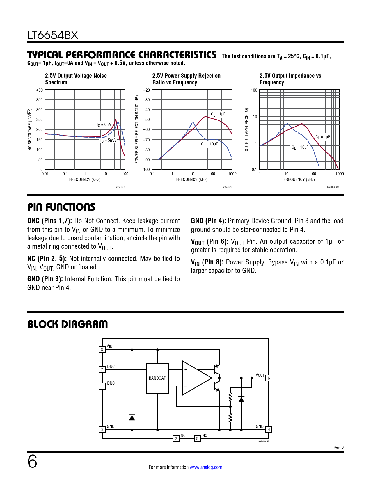

TYPICAL PERFORMANCE CHARACTERISTICS. The test conditions are TA = 25°C, CIN = 0.1μF,
TYPICAL PERFORMANCE CHARACTERISTICS The test conditions are TA = 25°C, CIN = 0.1μF,
LT6654BX
TYPICAL PERFORMANCE CHARACTERISTICS The test conditions are TA = 25°C, CIN = 0.1μF, COUT= 1μF, IOUT=0A and VIN = VOUT + 0.5V, unless otherwise noted. 2.5V Output Voltage Noise 2.5V Power Supply Rejection 2.5V Output Impedance vs Spectrum Ratio vs Frequency Frequency
400 –20 100 350 –30 ) 300 TIO (dB) –40 Hz CL = 1µF 10 250 –50 IO = 0µA TAGE (nV√ 200 –60 Y REJECTION RA C 150 I L = 1µF O = 5mA –70 CL = 10µF 1 NOISE VOL C 100 –80 OUTPUT IMPEDANCE (Ω) L = 10µF 50 –90 POWER SUPPL 0 –100 0.1 0.01 0.1 1 10 100 0.1 1 10 100 1000 1 10 100 1000 FREQUENCY (kHz) FREQUENCY (kHz) FREQUENCY (kHz) 6654 G18 6654 G20 6654BX G18
PIN FUNCTIONS DNC (Pins 1,7):
Do Not Connect. Keep leakage current
GND (Pin 4):
Primary Device Ground. Pin 3 and the load from this pin to VIN or GND to a minimum. To minimize ground should be star-connected to Pin 4. leakage due to board contamination, encircle the pin with
V
a metal ring connected to V
OUT (Pin 6):
VOUT Pin. An output capacitor of 1μF or OUT. greater is required for stable operation.
NC (Pin 2, 5):
Not internally connected. May be tied to
V
V
IN (Pin 8):
Power Supply. Bypass VIN with a 0.1μF or IN, VOUT, GND or floated. larger capacitor to GND.
GND (Pin 3):
Internal Function. This pin must be tied to GND near Pin 4.
BLOCK DIAGRAM
VIN 8 DNC 7 + VOUT BANDGAP 6 DNC 1 – GND GND 3 4 NC NC 2 5 6654BX BD Rev. 0 6 For more information www.analog.com Document Outline Features Applications Typical Application Description Absolute Maximum Ratings Order Information Pin Configuration Electrical Characteristics Typical Performance Characteristics Pin Functions Block Diagram Applications Information Package Description Typical Application Related Parts
