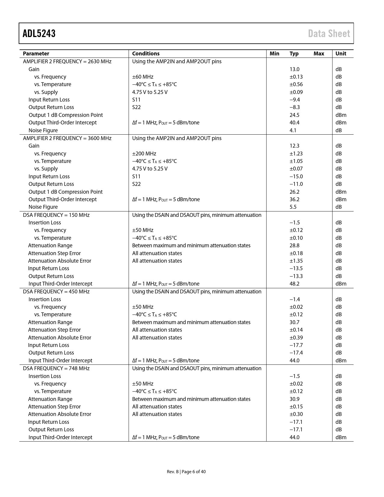

AMPLIFIER 2 FREQUENCY = 2630 MHz Using the AMP2IN and AMP2OUT pins Gain 13.0 dB vs. Frequency ±60 MHz ±0.13 dB vs. Temperature −40°C ≤ TA ≤ +85°C ±0.56 dB vs. Supply 4.75 V to 5.25 V ±0.09 dB Input Return Loss S11 −9.4 dB Output Return Loss S22 −8.3 dB Output 1 dB Compression Point 24.5 dBm Output Third-Order Intercept ∆f = 1 MHz, POUT = 5 dBm/tone 40.4 dBm Noise Figure 4.1 dB AMPLIFIER 2 FREQUENCY = 3600 MHz Using the AMP2IN and AMP2OUT pins Gain 12.3 dB vs. Frequency ±200 MHz ±1.23 dB vs. Temperature −40°C ≤ TA ≤ +85°C ±1.05 dB vs. Supply 4.75 V to 5.25 V ±0.07 dB Input Return Loss S11 −15.0 dB Output Return Loss S22 −11.0 dB Output 1 dB Compression Point 26.2 dBm Output Third-Order Intercept ∆f = 1 MHz, POUT = 5 dBm/tone 36.2 dBm Noise Figure 5.5 dB DSA FREQUENCY = 150 MHz Using the DSAIN and DSAOUT pins, minimum attenuation Insertion Loss −1.5 dB vs. Frequency ±50 MHz ±0.12 dB vs. Temperature −40°C ≤ TA ≤ +85°C ±0.10 dB Attenuation Range Between maximum and minimum attenuation states 28.8 dB Attenuation Step Error All attenuation states ±0.18 dB Attenuation Absolute Error All attenuation states ±1.35 dB Input Return Loss −13.5 dB Output Return Loss −13.3 dB Input Third-Order Intercept ∆f = 1 MHz, POUT = 5 dBm/tone 48.2 dBm DSA FREQUENCY = 450 MHz Using the DSAIN and DSAOUT pins, minimum attenuation Insertion Loss −1.4 dB vs. Frequency ±50 MHz ±0.02 dB vs. Temperature −40°C ≤ TA ≤ +85°C ±0.12 dB Attenuation Range Between maximum and minimum attenuation states 30.7 dB Attenuation Step Error All attenuation states ±0.14 dB Attenuation Absolute Error All attenuation states ±0.39 dB Input Return Loss −17.7 dB Output Return Loss −17.4 dB Input Third-Order Intercept ∆f = 1 MHz, POUT = 5 dBm/tone 44.0 dBm DSA FREQUENCY = 748 MHz Using the DSAIN and DSAOUT pins, minimum attenuation Insertion Loss −1.5 dB vs. Frequency ±50 MHz ±0.02 dB vs. Temperature −40°C ≤ TA ≤ +85°C ±0.12 dB Attenuation Range Between maximum and minimum attenuation states 30.9 dB Attenuation Step Error All attenuation states ±0.15 dB Attenuation Absolute Error All attenuation states ±0.30 dB Input Return Loss −17.1 dB Output Return Loss −17.1 dB Input Third-Order Intercept ∆f = 1 MHz, POUT = 5 dBm/tone 44.0 dBm Rev. B | Page 6 of 40 Document Outline Features Applications General Description Functional Block Diagram Revision History Specifications Absolute Maximum Ratings ESD Caution Pin Configuration and Function Descriptions Typical Performance Characteristics Applications Information Basic Layout Connections Amplifier 1 Power Supply Amplifier 1 RF Input Interface Amplifier 1 RF Output Interface Amplifier 2 Power Supply Amplifier 2 RF Input Interface Amplifier 2 RF Output Interface DSA RF Input Interface DSA RF Output Interface DSA SPI Interface SPI Timing SPI Timing Sequence ADL5243 Amplifier 2 Matching ADL5243 Loop Performance Proper Driving Level for the Optimum ACLR Thermal Considerations Soldering Information and Recommended PCB Land Pattern Evaluation Board Outline Dimensions Ordering Guide
