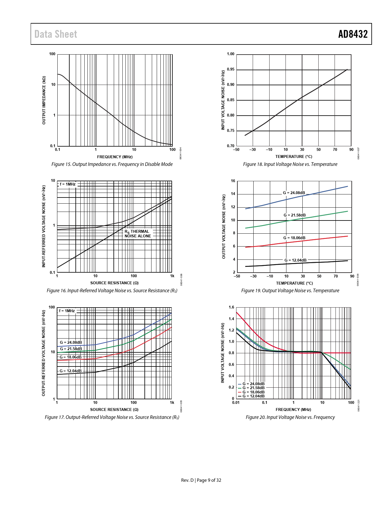

Pages / Page32 / 9 — Data Sheet. AD8432. 100. 1.00. ) 0.95. √Hz. (n 0.90. E IS O. DANC E. …
RevisionD
File Format / SizePDF / 892 Kb
Data Sheet. AD8432. 100. 1.00. ) 0.95. √Hz. (n 0.90. E IS O. DANC E. 0.85. I UT. LTA. O 0.80. PU IN 0.75. 0.1. 0.70. –50. –30. –10. FREQUENCY (MHz)
Data Sheet AD8432 100 1.00 ) 0.95 √Hz (n 0.90 E IS O DANC E 0.85 I UT LTA O 0.80 PU IN 0.75 0.1 0.70 –50 –30 –10 FREQUENCY (MHz)
Data Sheet AD8432 100 1.00 ) 0.95 ) √Hz kΩ V/ ( 10 E (n 0.90 E IS O DANC E N P 0.85 E M G I UT LTA P 1 O 0.80 V UT T O PU IN 0.75 0.1 0.70 0.1 1 10 100

34 08 08 Figure 15. Output Impedance vs. Frequency in Disable Mode Figure 18. Input Voltage Noise vs. Temperature
10 16 ) f = 1MHz √Hz G = 24.08dB V/ ) 14 E (n /√Hz IS V n 12 O ( E E N IS G = 21.58dB G 10 NO LTA 1 E G VO RS THERMAL 8 D LTA E NOISE ALONE O G = 18.06dB R R V E UT 6 F E P UT T-R O 4 PU G = 12.04dB IN 0.1 2 1 10 100 1k

34 08 08 Figure 16. Input-Referred Voltage Noise vs. Source Resistance (RS) Figure 19. Output Voltage Noise vs. Temperature
100 1.6 ) f = 1MHz √Hz V/ 1.4 n ) ISE ( √Hz 1.2 O V/ (n E N G G = 24.08dB 1.0 ISE O LTA G = 21.58dB 10 E N 0.8 VO G = 18.06dB G ED R LTA 0.6 ER G = 12.04dB VO T EF 0.4 -R PU T IN U G = 24.08dB P T 0.2 G = 21.58dB U G = 18.06dB O G = 12.04dB 1 0

34 08 08 Figure 17. Output-Referred Voltage Noise vs. Source Resistance (RS) Figure 20. Input Voltage Noise vs. Frequency Rev. D | Page 9 of 32 Document Outline FEATURES APPLICATIONS FUNCTIONAL BLOCK DIAGRAM GENERAL DESCRIPTION TABLE OF CONTENTS REVISION HISTORY SPECIFICATIONS ABSOLUTE MAXIMUM RATINGS THERMAL RESISTANCE MAXIMUM POWER DISSIPATION ESD CAUTION PIN CONFIGURATION AND FUNCTION DESCRIPTIONS TYPICAL PERFORMANCE CHARACTERISTICS TEST CIRCUITS THEORY OF OPERATION LOW NOISE AMPLIFIER (LNA) GAIN SETTING TECHNIQUE ACTIVE INPUT RESISTANCE MATCHING APPLICATIONS INFORMATION TYPICAL SETUP I/Q DEMODULATION FRONT END DIFFERENTIAL-TO-SINGLE-ENDED CONVERSION EVALUATION BOARD CONNECTION AND OPERATION Power Supply Input Termination Setting the Amplifier Gain Output SCHEMATIC OUTLINE DIMENSIONS ORDERING GUIDE NOTES NOTES NOTES
