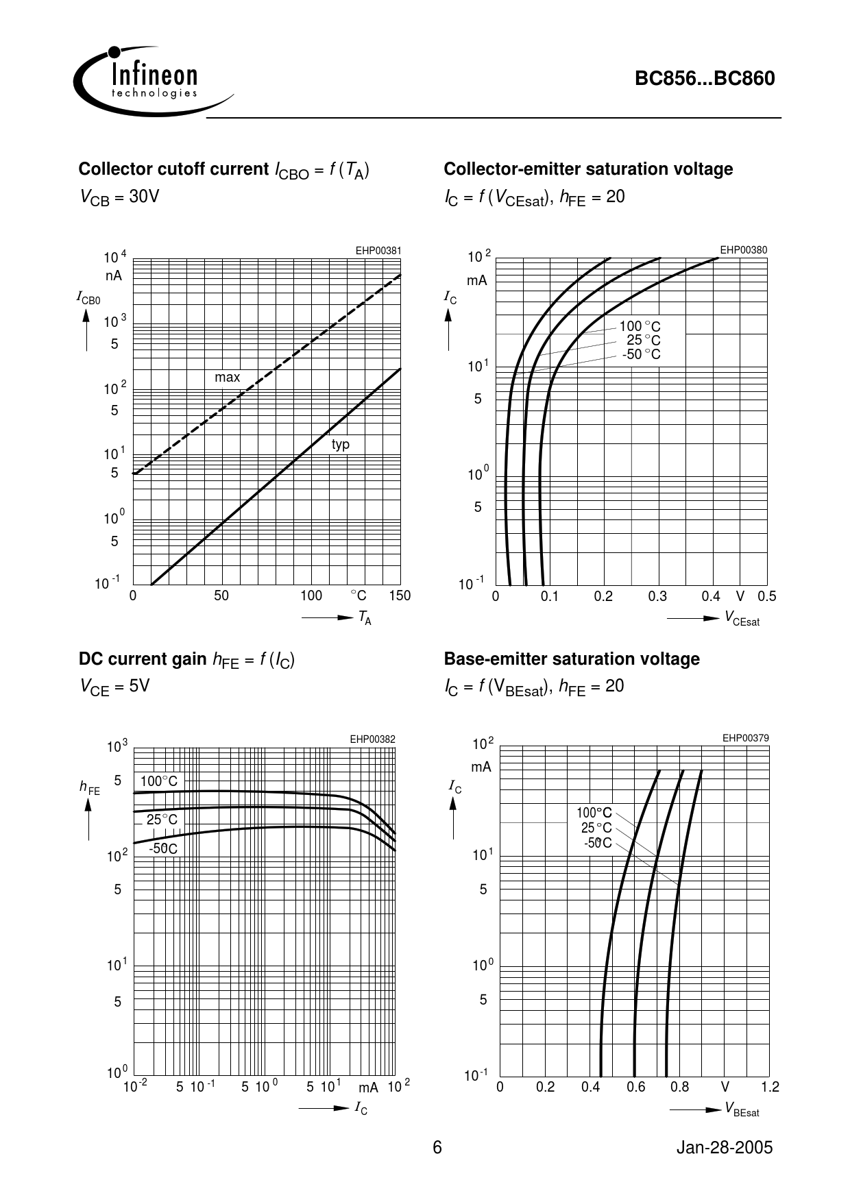

BC856...BC860. Collector cutoff current. Collector-emitter saturation voltage. DC current gain. Base-emitter saturation voltage
BC856...BC860 Collector cutoff current Collector-emitter saturation voltage DC current gain Base-emitter saturation voltage
ICBO = f (TA)
VCB = 30V IC = f (VCEsat), hFE = 20 EHP00381 EHP00380 10 4 10 2 nA mA Ι Ι CB0 C 10 3 100 C 5 25 C -50 C 101 max 10 2 5 5 typ 10 1 5 0 10 0 5 10 5 10 -1 10 -1 0 50 100 C 150 0 0.1 0.2 0.3 0.4 V 0.5 T V A CEsat
DC current gain
hFE = f (IC)
