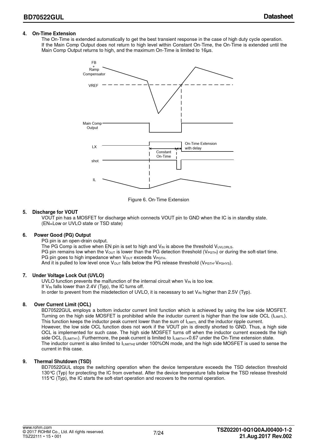

BD70522GUL 4. On-Time Extension
The On-Time is extended automatically to get the best transient response in the case of high duty cycle operation. If the Main Comp Output does not return to high level within Constant On-Time, the On-Time is extended until the Main Comp Output returns to high, and the maximum On-Time is limited to 16μs. FB + Ramp Compensator VREF Main Comp Output On-Time Extension LX with delay Constant On-Time shot IL Figure 6. On-Time Extension
5. Discharge for VOUT
VOUT pin has a MOSFET for discharge which connects VOUT pin to GND when the IC is in standby state. (EN=Low or UVLO state or TSD state)
6. Power Good (PG) Output
PG pin is an open-drain output. The PG Comp is active when EN pin is set to high and VIN is above the threshold VUVLORLS. PG pin remains low when the VOUT is lower than the PG detection threshold (VPGTH) or during the soft-start time. PG pin goes to high impedance when VOUT exceeds VPGTH. And it is pulled to low level once VOUT falls below the PG release threshold (VPGTH-VPGHYS).
7. Under Voltage Lock Out (UVLO)
UVLO function prevents the malfunction of the internal circuit when VIN is too low. If VIN falls lower than 2.4V (Typ), the IC turns off. In order to prevent from the misdetection of UVLO, it is necessary to set VIN higher than 2.5V (Typ).
8. Over Current Limit (OCL)
BD70522GUL employs a bottom inductor current limit function which is achieved by using the low side MOSFET. Turning on the high side MOSFET is prohibited while the inductor current is higher than the low side OCL (ILIMITL). This function keeps the inductor peak current lower than the sum of ILIMITL and the inductor ripple current. However, the low side OCL function does not work if the VOUT pin is directly shorted to GND. Thus, a high side OCL is implemented for such case. The high side MOSFET turns off when the inductor current exceeds the high side OCL (ILIMITH1). Furthermore, the peak current is limited to ILIMITH1×0.67 under the On-Time extension state. The inductor current is also limited to ILIMITH2 under 100%ON mode, and the high side MOSFET is used to sense the current in this case.
9. Thermal Shutdown (TSD)
BD70522GUL stops the switching operation when the device temperature exceeds the TSD detection threshold 130°C (Typ) for protecting the IC from overheat. After the device temperature falls below the TSD release threshold 115°C (Typ), the IC starts the soft-start operation and recovers to the normal operation. www.rohm.com
