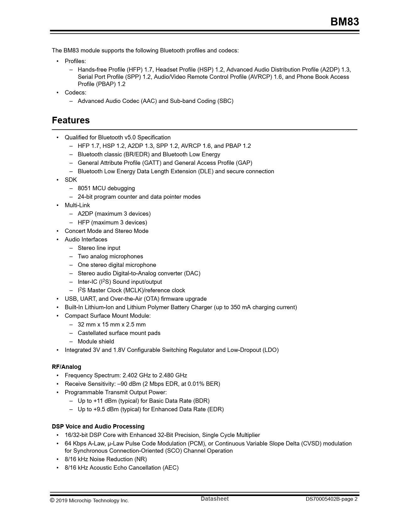

The BM83 module supports the following Bluetooth profiles and codecs: • Profiles: – Hands-free Profile (HFP) 1.7, Headset Profile (HSP) 1.2, Advanced Audio Distribution Profile (A2DP) 1.3, Serial Port Profile (SPP) 1.2, Audio/Video Remote Control Profile (AVRCP) 1.6, and Phone Book Access Profile (PBAP) 1.2 • Codecs: – Advanced Audio Codec (AAC) and Sub-band Coding (SBC)
Features
• Qualified for Bluetooth v5.0 Specification – HFP 1.7, HSP 1.2, A2DP 1.3, SPP 1.2, AVRCP 1.6, and PBAP 1.2 – Bluetooth classic (BR/EDR) and Bluetooth Low Energy – General Attribute Profile (GATT) and General Access Profile (GAP) – Bluetooth Low Energy Data Length Extension (DLE) and secure connection • SDK – 8051 MCU debugging – 24-bit program counter and data pointer modes • Multi-Link – A2DP (maximum 3 devices) – HFP (maximum 3 devices) • Concert Mode and Stereo Mode • Audio Interfaces – Stereo line input – Two analog microphones – One stereo digital microphone – Stereo audio Digital-to-Analog converter (DAC) – Inter-IC (I2S) Sound input/output – I2S Master Clock (MCLK)/reference clock • USB, UART, and Over-the-Air (OTA) firmware upgrade • Built-In Lithium-Ion and Lithium Polymer Battery Charger (up to 350 mA charging current) • Compact Surface Mount Module: – 32 mm x 15 mm x 2.5 mm – Castellated surface mount pads – Module shield • Integrated 3V and 1.8V Configurable Switching Regulator and Low-Dropout (LDO)
RF/Analog
• Frequency Spectrum: 2.402 GHz to 2.480 GHz • Receive Sensitivity: –90 dBm (2 Mbps EDR, at 0.01% BER) • Programmable Transmit Output Power: – Up to +11 dBm (typical) for Basic Data Rate (BDR) – Up to +9.5 dBm (typical) for Enhanced Data Rate (EDR)
DSP Voice and Audio Processing
• 16/32-bit DSP Core with Enhanced 32-Bit Precision, Single Cycle Multiplier • 64 Kbps A-Law, µ-Law Pulse Code Modulation (PCM), or Continuous Variable Slope Delta (CVSD) modulation for Synchronous Connection-Oriented (SCO) Channel Operation • 8/16 kHz Noise Reduction (NR) • 8/16 kHz Acoustic Echo Cancellation (AEC) © 2019 Microchip Technology Inc.
