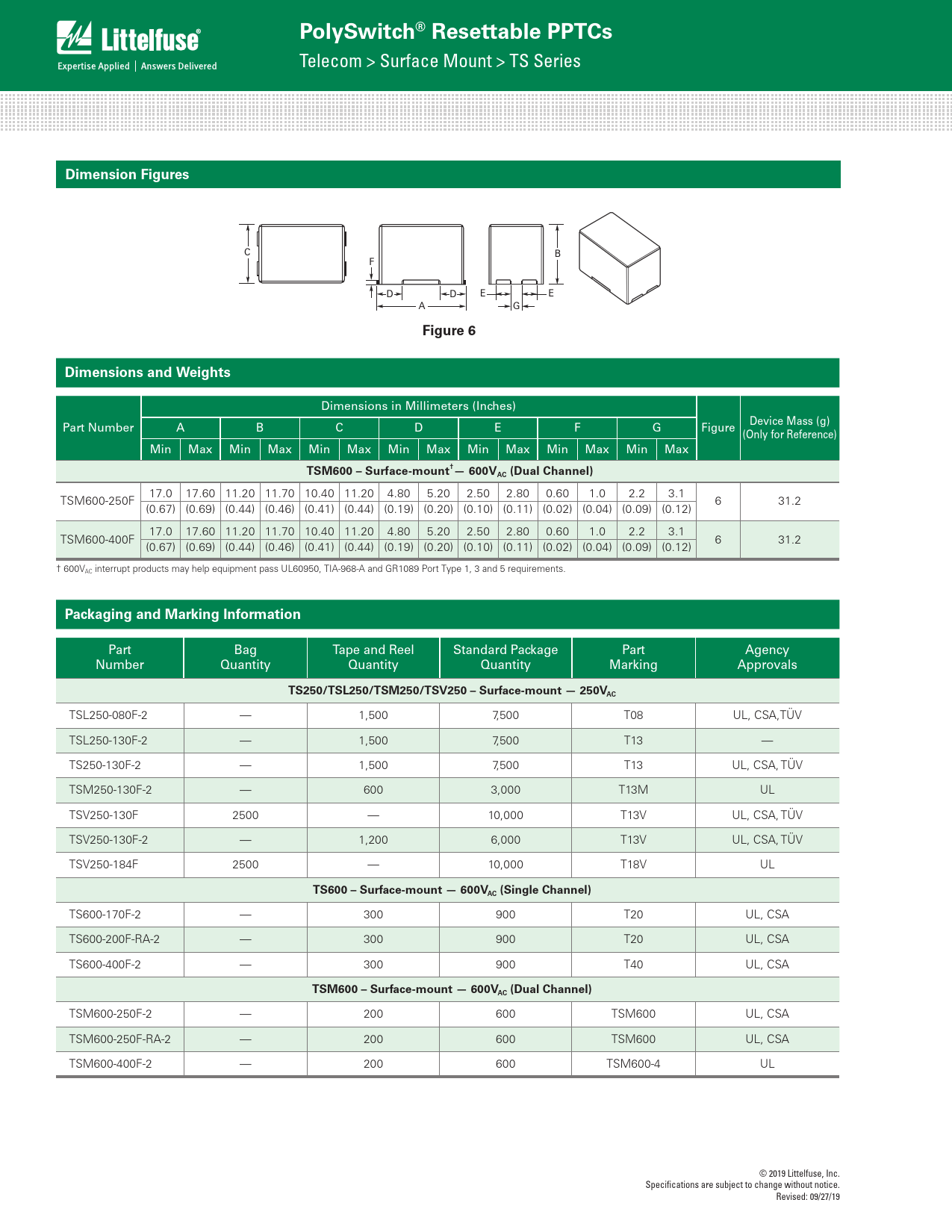

Pages / Page11 / 7 — PolySwitch® Resettable PPTCs. Dimension Figures. Figure 6. Dimensions and …
PolySwitch® Resettable PPTCs. Dimension Figures. Figure 6. Dimensions and Weights
PolySwitch® Resettable PPTCs Dimension Figures Figure 6 Dimensions and Weights
A C C C B D B F E E D D B
A D Telecom > Surface Mount > TS Series E A
Dimension Figures
C C B F B F D D E E A G E D
Figure 6
A
Dimensions in Millimeters (Inches) Device Mass (g) Part Number A B C D E F G Figure (Only for Reference) Min Max Min Max Min Max Min Max Min Max Min Max Min Max
TSM600 – Surface-mount†— 600VAC (Dual Channel)
17.0 17.60 11.20 11.70 10.40 11.20 4.80 5.20 2.50 2.80 0.60 1.0 2.2 3.1 TSM600-250F 6 31.2 (0.67) (0.69) (0.44) (0.46) (0.41) (0.44) (0.19) (0.20) (0.10) (0.11) (0.02) (0.04) (0.09) (0.12) 17.0 17.60 11.20 11.70 10.40 11.20 4.80 5.20 2.50 2.80 0.60 1.0 2.2 3.1 TSM600-400F 6 31.2 (0.67) (0.69) (0.44) (0.46) (0.41) (0.44) (0.19) (0.20) (0.10) B (0.11) (0.02) (0.04) (0.09) (0.12) E † 600VAC interrupt products may help equipment pass UL60950, TIA-968-A and GR1089 Port Type 1, 3 and 5 requirements. D A C
Packaging and Marking Information
Part Bag Tape and Reel Standard Package Part Agency Number Quantity Quantity Quantity Marking Approvals
TS250/TSL250/TSM250/TSV250 – Surface-mount — 250VAC
TSL250-080F-2 — 1,500 7,500 T08 UL, CSA,TÜV TSL250-130F-2 — 1,500 7,500 T13 — TS250-130F-2 — 1,500 7,500 T13 UL, CSA, TÜV TSM250-130F-2 — 600 3,000 T13M UL TSV250-130F 2500 — 10,000 T13V UL, CSA, TÜV TSV250-130F-2 — 1,200 6,000 T13V UL, CSA, TÜV TSV250-184F 2500 — 10,000 T18V UL
TS600 – Surface-mount — 600VAC (Single Channel)
TS600-170F-2 — 300 900 T20 UL, CSA TS600-200F-RA-2 — 300 900 T20 UL, CSA TS600-400F-2 — 300 900 T40 UL, CSA
TSM600 – Surface-mount — 600VAC (Dual Channel)
TSM600-250F-2 — 200 600 TSM600 UL, CSA TSM600-250F-RA-2 — 200 600 TSM600 UL, CSA TSM600-400F-2 — 200 600 TSM600-4 UL © 2019 Littelfuse, Inc. Specifications are subject to change without notice. Revised: 09/27/19
