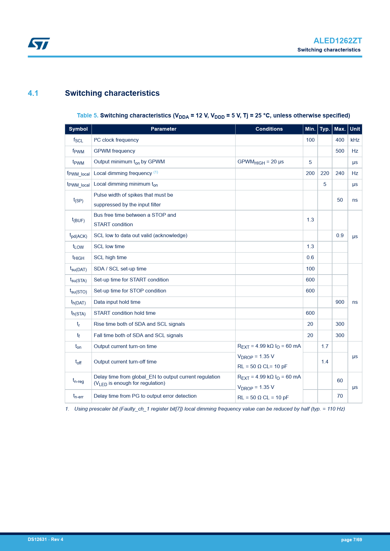

ALED1262ZT. Switching characteristics. 4.1
ALED1262ZT Switching characteristics 4.1
link to page 7
ALED1262ZT Switching characteristics 4.1 Switching characteristics Table 5. Switching characteristics (VDDA = 12 V, VDDD = 5 V, Tj = 25 °C, unless otherwise specified) Symbol Parameter Conditions Min. Typ. Max. Unit
fSCL I²C clock frequency 100 400 kHz fPWM GPWM frequency 500 Hz tPWM Output minimum ton by GPWM GPWMHIGH = 20 µs 5 µs fPWM_local Local dimming frequency (1) 200 220 240 Hz tPWM_local Local dimming minimum ton 5 µs Pulse width of spikes that must be t(SP) 50 ns suppressed by the input filter Bus free time between a STOP and t(BUF) 1.3 START condition tpd(ACK) SCL low to data out valid (acknowledge) 0.9 µs tLOW SCL low time 1.3 tHIGH SCL high time 0.6 tsu(DAT) SDA / SCL set-up time 100 tsu(STA) Set-up time for START condition 600 tsu(STO) Set-up time for STOP condition 600 th(DAT) Data input hold time 900 ns th(STA) START condition hold time 600 tr Rise time both of SDA and SCL signals 20 300 tf Fall time both of SDA and SCL signals 20 300 ton Output current turn-on time REXT = 4.99 kΩ IO = 60 mA 1.7 VDROP = 1.35 V µs toff Output current turn-off time 1.4 RL = 50 Ω CL= 10 pF Delay time from global_EN to output current regulation R t EXT = 4.99 kΩ IO = 60 mA n-reg (V 60 LED is enough for regulation) VDROP = 1.35 V µs tn-err Delay time from PG to output error detection RL = 50 Ω CL = 10 pF 70 1. Using prescaler bit (Faulty_ch_1 register bit[7]) local dimming frequency value can be reduced by half (typ. = 110 Hz)
