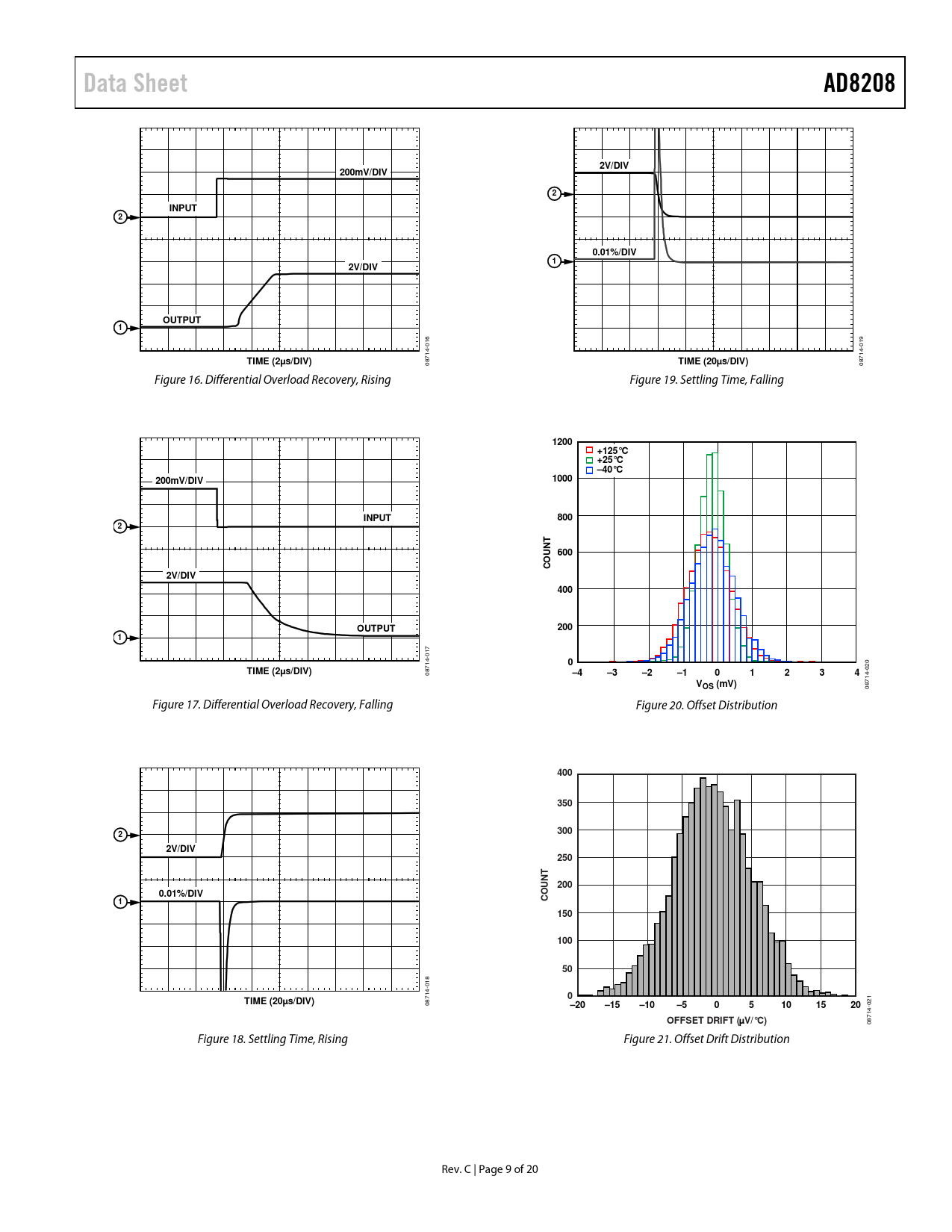

Data Sheet. AD8208. 2V/DIV. 200mV/DIV. INPUT. 0.01%/DIV. OUTPUT. TIME (2µs/DIV). TIME (20µs/DIV). 1200. +125°C +25°C –40°C. 1000. 800. UNT 600. 400
Data Sheet AD8208 2V/DIV 200mV/DIV INPUT 0.01%/DIV OUTPUT TIME (2µs/DIV) TIME (20µs/DIV) 1200 +125°C +25°C –40°C 1000 800 UNT 600 400
Data Sheet AD8208 2V/DIV 200mV/DIV 2 INPUT 2 0.01%/DIV 1 2V/DIV OUTPUT 1
016 019
TIME (2µs/DIV)
08714-
TIME (20µs/DIV)
08714- Figure 16. Differential Overload Recovery, Rising Figure 19. Settling Time, Falling
1200 +125°C +25°C –40°C 200mV/DIV 1000 INPUT 800 2 UNT 600 CO 2V/DIV 400 OUTPUT 200 1
017
0 TIME (2µs/DIV)
020 08714-
–4 –3 –2 –1 0 1 2 3 4 VOS (mV)
08714- Figure 17. Differential Overload Recovery, Falling Figure 20. Offset Distribution
400 350 2 300 2V/DIV 250 UNT 200 0.01%/DIV 1 CO 150 100 50
018
0 TIME (20µs/DIV)
08714-
–20 –15 –10 –5 0 5 10 15 20
021
OFFSET DRIFT (µV/°C)
08714- Figure 18. Settling Time, Rising Figure 21. Offset Drift Distribution Rev. C | Page 9 of 20 Document Outline Features Applications Functional Block Diagram General Description Revision History Specifications Absolute Maximum Ratings ESD Caution Pin Configuration and Function Descriptions Typical Performance Characteristics Theory of Operation Applications Information High-Side Current Sensing with a Low-Side Switch High-Rail Current Sensing Low-Side Current Sensing 4 mA to 20 mA Current Loop Receiver Gain Adjustment Gains Less than 20 Gains Greater than 20 Gain Trim Internal Signal Overload Considerations Low-Pass Filtering High Line Current Sensing with LPF and Gain Adjustment Outline Dimensions Ordering Guide Automotive Products
