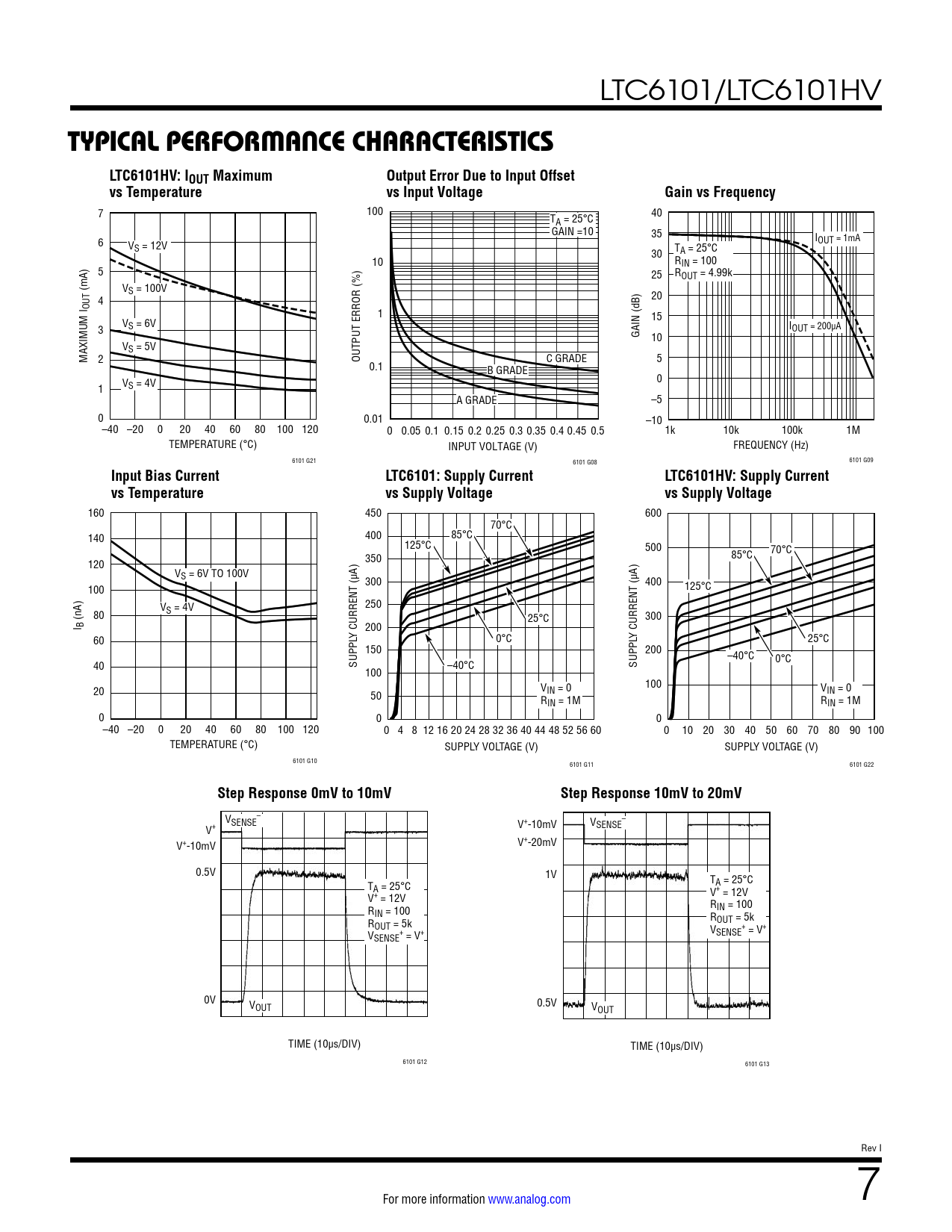

Pages / Page22 / 7 — TYPICAL PERFORMANCE CHARACTERISTICS. LTC6101HV: IOUT Maximum. Output …
RevisionI
File Format / SizePDF / 472 Kb
TYPICAL PERFORMANCE CHARACTERISTICS. LTC6101HV: IOUT Maximum. Output Error Due to Input Offset. vs Temperature
TYPICAL PERFORMANCE CHARACTERISTICS LTC6101HV: IOUT Maximum Output Error Due to Input Offset vs Temperature
LTC6101/LTC6101HV
TYPICAL PERFORMANCE CHARACTERISTICS LTC6101HV: IOUT Maximum Output Error Due to Input Offset vs Temperature vs Input Voltage Gain vs Frequency
7 100 40 TA = 25°C GAIN =10 35 IOUT = 1mA 6 VS = 12V 30 TA = 25°C 10 RIN = 100 5 25 ROUT = 4.99k (mA) VS = 100V 20 4 OUT 1 15 VS = 6V I 3 GAIN (dB) OUT = 200µA 10 VS = 5V MAXIMUM I 2 OUTPUT ERROR (%) C GRADE 5 0.1 B GRADE 0 1 VS = 4V A GRADE –5 0 0.01 –10 –40 –20 0 20 40 60 80 100 120 0 0.05 0.1 0.15 0.2 0.25 0.3 0.35 0.4 0.45 0.5 1k 10k 100k 1M TEMPERATURE (°C) INPUT VOLTAGE (V) FREQUENCY (Hz) 6101 G21 6101 G09 6101 G08
Input Bias Current LTC6101: Supply Current LTC6101HV: Supply Current vs Temperature vs Supply Voltage vs Supply Voltage
160 450 600 70°C 400 85°C 140 125°C 500 70°C 350 85°C 120 VS = 6V TO 100V 300 400 100 125°C 250 V 80 S = 4V (nA) 25°C 300 I B 200 Y CURRENT (µA) 60 0°C Y CURRENT (µA) 25°C 150 200 –40°C SUPPL 0°C 40 –40°C SUPPL 100 V 100 20 V 50 IN = 0 IN = 0 RIN = 1M RIN = 1M 0 0 0 –40 –20 0 20 40 60 80 100 120 0 4 8 12 16 20 24 28 32 36 40 44 48 52 56 60 0 10 20 30 40 50 60 70 80 90 100 TEMPERATURE (°C) SUPPLY VOLTAGE (V) SUPPLY VOLTAGE (V) 6101 G10 6101 G11 6101 G22
Step Response 0mV to 10mV Step Response 10mV to 20mV
