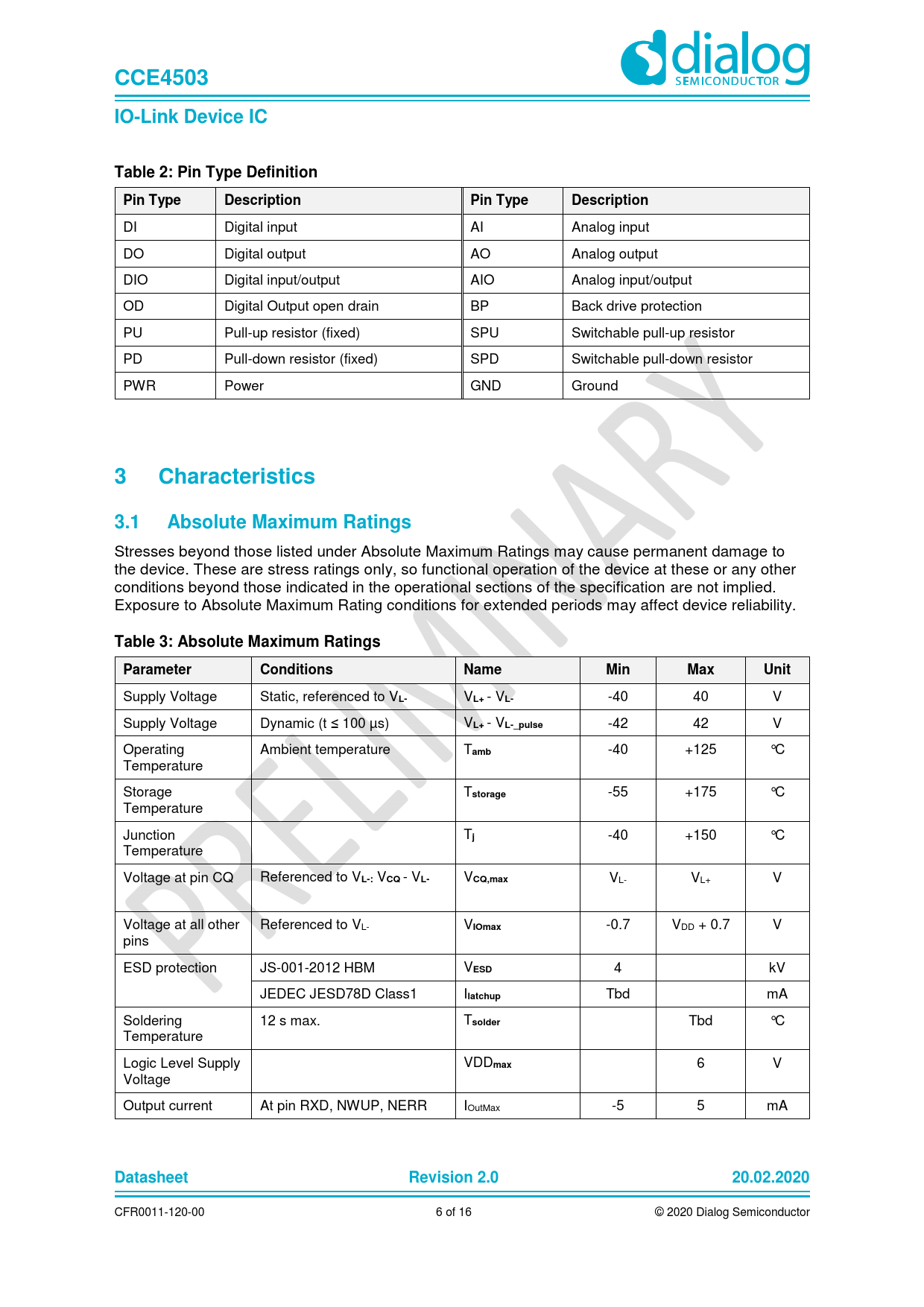

CCE4503. IO-Link Device IC. Table 2: Pin Type Definition. Pin Type. Description. Characteristics. 3.1. Absolute Maximum Ratings
CCE4503 IO-Link Device IC Table 2: Pin Type Definition Pin Type Description Characteristics 3.1 Absolute Maximum Ratings
CCE4503 IO-Link Device IC Table 2: Pin Type Definition Pin Type Description Pin Type Description
DI Digital input AI Analog input DO Digital output AO Analog output DIO Digital input/output AIO Analog input/output OD Digital Output open drain BP Back drive protection PU Pull-up resistor (fixed) SPU Switchable pull-up resistor PD Pull-down resistor (fixed) SPD Switchable pull-down resistor PWR Power GND Ground
3 Characteristics 3.1 Absolute Maximum Ratings
Stresses beyond those listed under Absolute Maximum Ratings may cause permanent damage to the device. These are stress ratings only, so functional operation of the device at these or any other conditions beyond those indicated in the operational sections of the specification are not implied. Exposure to Absolute Maximum Rating conditions for extended periods may affect device reliability.
Table 3: Absolute Maximum Ratings Parameter Conditions Name Min Max Unit
Supply Voltage Static, referenced to V
L-
V
L+
- V
L-
-40 40 V Supply Voltage Dynamic (t ≤ 100 µs) V
L+
- V
L-_pulse
-42 42 V Operating Ambient temperature T
amb
-40 +125 °C Temperature Storage T
storage
-55 +175 °C Temperature Junction T
j
-40 +150 °C Temperature Voltage at pin CQ Referenced to V
L-:
V
CQ
- V
L-
V
CQ,max
VL- VL+ V Voltage at all other Referenced to VL- V
IOmax
-0.7 VDD + 0.7 V pins ESD protection JS-001-2012 HBM V
ESD
4 kV JEDEC JESD78D Class1 I
latchup
Tbd mA Soldering 12 s max. T
solder
Tbd °C Temperature Logic Level Supply VDD
max
6 V Voltage Output current At pin RXD, NWUP, NERR IOutMax -5 5 mA
