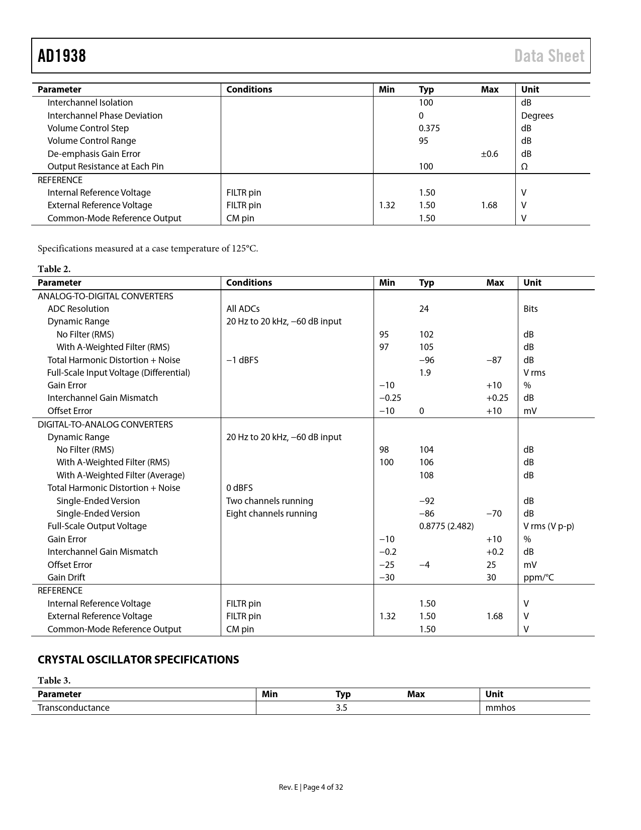

AD1938. Data Sheet. Parameter. Conditions. Min. Typ. Max. Unit. Table 2. Parameter. CRYSTAL OSCILLATOR SPECIFICATIONS. Table 3. Parameter
AD1938 Data Sheet Parameter Conditions Min Typ Max Unit Table 2 Parameter CRYSTAL OSCILLATOR SPECIFICATIONS Table 3 Parameter
Interchannel Isolation 100 dB Interchannel Phase Deviation 0 Degrees Volume Control Step 0.375 dB Volume Control Range 95 dB De-emphasis Gain Error ±0.6 dB Output Resistance at Each Pin 100 Ω REFERENCE Internal Reference Voltage FILTR pin 1.50 V External Reference Voltage FILTR pin 1.32 1.50 1.68 V Common-Mode Reference Output CM pin 1.50 V Specifications measured at a case temperature of 125°C.
Table 2. Parameter Conditions Min Typ Max Unit
ANALOG-TO-DIGITAL CONVERTERS ADC Resolution All ADCs 24 Bits Dynamic Range 20 Hz to 20 kHz, −60 dB input No Filter (RMS) 95 102 dB With A-Weighted Filter (RMS) 97 105 dB Total Harmonic Distortion + Noise −1 dBFS −96 −87 dB Full-Scale Input Voltage (Differential) 1.9 V rms Gain Error −10 +10 % Interchannel Gain Mismatch −0.25 +0.25 dB Offset Error −10 0 +10 mV DIGITAL-TO-ANALOG CONVERTERS Dynamic Range 20 Hz to 20 kHz, −60 dB input No Filter (RMS) 98 104 dB With A-Weighted Filter (RMS) 100 106 dB With A-Weighted Filter (Average) 108 dB Total Harmonic Distortion + Noise 0 dBFS Single-Ended Version Two channels running −92 dB Single-Ended Version Eight channels running −86 −70 dB Full-Scale Output Voltage 0.8775 (2.482) V rms (V p-p) Gain Error −10 +10 % Interchannel Gain Mismatch −0.2 +0.2 dB Offset Error −25 −4 25 mV Gain Drift −30 30 ppm/°C REFERENCE Internal Reference Voltage FILTR pin 1.50 V External Reference Voltage FILTR pin 1.32 1.50 1.68 V Common-Mode Reference Output CM pin 1.50 V
CRYSTAL OSCILLATOR SPECIFICATIONS Table 3. Parameter Min Typ Max Unit
Transconductance 3.5 mmhos Rev. E | Page 4 of 32 Document Outline Features Applications General Description Functional Block Diagram Revision History Specifications Test Conditions Analog Performance Specifications Crystal Oscillator Specifications Digital Input/Output Specifications Power Supply Specifications Digital Filters Timing Specifications Absolute Maximum Ratings Thermal Resistance ESD Caution Pin Configuration and Function Descriptions Typical Performance Characteristics Theory of Operation Analog-to-Digital Converters (ADCs) Digital-to-Analog Converters (DACs) Clock Signals Reset and Power-Down Serial Control Port Power Supply and Voltage Reference Serial Data Ports—Data Format Time-Division Multiplexed (TDM) Modes Daisy-Chain Mode Control Registers Definitions PLL and Clock Control Registers DAC Control Registers ADC Control Registers Additional Modes Applications Circuits Outline Dimensions Ordering Guide Automotive Products
