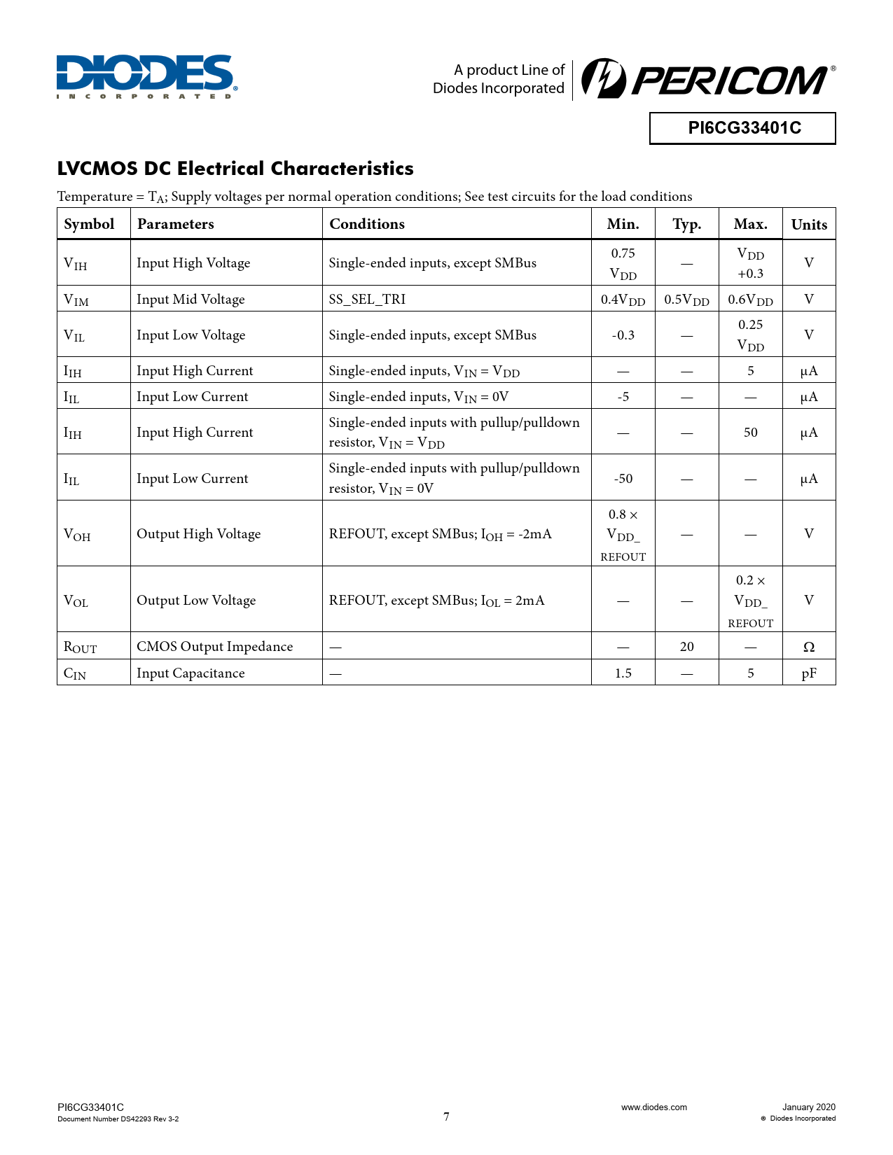

PI6CG33401C LVCMOS DC Electrical Characteristics
Temperature = TA; Supply voltages per normal operation conditions; See test circuits for the load conditions
Symbol Parameters Conditions Min. Typ. Max. Units
0.75 V V DD IH Input High Voltage Single-ended inputs, except SMBus — V VDD +0.3 VIM Input Mid Voltage SS_SEL_TRI 0.4VDD 0.5VDD 0.6VDD V 0.25 VIL Input Low Voltage Single-ended inputs, except SMBus -0.3 — V VDD IIH Input High Current Single-ended inputs, VIN = VDD — — 5 µA IIL Input Low Current Single-ended inputs, VIN = 0V -5 — — µA Single-ended inputs with pullup/pulldown IIH Input High Current — — 50 µA resistor, VIN = VDD Single-ended inputs with pullup/pulldown IIL Input Low Current -50 — — µA resistor, VIN = 0V 0.8 × VOH Output High Voltage REFOUT, except SMBus; IOH = -2mA VDD_ — — V REFOUT 0.2 × VOL Output Low Voltage REFOUT, except SMBus; IOL = 2mA — — VDD_ V REFOUT ROUT CMOS Output Impedance — — 20 — W CIN Input Capacitance — 1.5 — 5 pF PI6CG33401C www.diodes.com January 2020 Document Number DS42293 Rev 3-2 7 Diodes Incorporated
