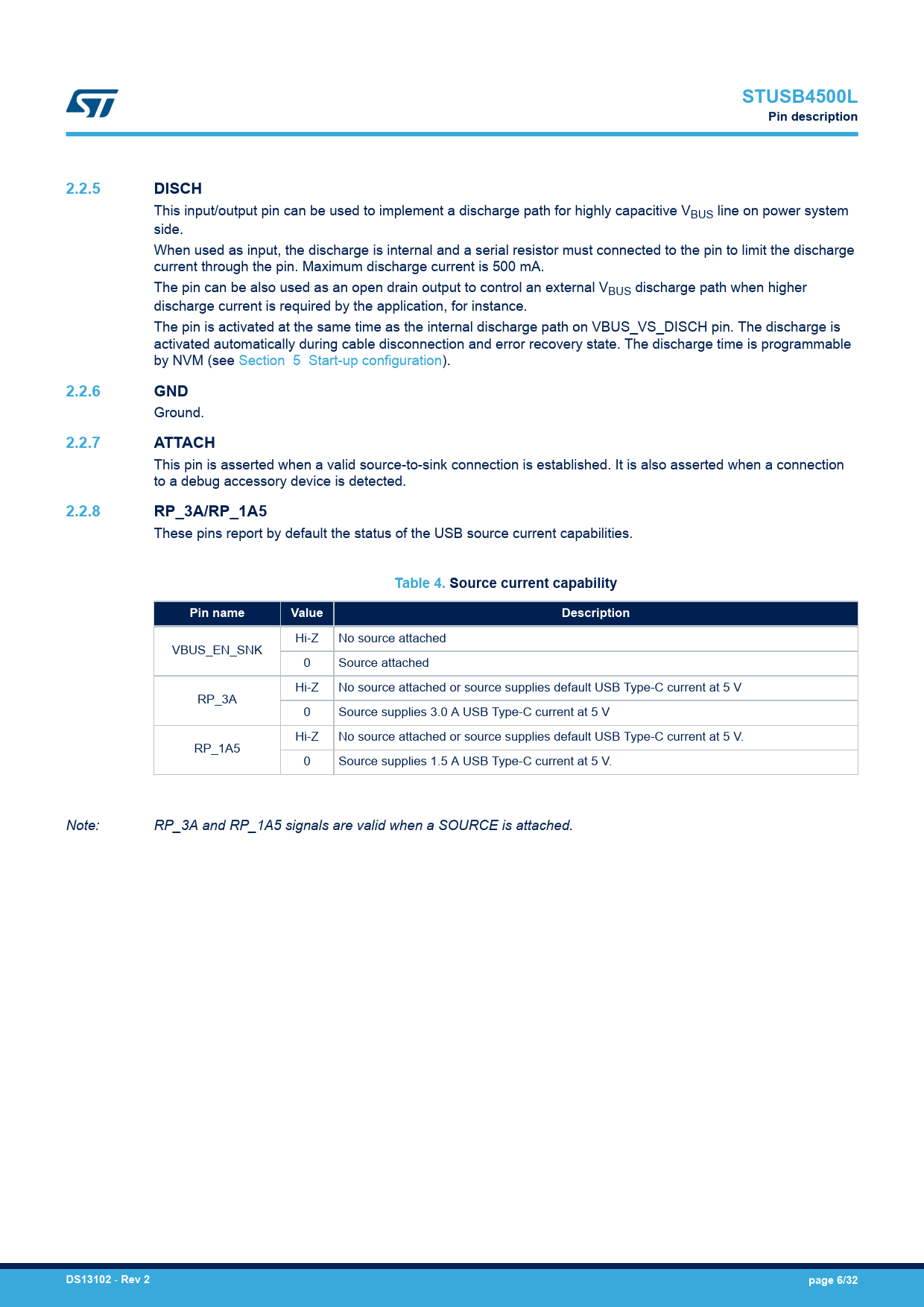

STUSB4500L Pin description 2.2.5 DISCH
This input/output pin can be used to implement a discharge path for highly capacitive VBUS line on power system side. When used as input, the discharge is internal and a serial resistor must connected to the pin to limit the discharge current through the pin. Maximum discharge current is 500 mA. The pin can be also used as an open drain output to control an external VBUS discharge path when higher discharge current is required by the application, for instance. The pin is activated at the same time as the internal discharge path on VBUS_VS_DISCH pin. The discharge is activated automatically during cable disconnection and error recovery state. The discharge time is programmable by NVM (see Section 5 Start-up configuration).
2.2.6 GND
Ground.
2.2.7 ATTACH
This pin is asserted when a valid source-to-sink connection is established. It is also asserted when a connection to a debug accessory device is detected.
2.2.8 RP_3A/RP_1A5
These pins report by default the status of the USB source current capabilities.
Table 4. Source current capability Pin name Value Description
Hi-Z No source attached VBUS_EN_SNK 0 Source attached Hi-Z No source attached or source supplies default USB Type-C current at 5 V RP_3A 0 Source supplies 3.0 A USB Type-C current at 5 V Hi-Z No source attached or source supplies default USB Type-C current at 5 V. RP_1A5 0 Source supplies 1.5 A USB Type-C current at 5 V. Note: RP_3A and RP_1A5 signals are valid when a SOURCE is attached.
