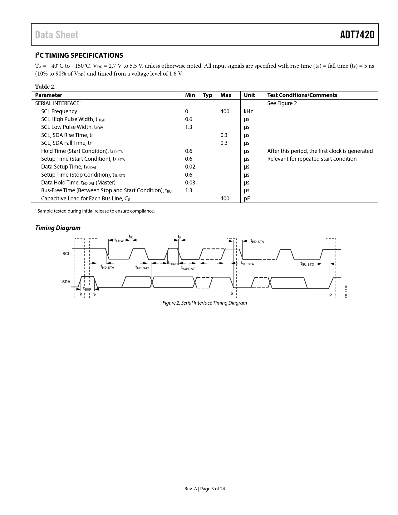

Data Sheet. ADT7420. I2C TIMING SPECIFICATIONS. Table 2. Parameter. Min. Typ. Max Unit Test. Conditions/Comments. Timing Diagram. LOW
Data Sheet ADT7420 I2C TIMING SPECIFICATIONS Table 2 Parameter Min Typ Max Unit Test Conditions/Comments Timing Diagram LOW
link to page 5
TA = −40°C to +150°C, VDD = 2.7 V to 5.5 V, unless otherwise noted. All input signals are specified with rise time (tR) = fall time (tF) = 5 ns (10% to 90% of VDD) and timed from a voltage level of 1.6 V.
Table 2. Parameter Min Typ Max Unit Test Conditions/Comments
SERIAL INTERFACE 1 See Figure 2 6F6F SCL Frequency 0 400 kHz SCL High Pulse Width, tHIGH 0.6 μs SCL Low Pulse Width, tLOW 1.3 μs SCL, SDA Rise Time, tR 0.3 μs SCL, SDA Fall Time, tF 0.3 μs Hold Time (Start Condition), tHD:STA 0.6 μs After this period, the first clock is generated Setup Time (Start Condition), tSU:STA 0.6 μs Relevant for repeated start condition Data Setup Time, tSU:DAT 0.02 μs Setup Time (Stop Condition), tSU:STO 0.6 μs Data Hold Time, tHD:DAT (Master) 0.03 μs Bus-Free Time (Between Stop and Start Condition), tBUF 1.3 μs Capacitive Load for Each Bus Line, CB 400 pF 1 Sample tested during initial release to ensure compliance.
Timing Diagram t t R tF LOW tHD:STA SCL tHIGH t t t SU:STA SU:STO HD:STA tHD:DAT tSU:DAT SDA t
