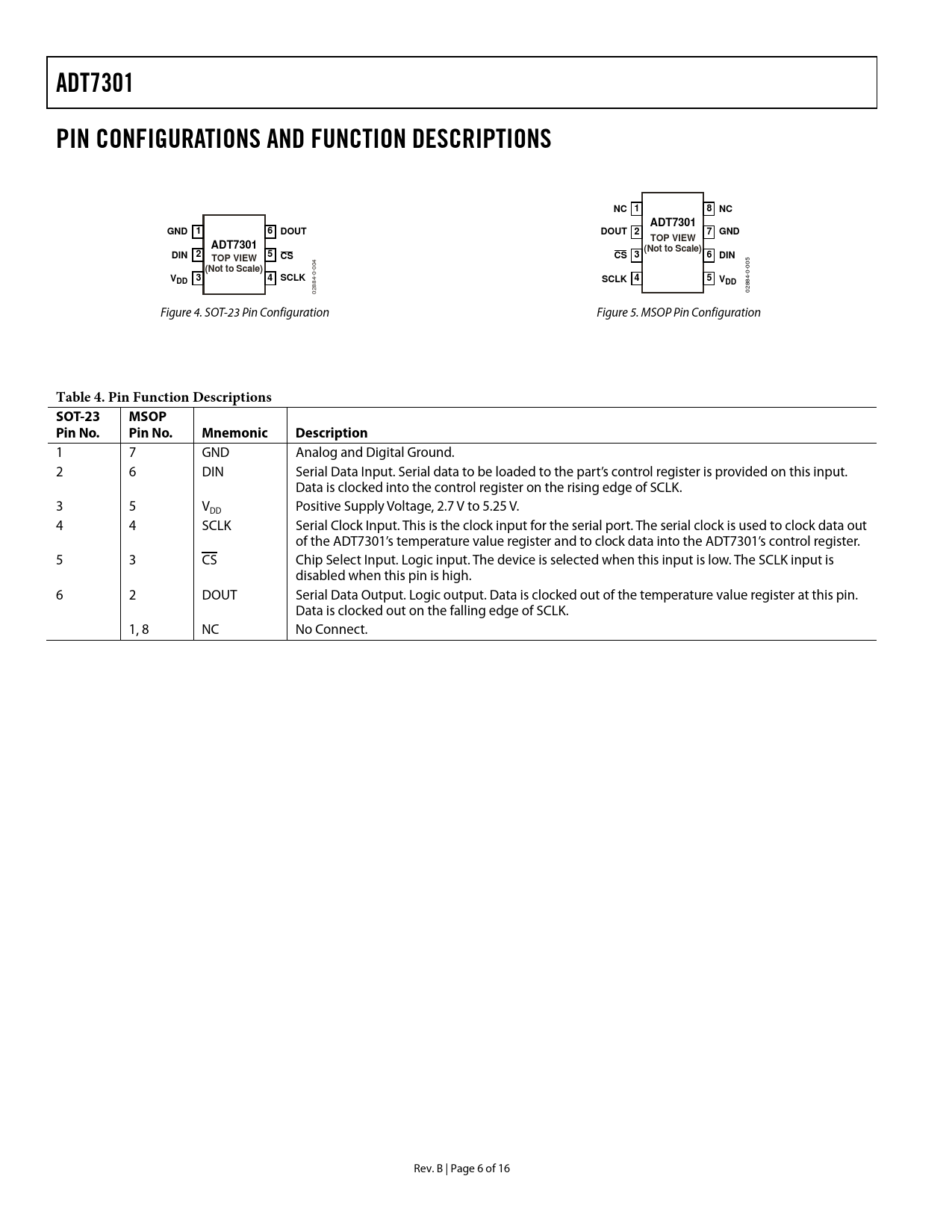

ADT7301. PIN CONFIGURATIONS AND FUNCTION DESCRIPTIONS. NC 1. 8 NC. GND 1. 6 DOUT. DOUT 2. 7 GND. TOP VIEW. (Not to Scale). DIN 2. CS 3. 6 DIN
ADT7301 PIN CONFIGURATIONS AND FUNCTION DESCRIPTIONS NC 1 8 NC GND 1 6 DOUT DOUT 2 7 GND TOP VIEW (Not to Scale) DIN 2 CS 3 6 DIN
ADT7301 PIN CONFIGURATIONS AND FUNCTION DESCRIPTIONS NC 1 8 NC ADT7301 GND 1 6 DOUT DOUT 2 7 GND TOP VIEW ADT7301 (Not to Scale) DIN 2 5 TOP VIEW CS CS 3 6 DIN (Not to Scale) V 3 4 DD SCLK SCLK 4 5 VDD
02884-0-004 02884-0-005 Figure 4. SOT-23 Pin Configuration Figure 5. MSOP Pin Configuration
Table 4. Pin Function Descriptions SOT-23 MSOP Pin No. Pin No. Mnemonic Description
1 7 GND Analog and Digital Ground. 2 6 DIN Serial Data Input. Serial data to be loaded to the part’s control register is provided on this input. Data is clocked into the control register on the rising edge of SCLK. 3 5 V Positive Supply Voltage, 2.7 V to 5.25 V. DD 4 4 SCLK Serial Clock Input. This is the clock input for the serial port. The serial clock is used to clock data out of the ADT7301’s temperature value register and to clock data into the ADT7301’s control register. 5 3 CS Chip Select Input. Logic input. The device is selected when this input is low. The SCLK input is disabled when this pin is high. 6 2 DOUT Serial Data Output. Logic output. Data is clocked out of the temperature value register at this pin. Data is clocked out on the falling edge of SCLK. 1, 8 NC No Connect. Rev. B | Page 6 of 16 Document Outline Features Applications Functional Block Diagram General Description Product Highlights Revision History Specifications Timing Characteristics Absolute Maximum Ratings ESD Caution Pin Configurations and Function Descriptions Typical Performance Characteristics Theory of Operation Converter Details Temperature Value Register Temperature Conversion Equations Serial Interface Read Operation Write Operation Applications Information Microprocessor Interfacing ADT7301-to-MC68HC11 Interface ADT7301-to-8051 Interface ADT7301-to-PIC16C6x/7x Interface ADT7301-to-ADSP-21xx Interface Mounting the ADT7301 Supply Decoupling Outline Dimensions Ordering Guide
