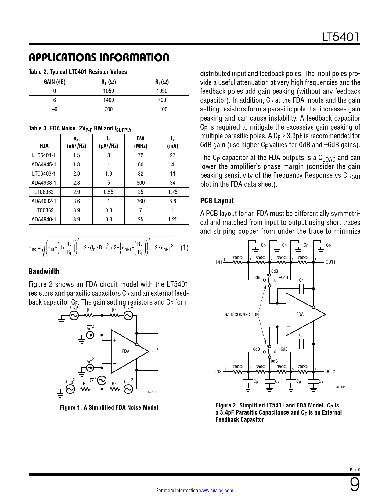

APPLICATIONS INFORMATION Table 2. Typical LT5401 Resistor Values. GAIN (dB). RF (Ω). RI (Ω). Table 3. FDA Noise, 2V
APPLICATIONS INFORMATION Table 2 Typical LT5401 Resistor Values GAIN (dB) RF (Ω) RI (Ω) Table 3 FDA Noise, 2V
link to page 9 LT5401
distributed input and feedback poles. The input poles pro-
vide a useful attenuation at very high frequencies and the 0 1050 1050 feedback poles add gain peaking (without any feedback 6 1400 700 capacitor). In addition, CP at the FDA inputs and the gain –6 700 1400 setting resistors form a parasitic pole that increases gain peaking and can cause instability. A feedback capacitor
C
P-P BW and ISUPPLY
F is required to mitigate the excessive gain peaking of
e
multiple parasitic poles. A C
ni In BW Is
F ≥ 3.3pF is recommended for
FDA (nV/√Hz) (pA/√Hz) (MHz) (mA)
6dB gain (use higher CF values for 0dB and –6dB gains). LTC6404-1 1.5 3 72 27 The CP capacitor at the FDA outputs is a CLOAD and can ADA4945-1 1.8 1 60 4 lower the amplifier’s phase margin (consider the gain LTC6403-1 2.8 1.8 32 11 peaking sensitivity of the Frequency Response vs CLOAD ADA4938-1 2.8 5 800 34 plot in the FDA data sheet). LTC6363 2.9 0.55 35 1.75 ADA4932-1 3.6 1 360 8.8
PCB Layout
LTC6362 3.9 0.8 7 1 A PCB layout for an FDA must be differentially symmetri- ADA4940-1 3.9 0.8 25 1.25 cal and matched from input to output using short traces and striping copper from under the trace to minimize ⎛ 2 2 ⎛ R ⎞⎞ ⎛ ⎛R ⎞⎞ e F F 2 CP CP CP CP no = ⎜eni • ⎜1+ ⎟⎟ + 2 • I ( n •RF )2 +2 •⎜enRI •⎜ ⎟⎟ +2 • enRF (1) ⎝ ⎝ R ⎝ ⎝ R I ⎠⎠ I ⎠⎠ 700Ω 350Ω 350Ω 700Ω IN1 1 5 4 3 2 OUT1
Bandwidth
0dB 6dB –6dB Figure 2 shows an FDA circuit model with the LT5401 CF resistors and parasitic capacitors CP and an external feed- back capacitor CF. The gain setting resistors and CP form + R enRF2 enRI2 I RF GAIN CONNECTION FDA in+2 – C + F FDA e 6dB –6dB no2 in–2 – 0dB 700Ω 350Ω 350Ω 700Ω IN2 10 6 7 8 9 OUT2 e R ni2 enRF2 enRI2 CP CP CP C I RF P 5401 F02 5401 F01
Figure 1. A Simplified FDA Noise Model Figure 2. Simplified LT5401 and FDA Model. CP is a 3.4pF Parasitic Capacitance and CF is an External Feedback Capacitor
