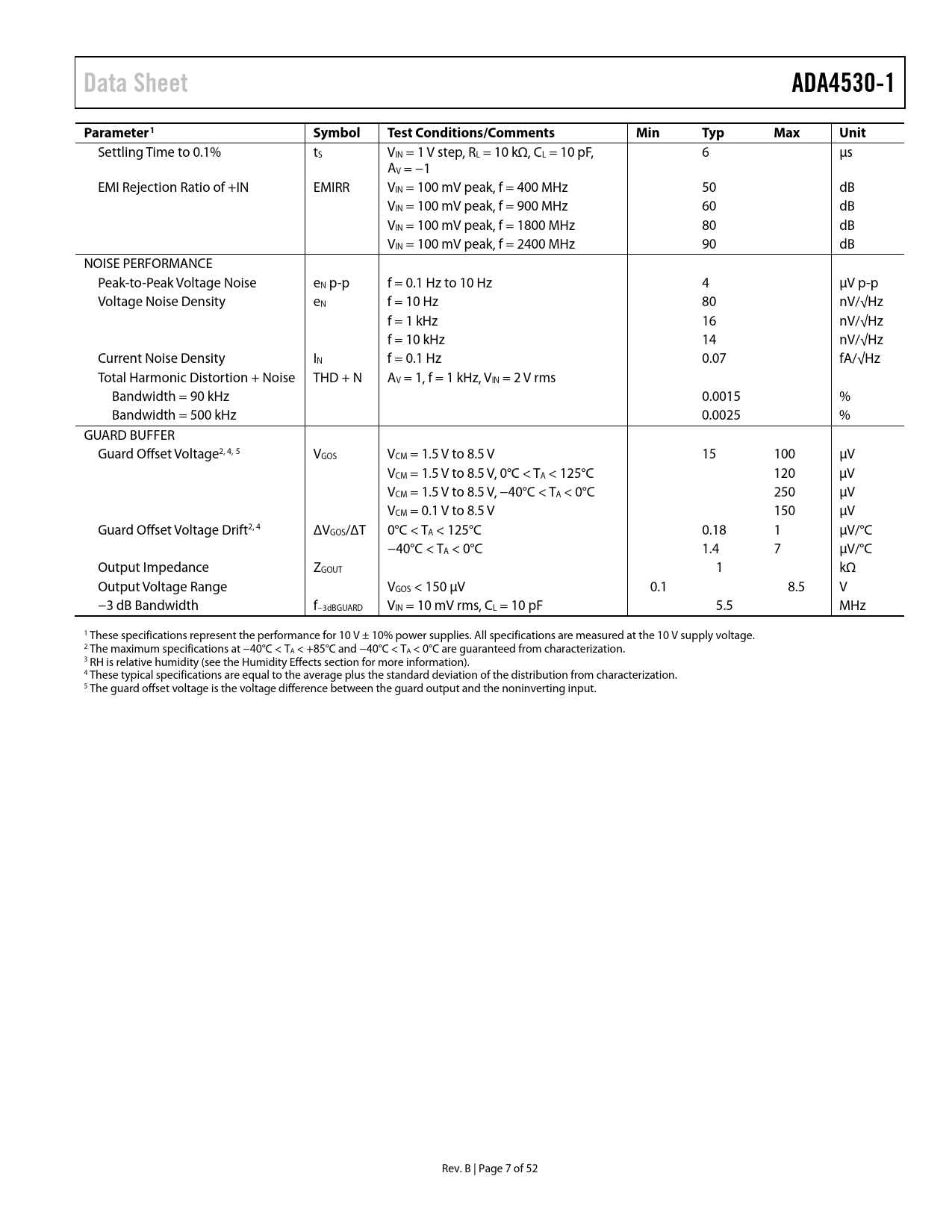

Data Sheet. ADA4530-1. Parameter1. Symbol. Test Conditions/Comments. Min. Typ. Max. Unit
Data Sheet ADA4530-1 Parameter1 Symbol Test Conditions/Comments Min Typ Max Unit
link to page 37
Settling Time to 0.1% tS VIN = 1 V step, RL = 10 kΩ, CL = 10 pF, 6 µs AV = −1 EMI Rejection Ratio of +IN EMIRR VIN = 100 mV peak, f = 400 MHz 50 dB VIN = 100 mV peak, f = 900 MHz 60 dB VIN = 100 mV peak, f = 1800 MHz 80 dB VIN = 100 mV peak, f = 2400 MHz 90 dB NOISE PERFORMANCE Peak-to-Peak Voltage Noise eN p-p f = 0.1 Hz to 10 Hz 4 µV p-p Voltage Noise Density eN f = 10 Hz 80 nV/√Hz f = 1 kHz 16 nV/√Hz f = 10 kHz 14 nV/√Hz Current Noise Density IN f = 0.1 Hz 0.07 fA/√Hz Total Harmonic Distortion + Noise THD + N AV = 1, f = 1 kHz, VIN = 2 V rms Bandwidth = 90 kHz 0.0015 % Bandwidth = 500 kHz 0.0025 % GUARD BUFFER Guard Offset Voltage2, 4, 5 VGOS VCM = 1.5 V to 8.5 V 15 100 µV VCM = 1.5 V to 8.5 V, 0°C < TA < 125°C 120 µV VCM = 1.5 V to 8.5 V, −40°C < TA < 0°C 250 µV VCM = 0.1 V to 8.5 V 150 µV Guard Offset Voltage Drift2, 4 ΔVGOS/ΔT 0°C < TA < 125°C 0.18 1 µV/°C −40°C < TA < 0°C 1.4 7 µV/°C Output Impedance ZGOUT 1 kΩ Output Voltage Range VGOS < 150 µV 0.1 8.5 V −3 dB Bandwidth f−3dBGUARD VIN = 10 mV rms, CL = 10 pF 5.5 MHz 1 These specifications represent the performance for 10 V ± 10% power supplies. All specifications are measured at the 10 V supply voltage. 2 The maximum specifications at −40°C < TA < +85°C and −40°C < TA < 0°C are guaranteed from characterization. 3 RH is relative humidity (see the Humidity Effects section for more information). 4 These typical specifications are equal to the average plus the standard deviation of the distribution from characterization. 5 The guard offset voltage is the voltage difference between the guard output and the noninverting input. Rev. B | Page 7 of 52 Document Outline FEATURES APPLICATIONS PIN CONNECTION DIAGRAM GENERAL DESCRIPTION TABLE OF CONTENTS REVISION HISTORY SPECIFICATIONS 5 V NOMINAL ELECTRICAL CHARACTERISTICS 10 V NOMINAL ELECTRICAL CHARACTERISTICS 15 V NOMINAL ELECTRICAL CHARACTERISTICS ABSOLUTE MAXIMUM RATINGS THERMAL RESISTANCE ESD CAUTION PIN CONFIGURATION AND FUNCTION DESCRIPTIONS TYPICAL PERFORMANCE CHARACTERISTICS MAIN AMPLIFIER, DC PERFORMANCE MAIN AMPLIFIER, AC PERFORMANCE GUARD AMPLIFIER THEORY OF OPERATION ESD STRUCTURE INPUT STAGE GAIN STAGE OUTPUT STAGE GUARD BUFFER APPLICATIONS INFORMATION INPUT PROTECTION SINGLE-SUPPLY AND RAIL-TO-RAIL OUTPUT CAPACITIVE LOAD STABILITY EMI REJECTION RATIO HIGH IMPEDANCE MEASUREMENTS INPUT BIAS CURRENT INPUT RESISTANCE INPUT OFFSET VOLTAGE INSULATION RESISTANCE GUARDING DIELECTRIC RELAXATION HUMIDITY EFFECTS CONTAMINATION CLEANING AND HANDLING SOLDER PASTE SELECTION CURRENT NOISE CONSIDERATIONS LAYOUT GUIDELINES PHYSICAL IMPLEMENTATION OF GUARDING TECHNIQUES GUARD RING GUARD PLANE VIA FENCE CABLES AND CONNECTORS ELECTROSTATIC INTERFERANCE PHOTODIODE INTERFACE DC ERROR ANALYSIS AC ERROR ANALYSIS NOISE ANALYSIS DESIGN RECOMMENDATIONS DESIGN EXAMPLE POWER SUPPLY RECOMMENDATIONS POWER SUPPLY CONSIDERATIONS LONG-TERM DRIFT TEMPERATURE HYSTERESIS OUTLINE DIMENSIONS ORDERING GUIDE
