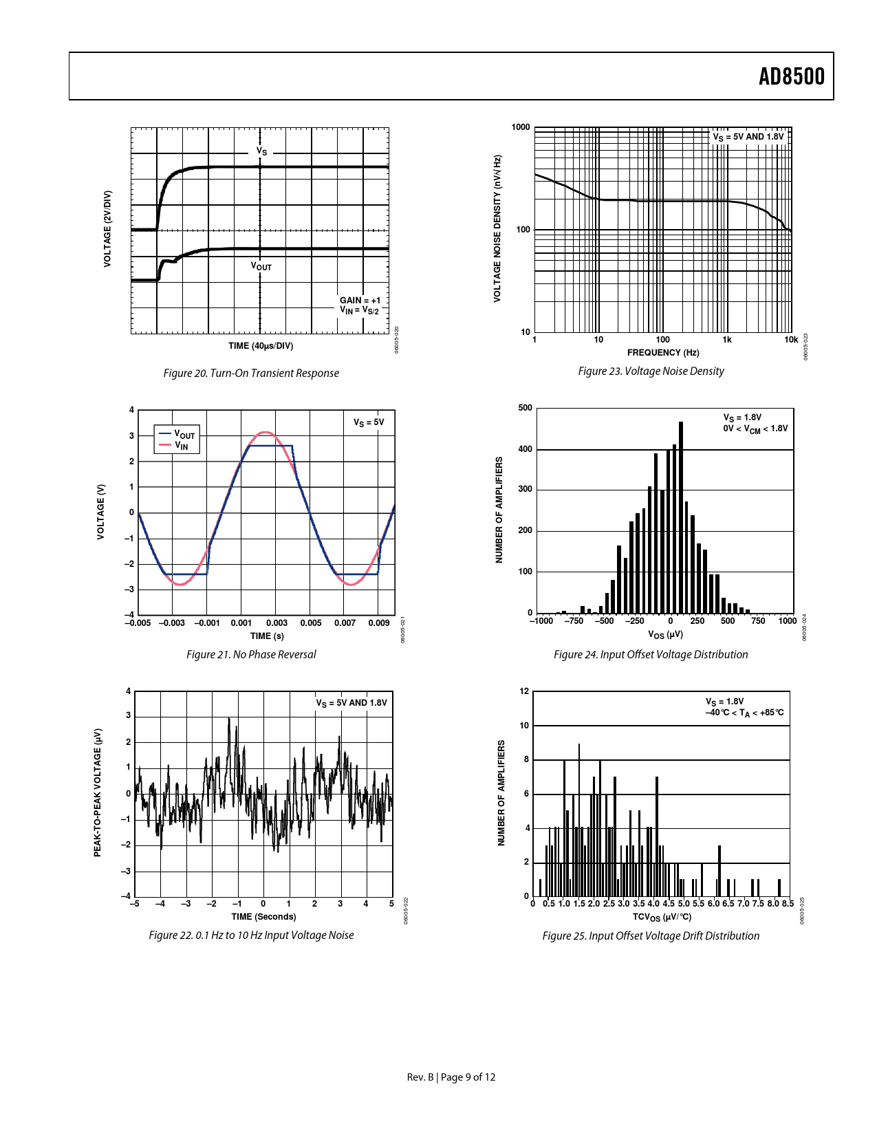

AD8500. 1000. VS = 5V AND 1.8V. ) z H V/ n Y (. IV). V/ 2. E (. 100. G A. ISE. T L. E N. OUT. G A T L. GAIN = +1. VIN = VS/2. 10k. TIME (40µs/DIV)

00 06 Figure 20. Turn-On Transient Response Figure 23. Voltage Noise Density

06 06 Figure 21. No Phase Reversal Figure 24. Input Offset Voltage Distribution

06 06 Figure 22. 0.1 Hz to 10 Hz Input Voltage Noise Figure 25. Input Offset Voltage Drift Distribution Rev. B | Page 9 of 12 Document Outline FEATURES APPLICATIONS PIN CONFIGURATION GENERAL DESCRIPTION TABLE OF CONTENTS REVISION HISTORY SPECIFICATIONS ABSOLUTE MAXIMUM RATINGS THERMAL RESISTANCE ESD CAUTION TYPICAL PERFORMANCE CHARACTERISTICS OUTLINE DIMENSIONS ORDERING GUIDE
