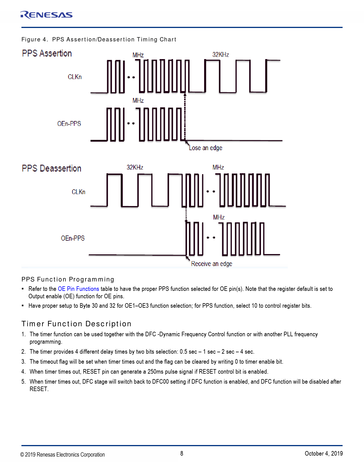

Figure 4. PPS Assertion/Deassertion Timing Chart PPS Function Programming
▪ Refer to the OE Pin Functions table to have the proper PPS function selected for OE pin(s). Note that the register default is set to Output enable (OE) function for OE pins. ▪ Have proper setup to Byte 30 and 32 for OE1–OE3 function selection; for PPS function, select 10 to control register bits.
