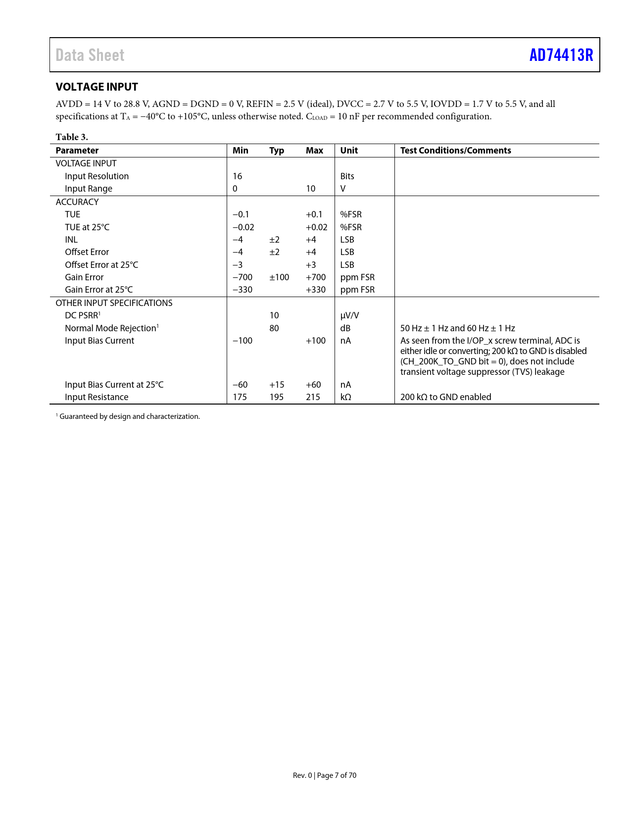

Data Sheet AD74413R VOLTAGE INPUT
AVDD = 14 V to 28.8 V, AGND = DGND = 0 V, REFIN = 2.5 V (ideal), DVCC = 2.7 V to 5.5 V, IOVDD = 1.7 V to 5.5 V, and all specifications at TA = −40°C to +105°C, unless otherwise noted. CLOAD = 10 nF per recommended configuration.
Table 3. Parameter Min Typ Max Unit Test Conditions/Comments
VOLTAGE INPUT Input Resolution 16 Bits Input Range 0 10 V ACCURACY TUE −0.1 +0.1 %FSR TUE at 25°C −0.02 +0.02 %FSR INL −4 ±2 +4 LSB Offset Error −4 ±2 +4 LSB Offset Error at 25°C −3 +3 LSB Gain Error −700 ±100 +700 ppm FSR Gain Error at 25°C −330 +330 ppm FSR OTHER INPUT SPECIFICATIONS DC PSRR1 10 μV/V Normal Mode Rejection1 80 dB 50 Hz ± 1 Hz and 60 Hz ± 1 Hz Input Bias Current −100 +100 nA As seen from the I/OP_x screw terminal, ADC is either idle or converting; 200 kΩ to GND is disabled (CH_200K_TO_GND bit = 0), does not include transient voltage suppressor (TVS) leakage Input Bias Current at 25°C −60 +15 +60 nA Input Resistance 175 195 215 kΩ 200 kΩ to GND enabled 1 Guaranteed by design and characterization. Rev. 0 | Page 7 of 70 Document Outline Features Applications General Description Companion Products Product Highlights Revision History Functional Block Diagram Specifications Voltage Output Current Output Voltage Input Current Input Externally Powered and Current Input Externally Powered with HART Current Input Loop Powered Resistance Measurement Digital Input Logic Digital Input Loop Powered ADC Specifications General Specifications Timing Characteristics SPI Timing Specifications Timing Diagrams Absolute Maximum Ratings Thermal Resistance ESD Caution Pin Configuration and Function Descriptions Typical Performance Characteristics Voltage Output Current Output Digital Input Resistance Measurement Reference ADC Supplies Theory of Operation Robust Architecture Serial Interface DAC Architecture ADC Overview Reference Reference Noise Charge Pump Power-On State of the AD74413R Device Functions High Impedance Interpreting ADC Data Voltage Output Mode Voltage Output Short-Circuit Protection Interpreting ADC Data Current Output Mode Current Output Open Circuit Detection Interpreting ADC Data HART Compatibility Voltage Input Mode Selectable 200 kΩ to GND Interpreting ADC Data Thermocouple Measurement Current Input, Externally Powered Mode Short-Circuit Protection Interpreting ADC Data Current Input, Externally Powered with HART Compatibility Mode Current Input, Loop Powered Mode Short-Circuit Protection Interpreting ADC Data Current Input, Loop Powered with HART Compatibility Mode Resistance Measurement (External 2-Wire RTD) Interpreting ADC Data Digital Input Logic Interpreting ADC Data Digital Input Threshold Setting Digital Input Current Sink Debounce Function Debounce Mode 0 (Default) Debounce Mode 1 Digital Input Inverter Digital Input Counter Digital Input, Loop Powered Mode Interpreting ADC Data Getting Started Using Channel Functions Switching Channel Functions ADC Functionality ADC Conversion Rates ADC_RDYb Functionality ADC Output Data Format ADC Noise Diagnostics DACs LDAC Function Clear Code Function Digital Linear Slew Rate Control HART Compliant Slew Driving Inductive Loads Reset Function Thermal Alert and Thermal Reset Faults and Alerts Channel Faults Power Supply Monitors GPO_x Pins SPI Interface and Diagnostics SPI CRC SPI Interface SCLK Count Feature Readback Mode Streaming Mode Auto Readback Board Design and Layout Considerations Applications Information Register Map NOP Register Function Setup Register per Channel ADC Configuration Register per Channel Digital Input Configuration Register per Channel GPO Parallel Data Register GPO Configuration Register per Channel Output Configuration Register per Channel DAC Code Register per Channel DAC Clear Code Register per Channel DAC Active Code Register per Channel Digital Input Threshold Register ADC Conversion Control Register Diagnostics Select Register Digital Output Level Register ADC Conversion Results Register per Channel Diagnostic Results Registers per Diagnostic Channel Alert Status Register Live Status Register Alert Mask Register Debounced DIN Count Register per Channel Readback Select Register Thermal Reset Enable Register Command Register Scratch or Spare Register Silicon Revision Register Outline Dimensions Ordering Guide
