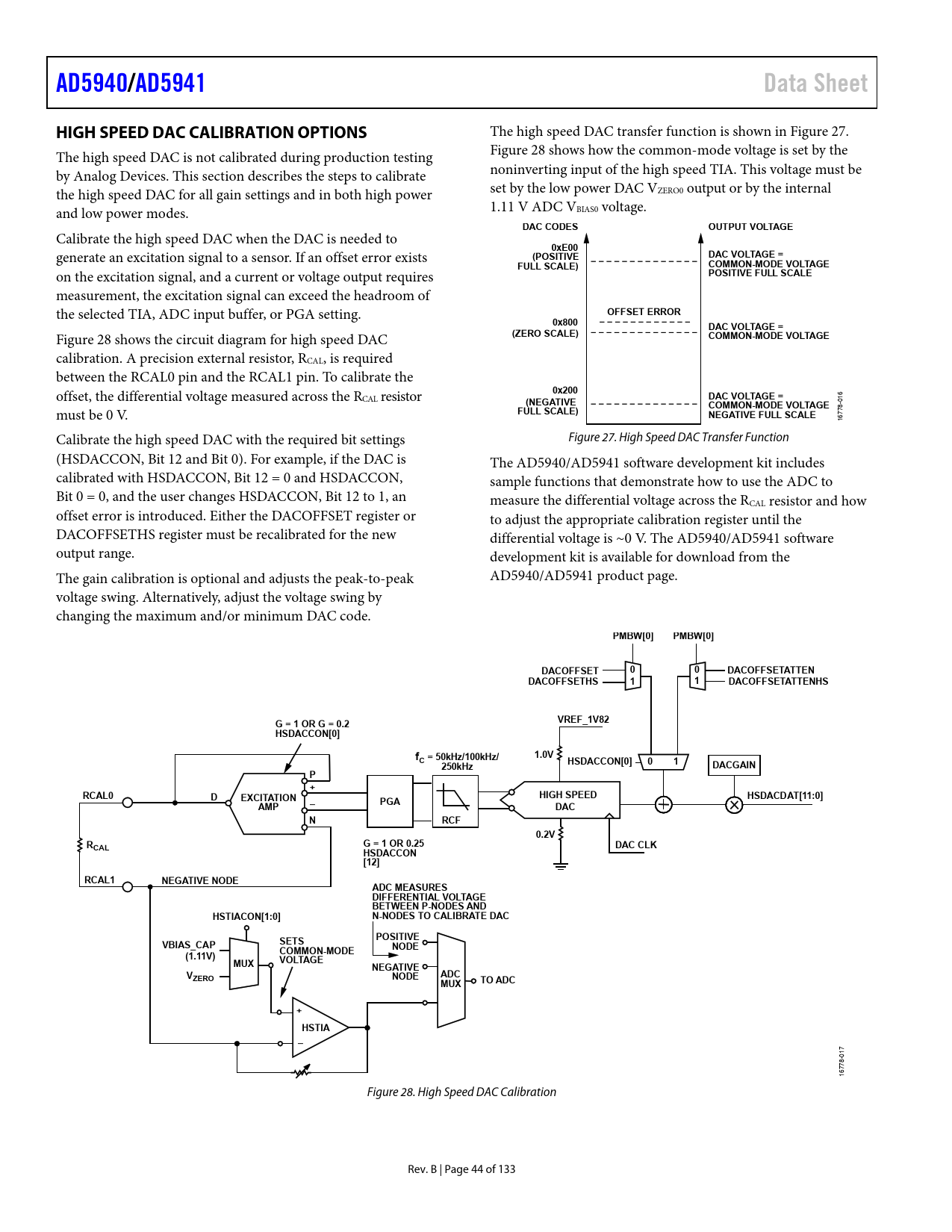

The high speed DAC transfer function is shown in Figure 27. The high speed DAC is not calibrated during production testing Figure 28 shows how the common-mode voltage is set by the by Analog Devices. This section describes the steps to calibrate noninverting input of the high speed TIA. This voltage must be the high speed DAC for all gain settings and in both high power set by the low power DAC VZERO0 output or by the internal and low power modes. 1.11 V ADC VBIAS0 voltage.

Calibrate the high speed DAC when the DAC is needed to
0xE00
generate an excitation signal to a sensor. If an offset error exists
(POSITIVE DAC VOLTAGE = FULL SCALE) COMMON-MODE VOLTAGE
on the excitation signal, and a current or voltage output requires
POSITIVE FULL SCALE
measurement, the excitation signal can exceed the headroom of the selected TIA, ADC input buffer, or PGA setting.
OFFSET ERROR 0x800 DAC VOLTAGE =
Figure 28 shows the circuit diagram for high speed DAC
(ZERO SCALE) COMMON-MODE VOLTAGE
calibration. A precision external resistor, RCAL, is required between the RCAL0 pin and the RCAL1 pin. To calibrate the offset, the differential voltage measured across the R
0x200
CAL resistor
(NEGATIVE DAC VOLTAGE = COMMON-MODE VOLTAGE
016 must be 0 V.
FULL SCALE) NEGATIVE FULL SCALE
16778- Calibrate the high speed DAC with the required bit settings Figure 27. High Speed DAC Transfer Function (HSDACCON, Bit 12 and Bit 0). For example, if the DAC is The AD5940/AD5941 software development kit includes calibrated with HSDACCON, Bit 12 = 0 and HSDACCON, sample functions that demonstrate how to use the ADC to Bit 0 = 0, and the user changes HSDACCON, Bit 12 to 1, an measure the differential voltage across the RCAL resistor and how offset error is introduced. Either the DACOFFSET register or to adjust the appropriate calibration register until the DACOFFSETHS register must be recalibrated for the new differential voltage is ~0 V. The AD5940/AD5941 software output range. development kit is available for download from the The gain calibration is optional and adjusts the peak-to-peak AD5940/AD5941 product page. voltage swing. Alternatively, adjust the voltage swing by changing the maximum and/or minimum DAC code.
